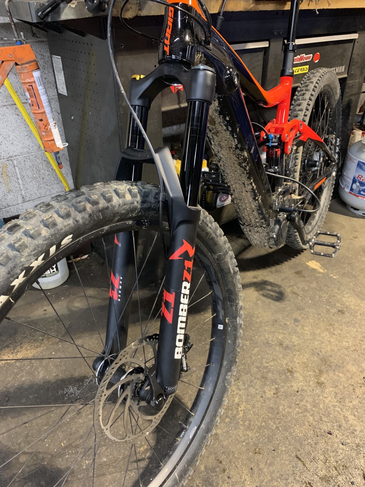

I have a Marzocchi Bomber with 160mm on mine and it’s the best upgrade I think you could do. Made the bike better in every way. And this fork is identical internally to a Fox 36 and cheaper. The extra 10mm makes it much better and dose not affect it in anyway negatively. You could go 170mm I think and would be fine also.

thank you for the reply. Your bike looks very COOL.
I dont disagree but since if i buy it i wotn be able to return it and since the current geometry works perfect for me im really afraid to mess with it and in any case 150mm is more than enough for me.
How sensitive is the Bomber from your experience especially at small bumps at medium speed?
And how easy is it to tune it to your liking?

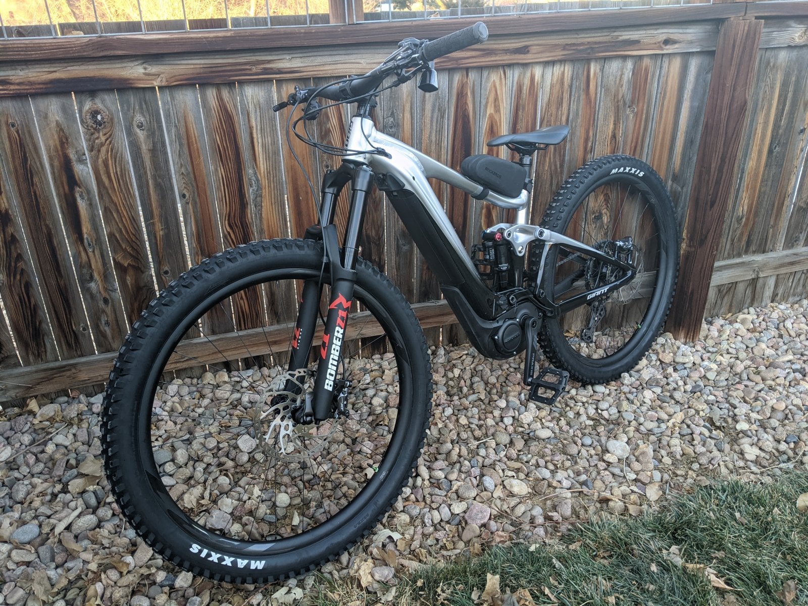

Look at the z1 coil...it is a very nice fork for the price and with the weight of the bike you won't notice the extra weight of the spring. It has thicker stanchions like the ebike fox forks so I think it's a good match for the bike. I believe it only adjusts from 160-180mm but can be easily adjusted with included spacers so no need for new parts. Here is a 160 on mine.

thank you for the reply! What is actually the difference between a coil and an air fork for the average user? is this the E+1 pro btw which had the Fox 36 fork? Why did you change it the Coil Bomber?
Yes it is the +1 which had the air E36. I live in a very rocky area (front range of Colorado) and I did not like how harsh the 36 felt on rocks and braking bumps. The coil is much smoother in the first part of the travel over small bumps and chatter and feels like it finds more traction as it's very reactive and consistent. An air fork is lighter and has a very adjustable spring so one fork can for a light rider or a heavy rider just by pumping it up. Air is also very progressive so it gets firm at the bottom of the travel and resists bottom out. A coil is linear and can bottom out easier if you don't have the correct spring rate installed...I have the heavy green? spring installed and even taking it to the jump park I just turn the knob so the compression is stiff and it still ramps up and doesn't blow through it's stroke. It's a good fork. Here's some good reading The best mountain bike fork 2021 – 9 suspension forks in review | ENDURO Mountainbike Magazine

I’m running mine stock with no air spacers and 65psi. I weigh 175lbs. It is very supple on the small stuff and has good hold up in the jump. I would strongly suggest 160mm the extra lets you run a lower pressure and have the same ride height. If you go to a trail with big jumps you can run 75 psi and it is awesome for that as well.

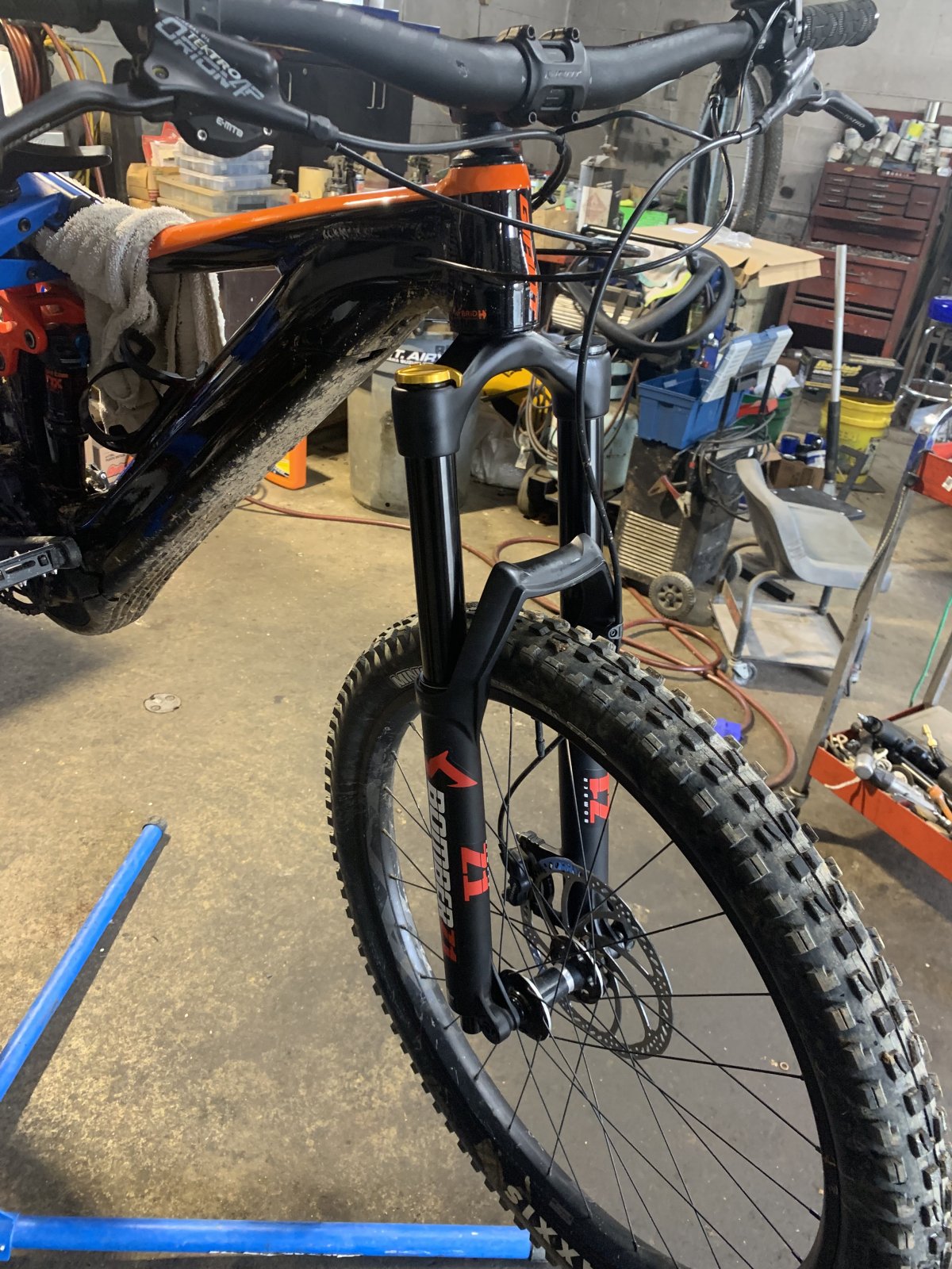

Im on the 170mm Bomber front & 140mm rear. Love it! Super buttery off the top of the stroke.
