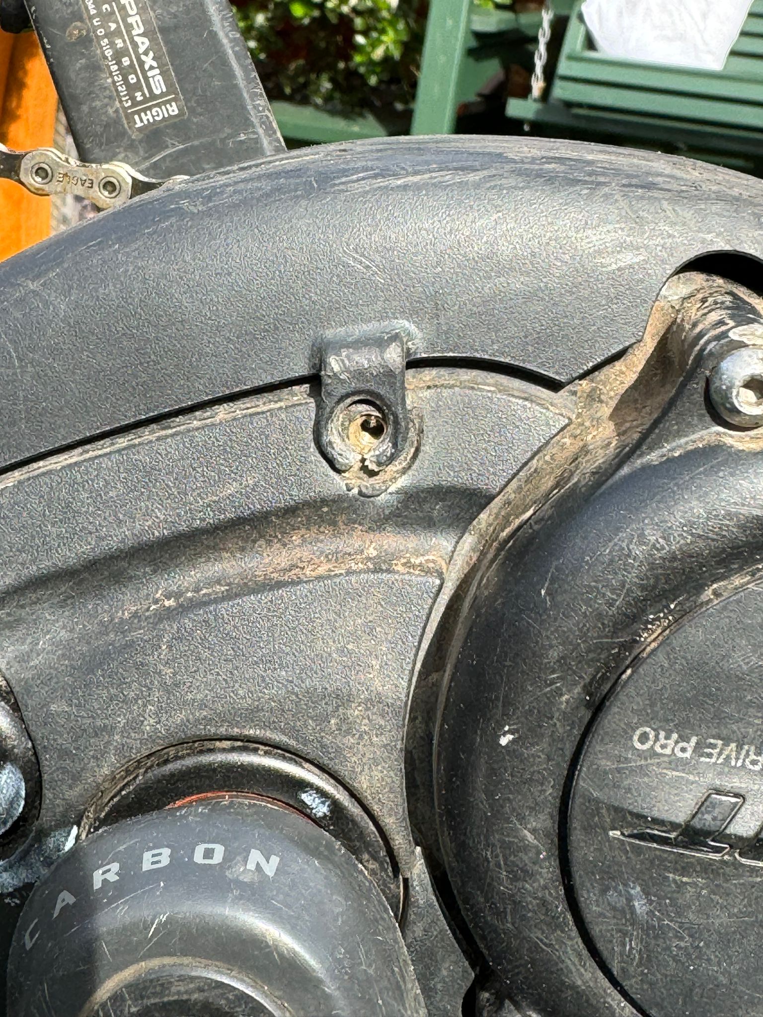

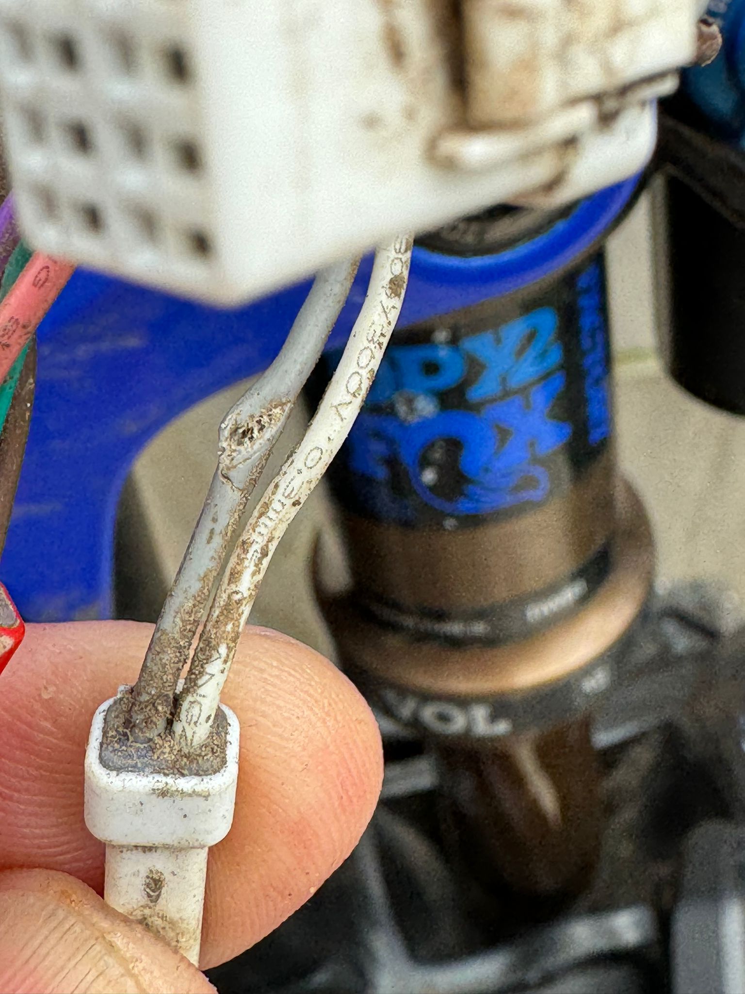

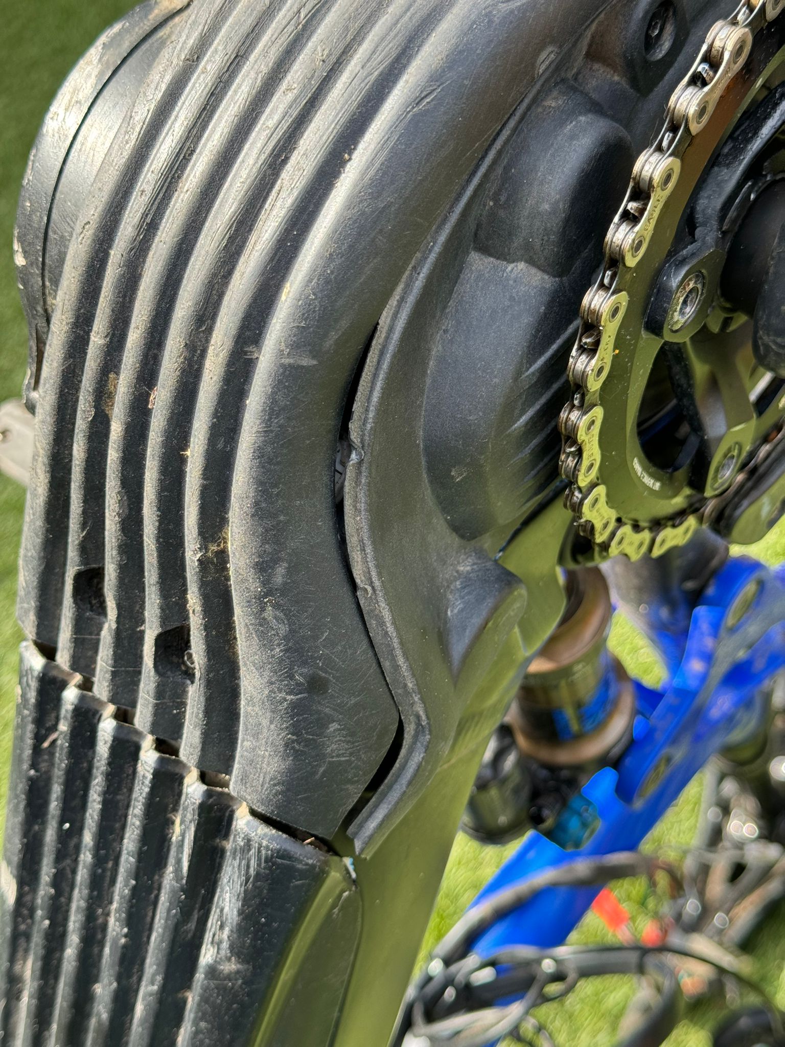

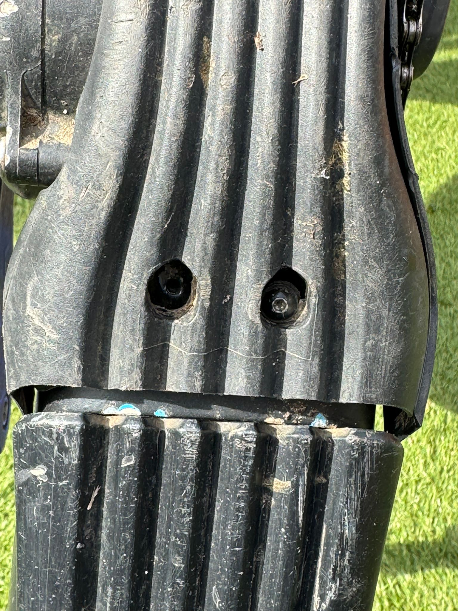

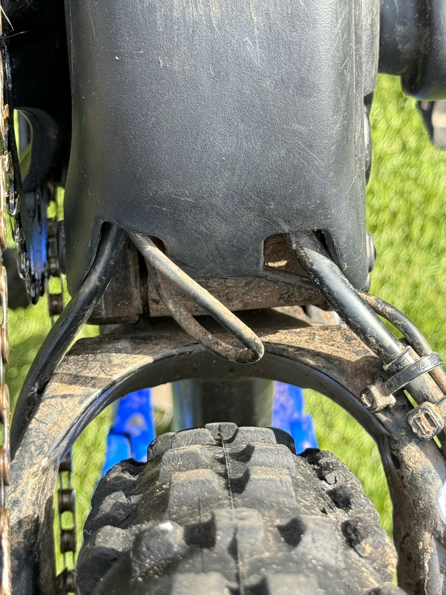

The bike came back from Giant in London Twickenham, they gave me back the old wiring and it looks like only one cable was the problem :(
The bike is working fine but , ..... check the photos below and see how it came back from the service
It doesn't look first rate, that's for sure. :(
But why did you send a mucky bike off for a service? It can't set the mechanic's mind up well when starting off with a bike that he has to clean before he makes a start. :unsure:
