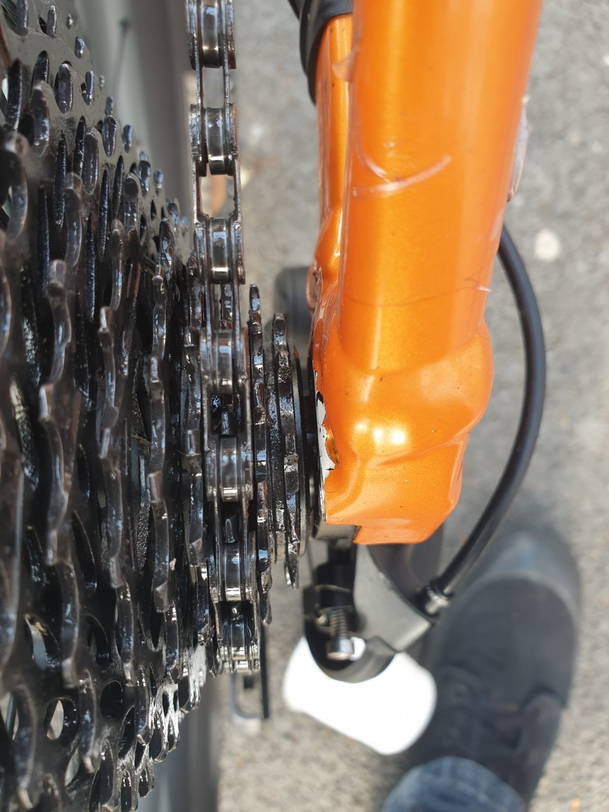

Quick update on my Trance E+1 pro freehub issue.
I collected the bike from Giant Lincoln last friday, with a new freehub and Ride Control One controller fitted.
All good on sunday morning until I dropped down the gears into the 11 tooth ring only to discover that the 11 tooth ring has been istalled on a slight angle and so the cap that holds the cassette on is now cross threaded and at an angle! I've spoken to the store and will have to drop it in again to get it sorted!
Not a happy camper by any means.
Also I found that there is now play in the front wheel bearings, after only 6 months! Not good.
The ride control seems to be working ok now as does the freehub, for now!
I'll keep you all posted.

Hope you get sorted mate its crap having to take your bike back all the time isn't it . Yea them control units are plagued with problems think they are on a mk 4 model now.
