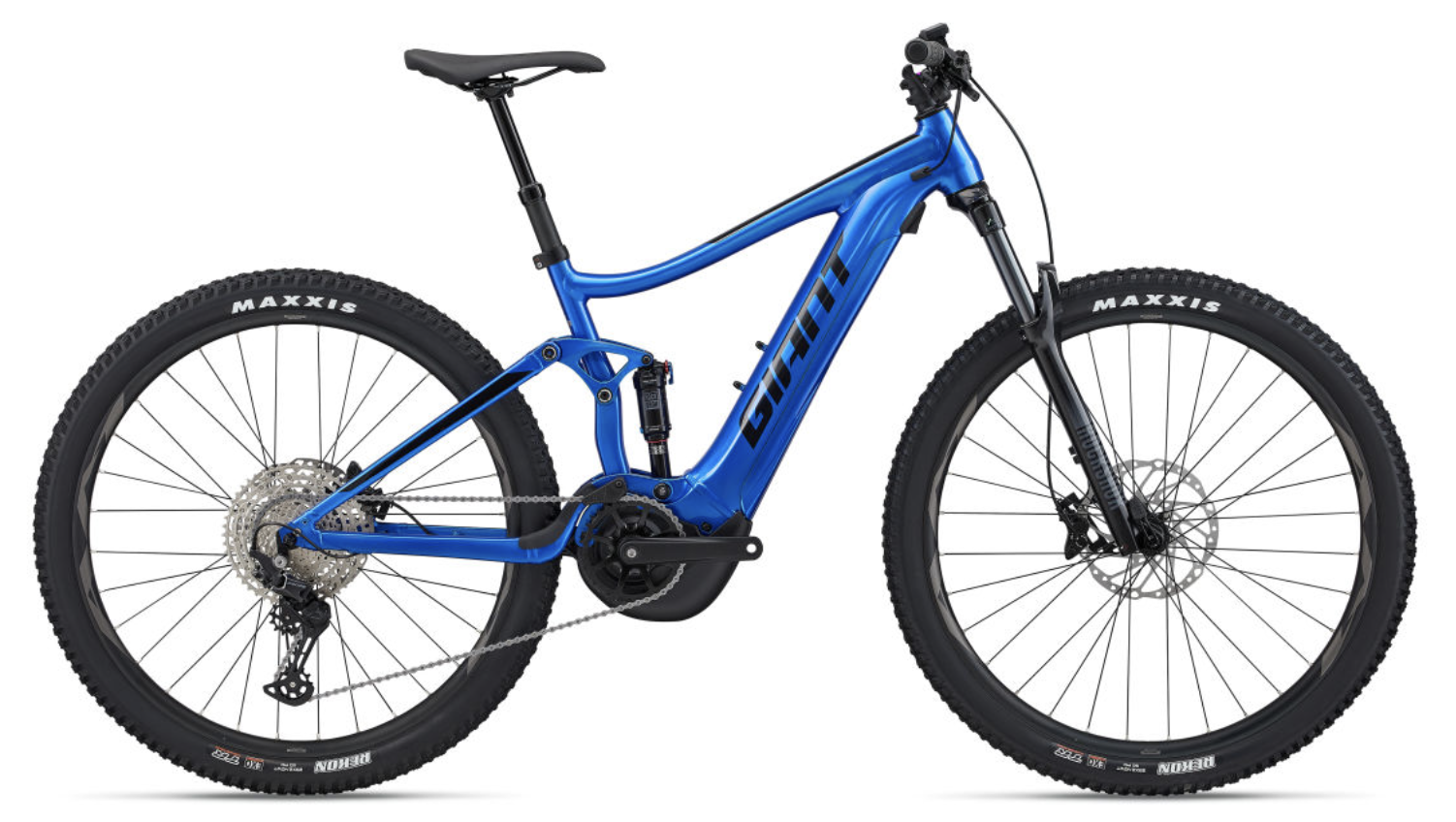

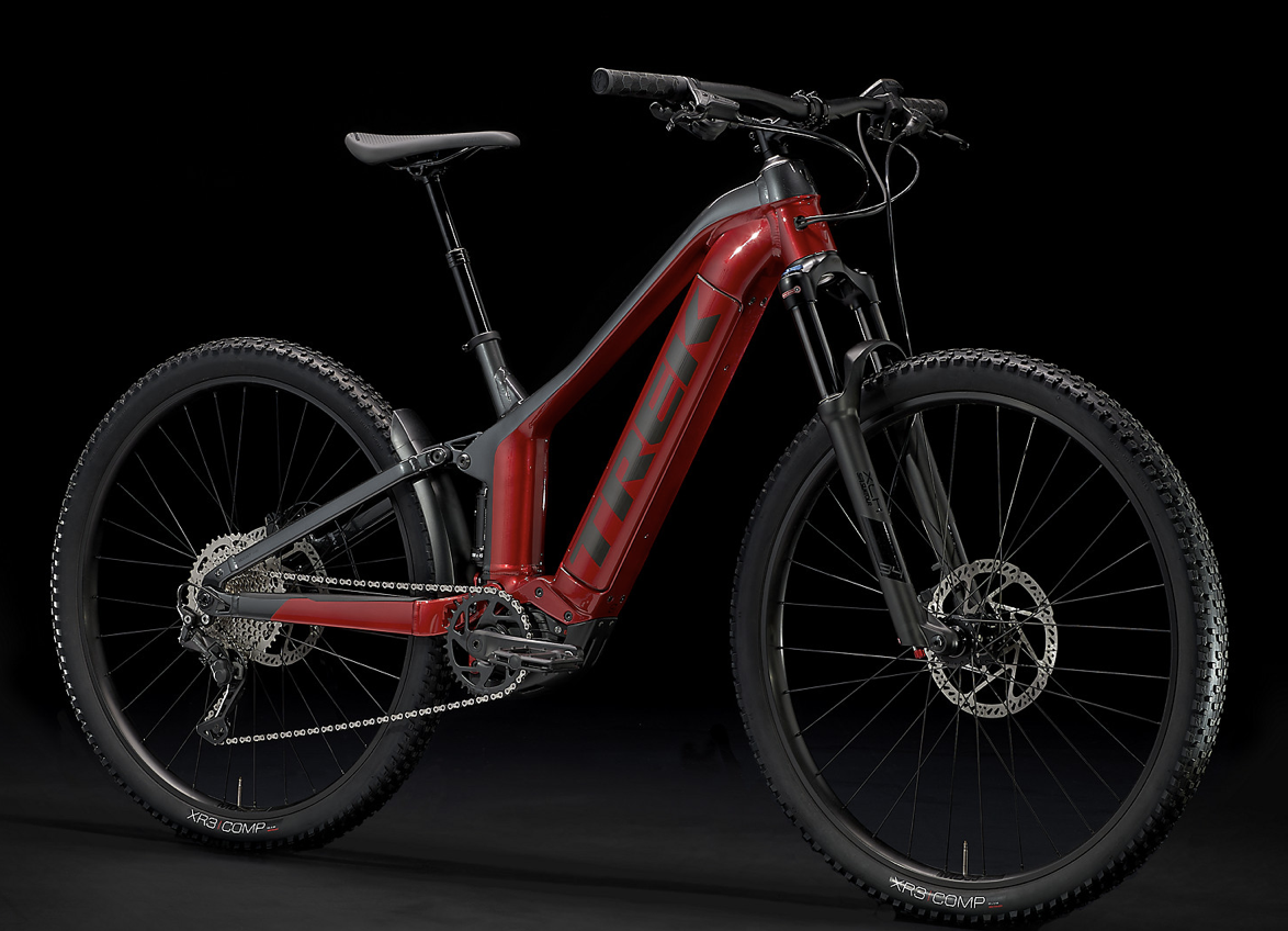

I have narrowed down my search to the Giant Stance E+1 or the Trek Powerfly FS4 and was looking for advice between the two. I plan on riding mostly paved bike paths, dirt fire roads and very light single track And I’m approx. 250 lbs. These two bikes seem pretty close in specs with the exception of the Bosch 85nm motor versus the yamaha SyncDrive sport which produces 70nm. I got to spend sometime on the Giant but have never ridden the trek. The local Trek dealer doesn’t have any in stock and said for me to order one and if I didn’t like it they would give me a full refund. Any input would be appreciated

No answers yet! I owned a 2021 Giant Explorer E+2 GTS (hard tail). Great bike. well made but I found the Yamaha motor to be overly rattly especially in the automatic ETMB mode or what ever they call that mode. Then I upgraded to a 2022 Trek Powerfly FS9 Equipped mostly because it was the FS model and had all upgraded components along with an 85 Nm motor and a 625 watt battery, but of course with a greater price tag $6,700 (with tax).
I would first assess which local bike store is closet to you and has the best reputation (local bike shops are far from equal when it comes to service after the sale).
Asthetic wise Giant make some nice looking frames, but one thing I don't like is how on some models (the Stance) their motor hangs way down and to me, looks like a pregnant Guppy when compared to the Powerfly. Trek also makes stunning looking ebikes with great paint and decals. I feel Trek has better customer service and a better warranty. I don't think a Giant's warranty (at least in the U.S.) is transferable to another owner incase you decide to sell it early (I bought 3 ebikes over a 3 months period and sold 2).
So the comparsion of the two models you asked about are pretty much very similar in price, features, specs and performance.
This is why I personally would put more weight on local bike shop convenience and then asthetics of the two ebikes.
I think that Trek's Powerfly FS4 model in their Crimson/Lithium Grey color scheme is a knock out!
