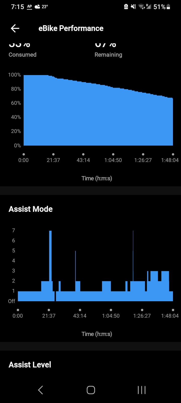

Read my post on range . If you want range and climbabilty improvement change chane ring to 36 t to 32 tooth. Look at the garmin edge 830 ride today fo for the first 20 minute s the battery % dies not change on a full charge. The next ride on a partially chaged battery does not have this buffer. It will decline a lot faster.
I can get really good range by tuning the e o power levels down really low.
