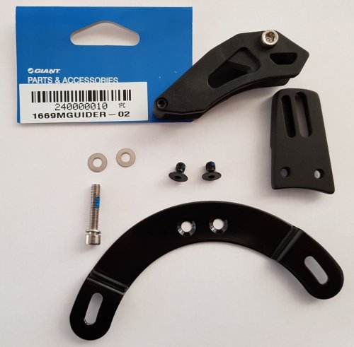

As a follow up, does anyone know what chain guide will fit on my bike?
13,993
20,742
I suppose ultimately a derailleur with a clutch, thought of in it's most simplified way, is a derailleur with considerably more tension and a way to release that tension so you can work on the drivetrain.... so maybe :)
Giant seem to sell a number of own brand chain guides for less than €20, so they should be able to fit the appropriate one of those :
for example :
Keep in mind though that if it's coming off at the bottom of the chainring first, it still might pop off, but it should pop back on when you pedal and at least not be sucked down behind the chainring.

My 2019 Fathom E+ 3 came with a chain guide. I wonder why some variants didn't come with them. I can say that would certainly help. I haven't dropped a chain yet.
