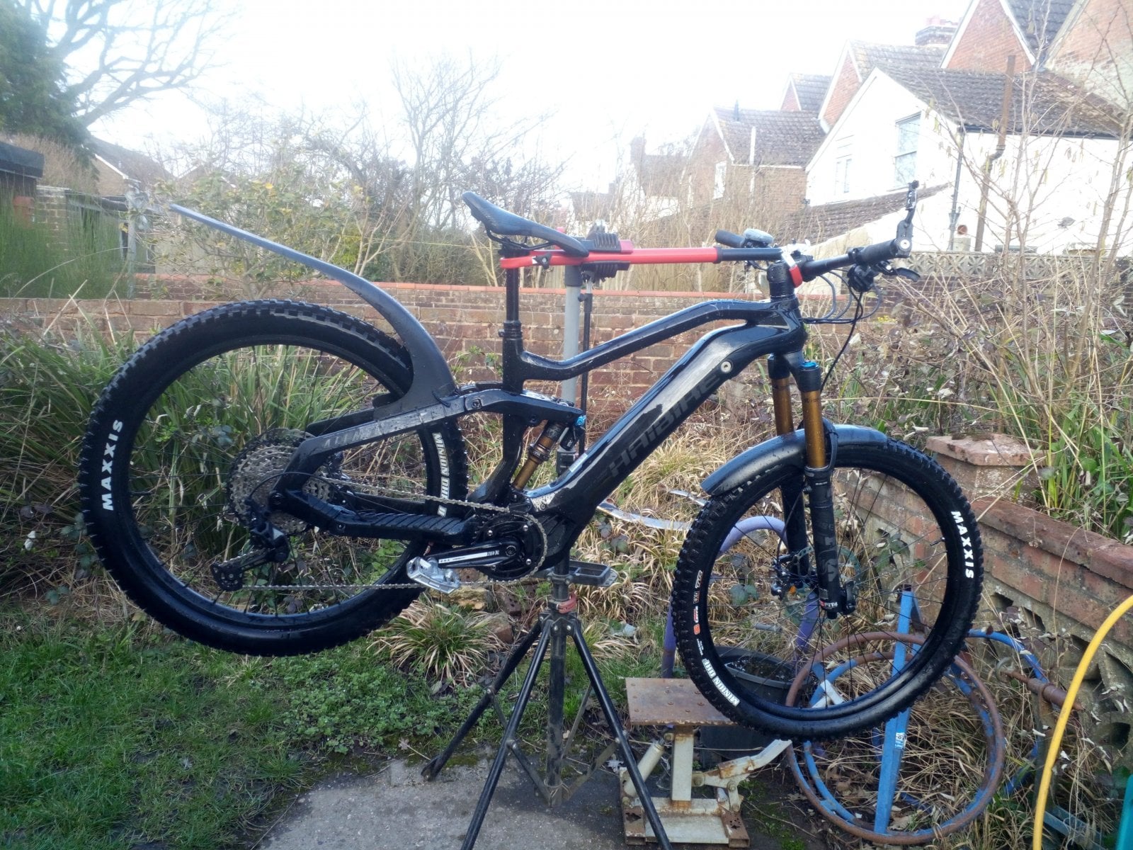

New to e- mountain biking, bought a fulfat and a half fat for the miss. Recently bought a park tool 9.2 base model to do basic maintenance. My back is a sensitive thing so I tested a few methods to get the bike up without sacrificing my back. Thought I would share;
Bought a foldable single step 45cm high plastic ladder/bench for the process....
1: For right handed riders, stand on the right of the bike with the stand on the left (center but 2 feet away).
2: Place the bench on the left side of the front wheel.
3: Hold the back brake and from the handlebar push bike back to lift front wheel on ladder.
4: Switch right hand to front brake, bend your knees grab the rear with left hand low and lift rear of bike by using your knees.
5: Once the bike is horizontal pivot the bike (resting on the front wheel on the bench) to fit post (or frame) in pre-opened clamp and rest on bottom of seat. ( the first time you will need to pre-define hight of work stand, then mark it)
6: Maintaining the bike with the left hand let go of the front brake and use your right hand to secure the clamp.
7: Remove the ladder and use as bench to work on the bike.
8: When finished, replace the bench under front wheel and reverse the steps to lower the bike.

One hand under saddle, one under top tube. Lift bike into stand. Release bike. Do up clamp.

@Pan - your Park tools stand is telescopic.
With the stand at it's lowest height you should be able to clamp your bike's (raised) seatpost with the bike still on the ground.
Leaving the lever to the rear of the clamp open so the clamp can rotate freely you should then be able to raise the telescopic arm by lifting just the rear wheel off the ground, (use a foot on the leg of the stand if needs be to stop the stand lifting off the ground as you lift the wheel) and raised it to a suitable height and tighten the telescopic arm clamp with your other hand. The bike should now be clamped securely in the stand with rear wheel off the ground and front still on the ground.
Next simply rotate the bike level and clamp the rotational adjustment lever closed.
et voila...

i leave the top clamp loose so that it can rotate on the stand. Put the bike into the wheely position then roll it across to the stand, grip the bike in the bike clamp, then lift front wheel and tighten rotation clamp. Raise bike on stand. That way I alway have hand free to operate the clamps, and don’t need to lift bike with one hand.

I use the Halfords stand with fake crossbar, and lift the bike onto the stand in its lowest position. Then one foot on the stand and up it goes.

After all those, if you still couldn't lift it on, can't you use leverage.
You'd need more space.
Just lean the stand over towards the bike so it's only on two legs.
The more you lean it, the lower it will be.
Connect to the bike.
Push the bike and the stand top away and up so it pivots on the front two stand feet and viola, it should settle back onto 4 feet and the bike will be off the ground.
