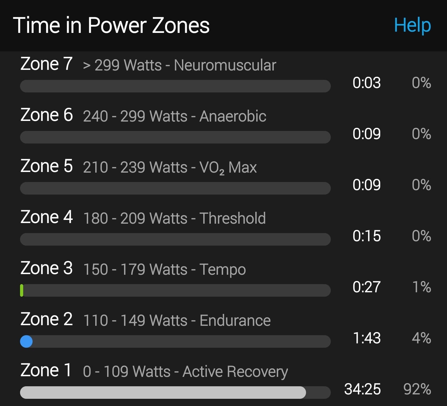

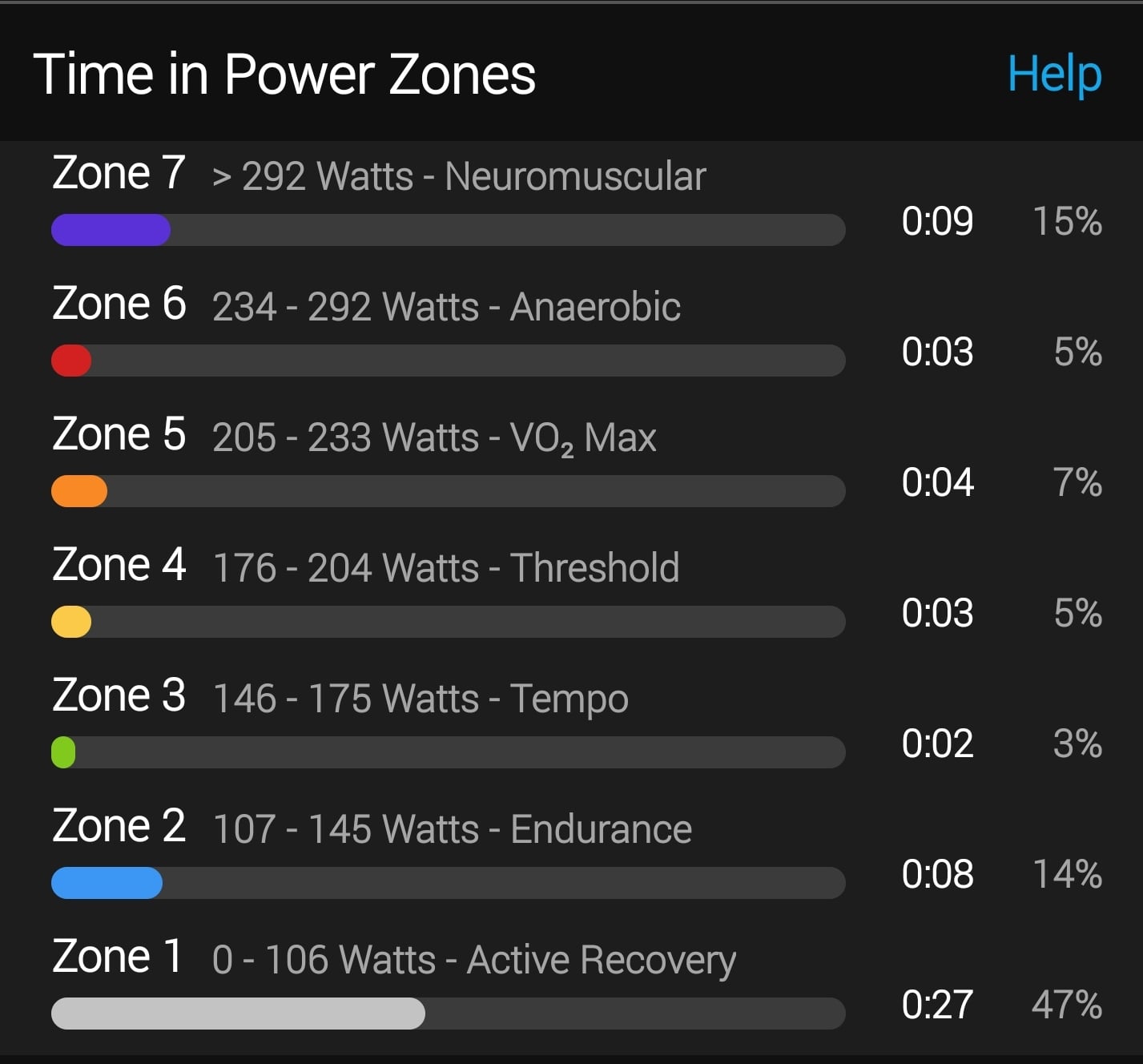

Today, I was able to connect the Garmin to a used Levo SL, that was on consignment at my local Giant dealer. The power sensor data is much more realistic from the Spec.
This was a short cruise across a parking-lot on the Specialized SL.
This is from my Trance X e+, on fairly tough route. Clearly its bunk.
This is something to consider, when considering the value of a new purchase. I was able to impress this on my Giant dealer today. Perhaps if enough of us Giant users push, Giant will fix it.
