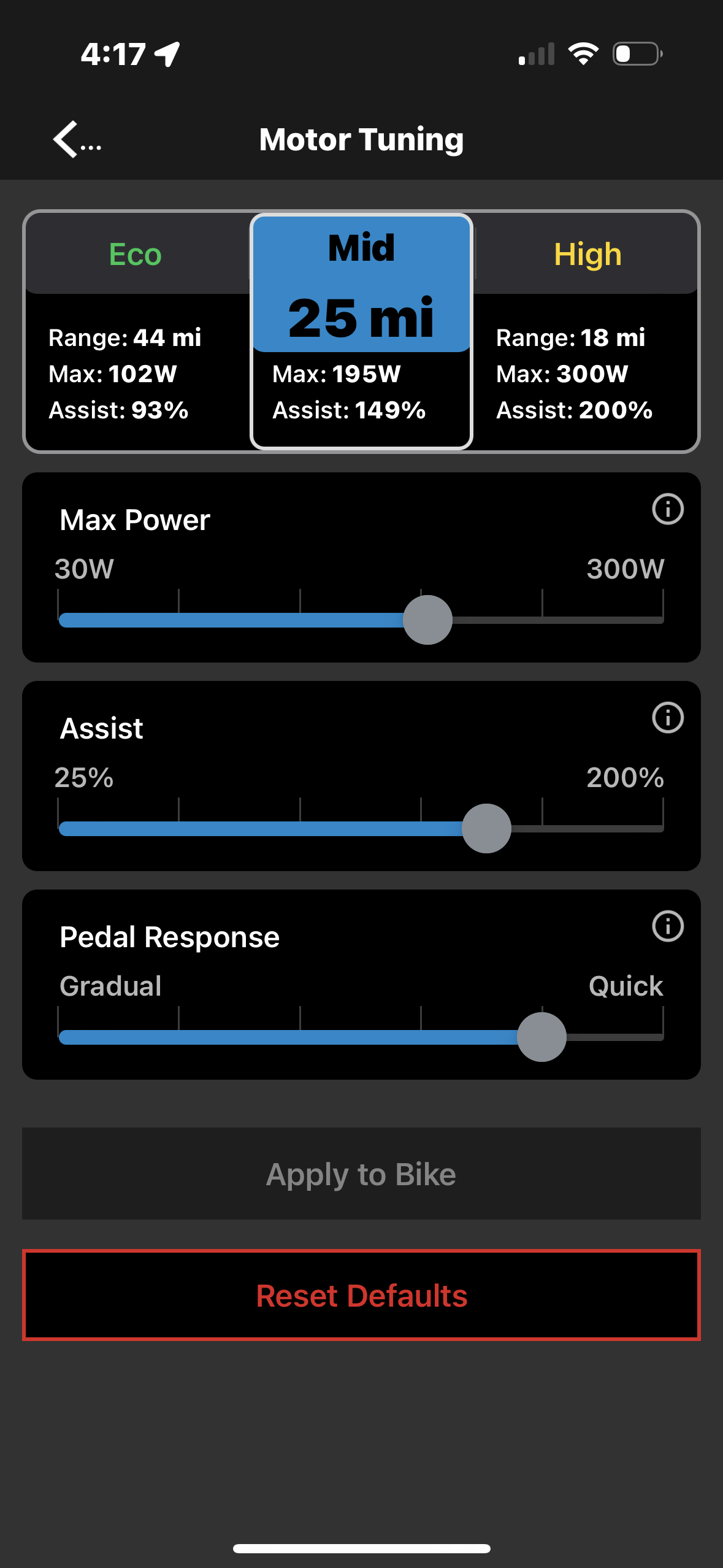

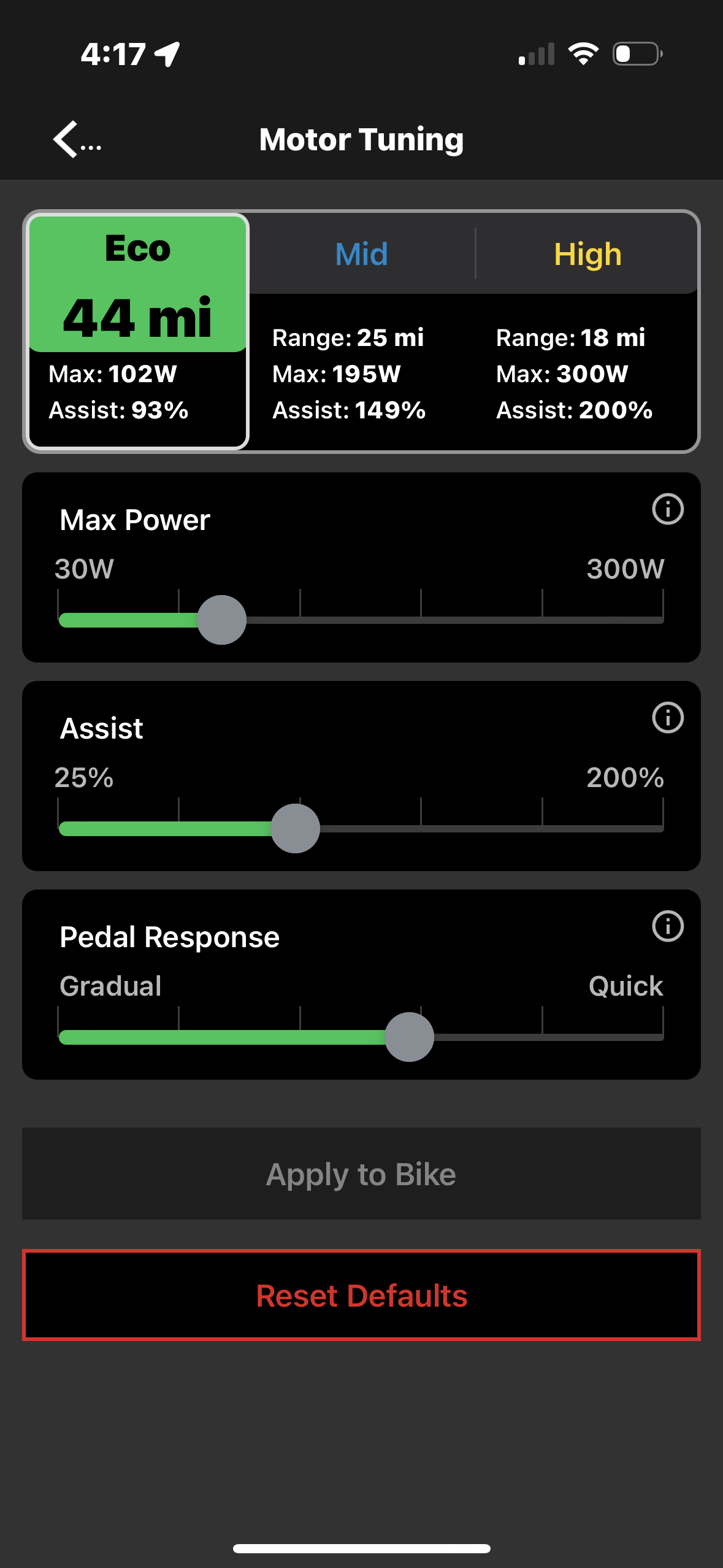

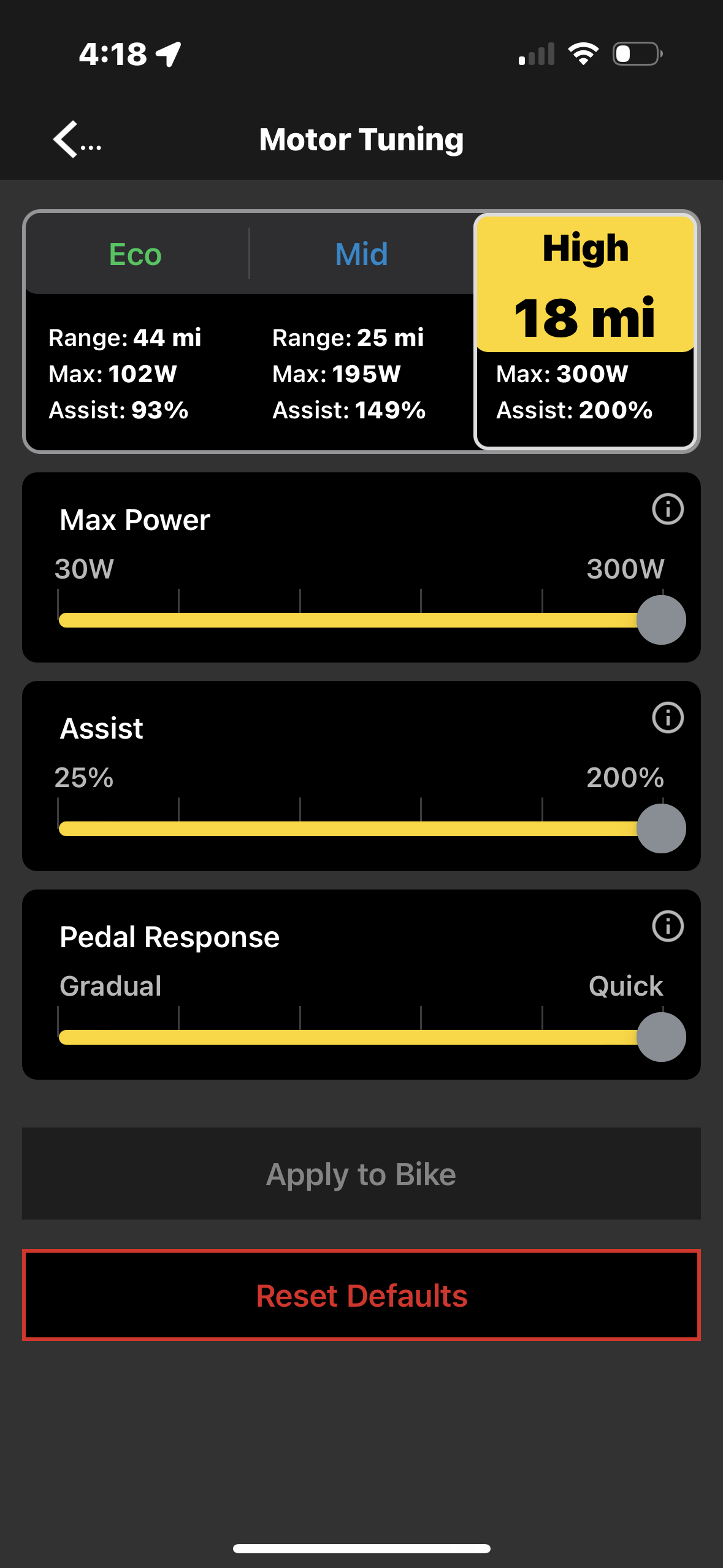

Apparently my bike was just set at the default settings. It must have reverted back when I did the firmware update. Here are some pics of the settings I normally ride with:
D82CE72F-DE1B-4BA5-94D0-05A7AD7C0F64.png A7764397-A696-48A4-A32E-3F1B69D7552A.png 77341328-FFB1-4D38-B690-A3256C9550BB.png
