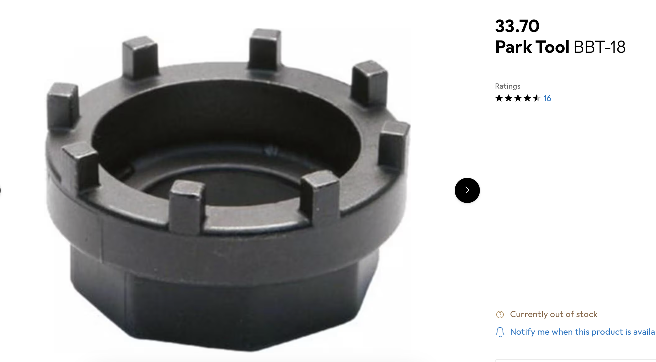

Any guidance for removing the original chainring? First EMTB and having a bear of a time getting the lock ring off. Do I have to remove the spindle from the hub?
I bought the bottom bracket tool (don't know which one off top of my head) and used a 3/8" ratchet connected to that to remove the lock ring. I'd YouTube to find a how to
EDIT:
OK the tools I bought were Park Tool BBT-18 for the lock ring removal
Also the Park Tool TWB-36 so I could use my Park Tool torque wrench on the BBT-18 - bit of a pain the BBT-18 doesn't have a 3/8" interface but hey it is what it is

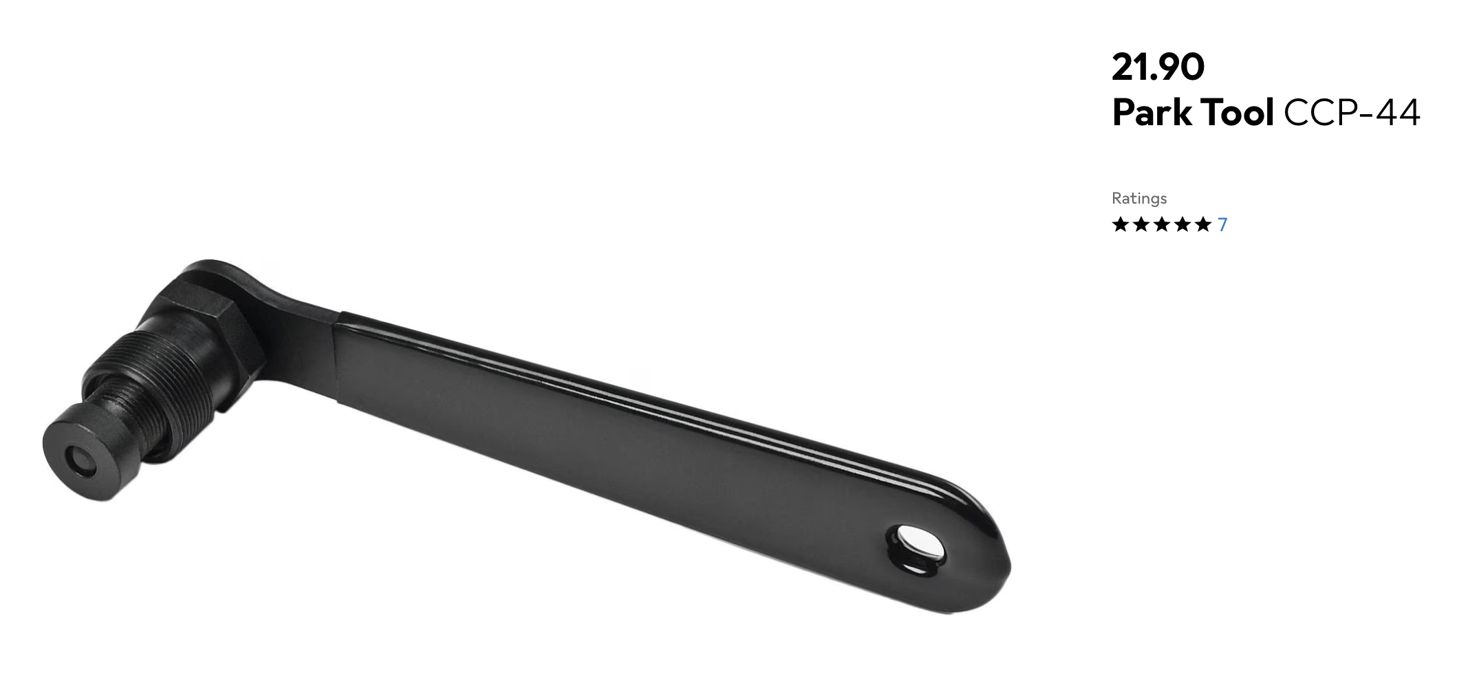

Oh and a crank puller to get the cranks off, I just bought the Park Tool one again
Assuming you have a torque wrench for the correct Nm (mine is yep you guessed it Park Tool ahahah and 3/8" interface to match the above claw) then you should be good to go
