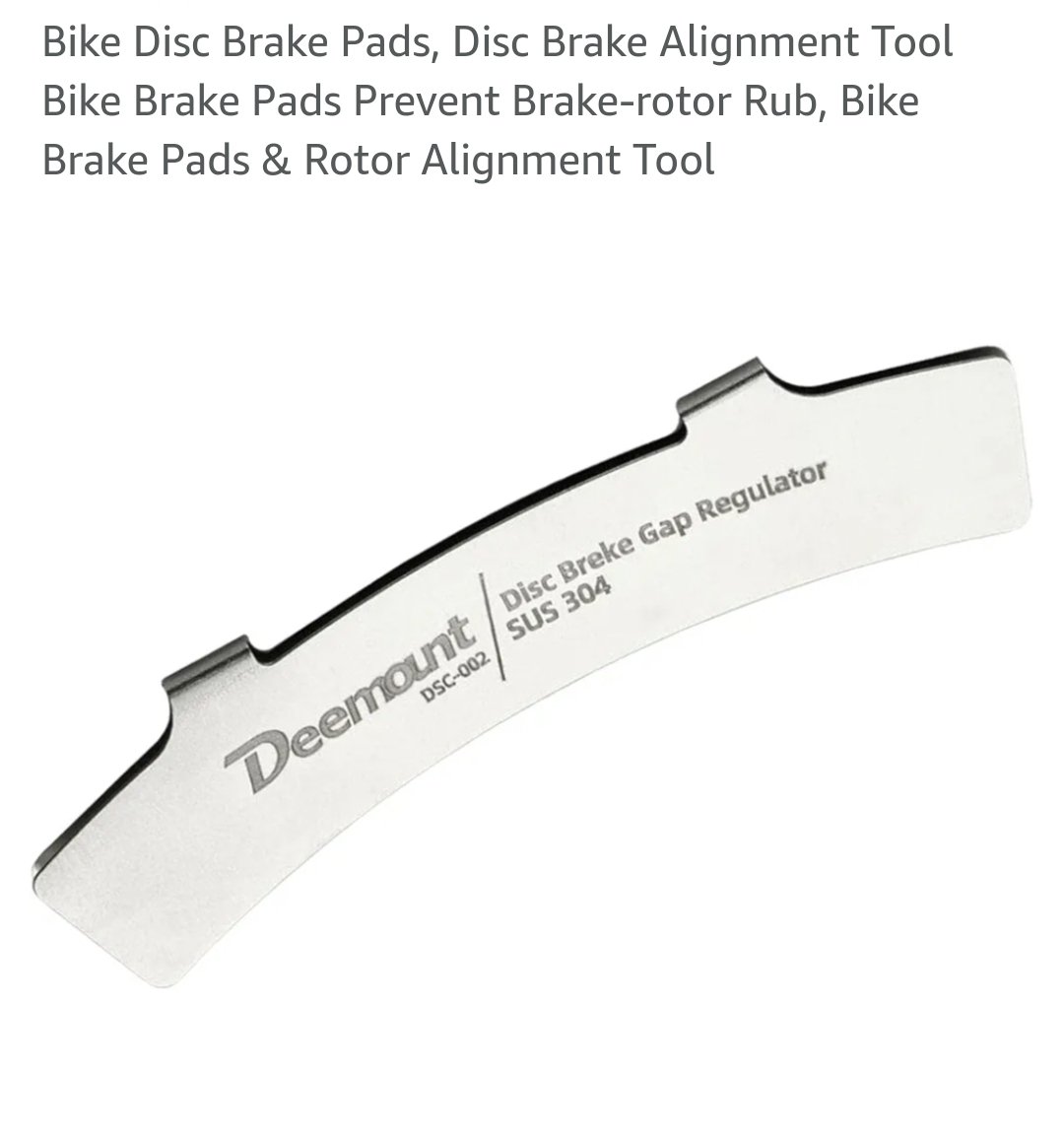

I bought a brake alignment tool and it helps as well, centres the rotor, there are a couple of quid and very helpful
