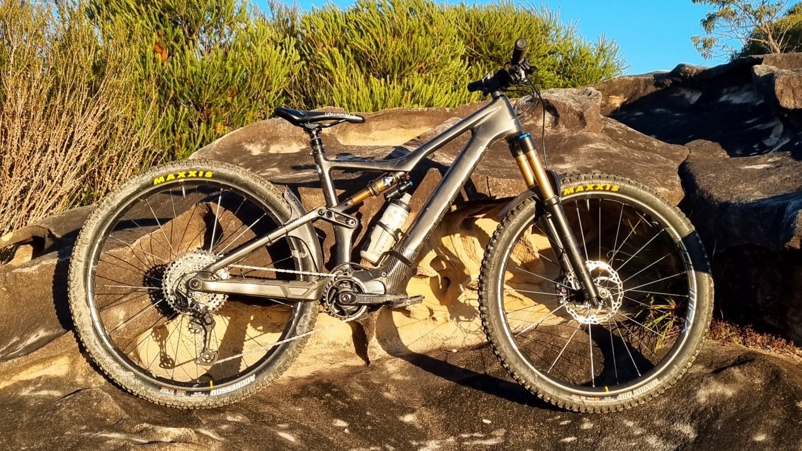

I got the shop to fit ride wrap tailored kit. Very good protection and looks great also. Has accumulated a few nicks from rocks etc but overall impressed. I've heard you can get replacement panels and I might look at that down the track. My bike rack pulled off one of the top tube panels and I dodgy put it back on.
I got the shop to do it as if I did it, there was a good chance I couldn't resist riding the bike and getting it dirty. Definitely do it on a brand new bike with no crap on it!
