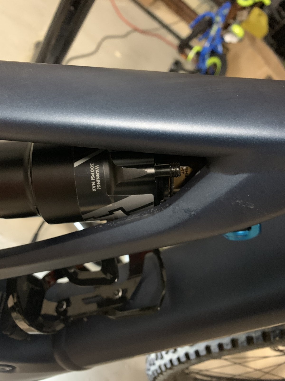

I'm having a hell of a time fitting my new Fox X2 210x55 shock onto my '20 Turbo Levo. The shock eyelets are slightly thicker on one end compared to the other, forcing me to mount it in one direction, with the external reservoir mounted towards the front of the bike. Unfortunately, this causes an issue because the rear of the bike can't fully compress otherwise the air valve hits the frame about 3/4 of the way into the stroke. If I try to flip the shock 180*, the eyelets are too thick with the flipchip to slide into the wishbone mount.

FIXED.
I ended up putting the shock on a vice, took the wishbone off the bike, put a punch into it and pried it open just enough to slide the the shock with flipchip inserts in and tightened it all up.

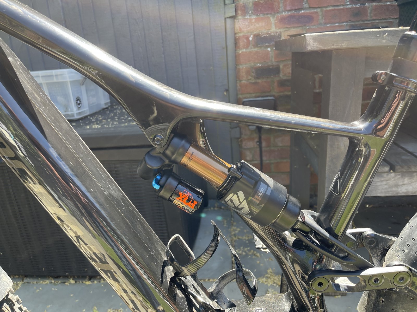

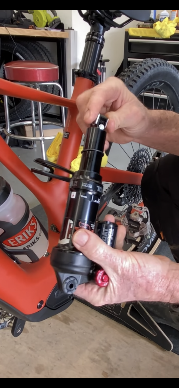

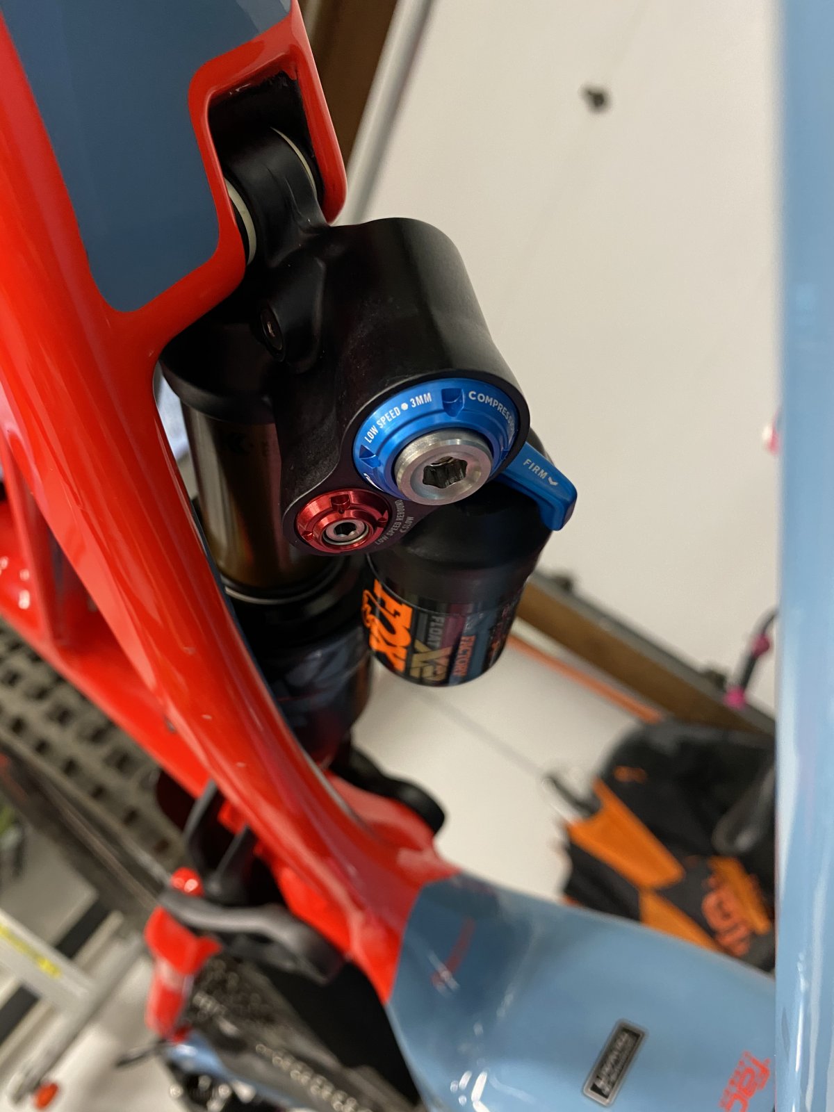

I’m not sure why, but when I rotated the canister, I couldn't spin it enough to allow the eyelet to line up. I like how it sits on your bike better than mine.
I ended up orienting it as below. With the flipchip set to LOW, the shock nor tire hits anywhere on the bike with the 55mm stroke. Im excited to give it a try with the new shock. Last part of the build is the 2020 Fox 36 grip2 160. Unfortunately it’s backordered until Feb24.
Side note, I’ve put 230psi into the canister in order to get 23-25%sag (13mm), and I only weigh 140lb. That doesn’t seem right. Any thoughts?

You need to fit like in your 2nd pic (air can at the bottom) and just rotate the air can 180 degrees so the air valve sits on the outside of the frame
Cant see why you had any trouble with the eyelets, my 210 x55 X2 shock went straight on with no problems on my 2020 expert

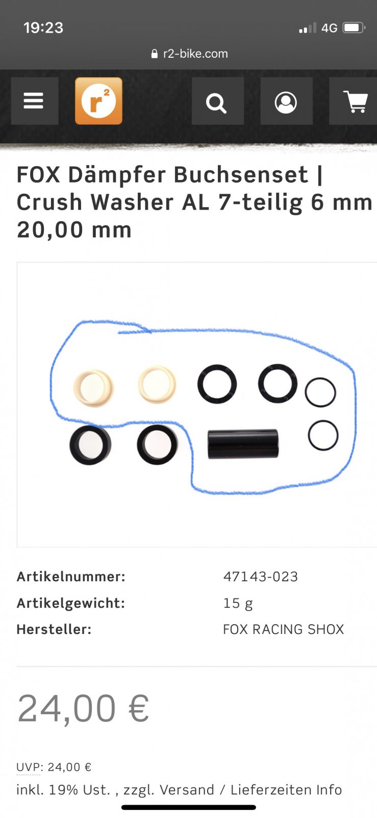

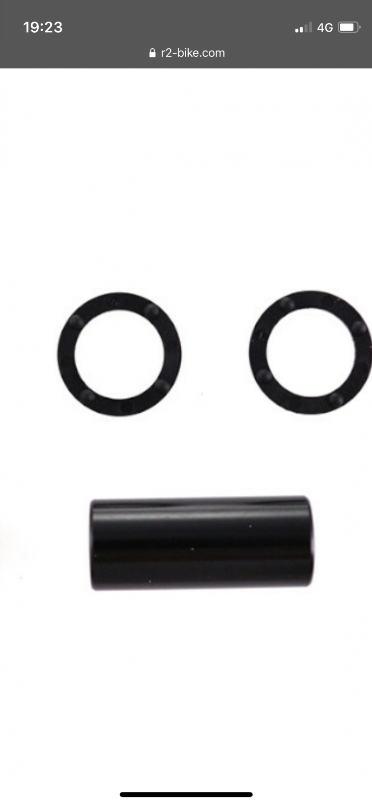

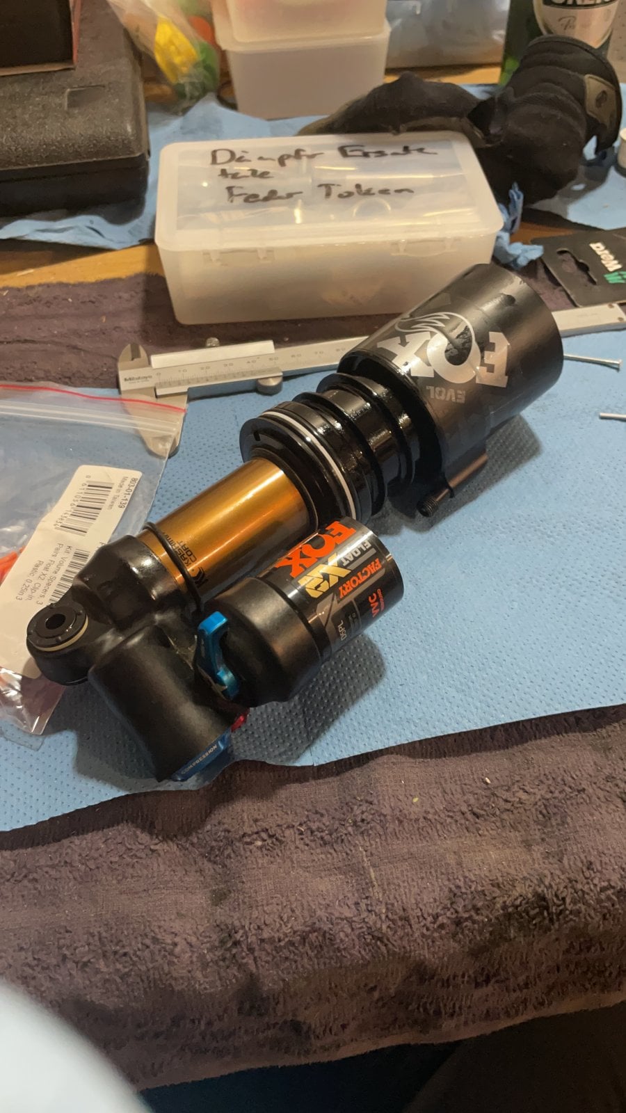

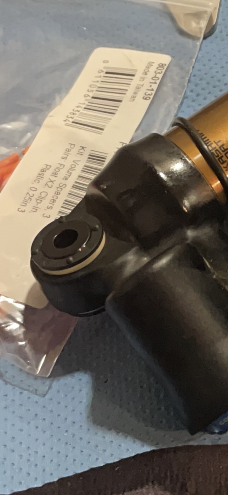

Hi everybody I have no Levo but Levo SL Comp Carbon and bought also the new FLOAT X2 2022 Shock and tried to install it and I hope I had use the correct bushings. I bought the 20mm width within the 5pcs FOX bishing kit. So I installed the the yellow/beige bushing with flunsh and put the o rings on it and at the end I put the small caps with the four small round plugs (picture IMG-6039.PNG ) on it into the shock eye. Did I install it correctly? thanks a lot for your support guys. I had previously the kit without the small black end cap and only the bigger spacer caps and with them the width was more than 20mm so I thought to buy the 5pcs set with smaller black end cap with the 4 small round "plugs" (picture IMG-6039.PNG ) on it. It seems to be fit correctly in my frame but I want to be on the safe site. Furthermore I have currently the "issue" that when I sit on my bike that I can hear a quiete sandcrushing sound within the shock eye at the top when it is installed within the frame. I'm a bit scared that the Bolt which keep the shock in the frame that thread from frame whole is damaged or filled with a bit of sand or sth like this. or is that sound normal? With my previous fox float dps I mean do not have this sound. thank you in advance for your help

You need a m6x20mm. That doesn't look right, it should be flush with the mount. Why didn't you use the one that came stock with DPS?
Hi , i used the 6x20mm Bushing and according to the litte width from the "yellow" bushing (with the normal DU Bushing you have this not) I needed to use the small black end caps with the four dots on it. The previous two black end caps were too wide and therefore the 20mm max. width couldn't be reached. I searched for some similar pictures (see attached). Or do you say, that this is not correctly the fitting?
I thought the DU Bushing is older and worse. I was a bit confused that in my new Levo SL was installed the older Bushing system.
Thank you for your help

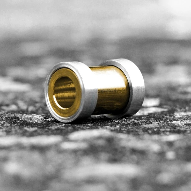

Have a look at offsetbushing.com , put your bike model in and they will tell you what you need. I ordered the below in m6x20mm and its perfect.

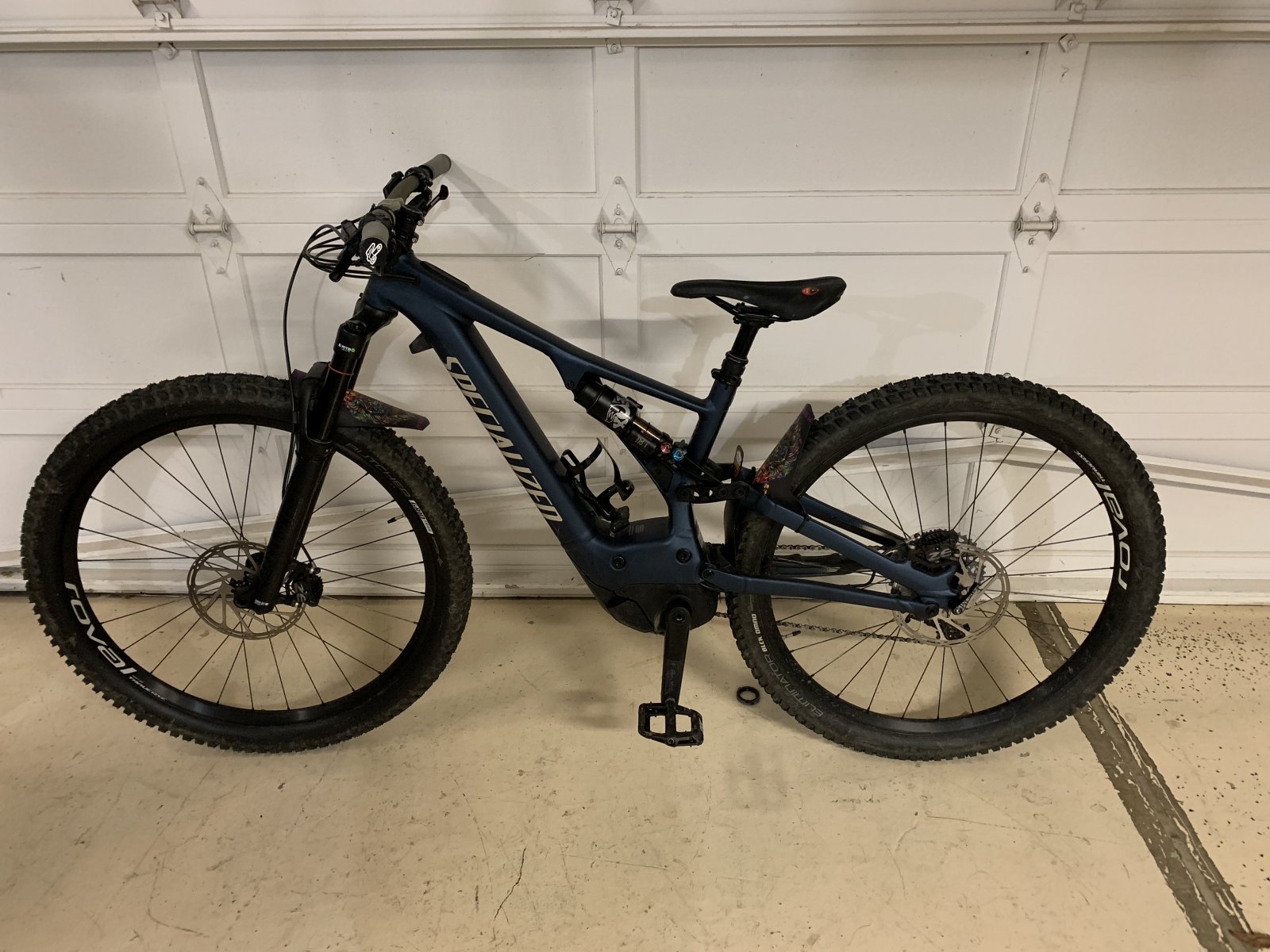

Just following this up as fitted a 2021 x2 to my 2020 Levo Large today without any problems.
I bought the 20x6 mounting hardware, flip chip in low position, it slotted right in fine.
Mounting kit is:
Part number: 803-03-327 (ref 214-08-026) (Fox Rear Shock Mount Hardware M6 x 20.00mm) or 6mm x20mm/0.787
Note: I didnt use the mounting hardware from my DPS as the DPS has the older metal sleeve instead of the newer white polymer sleeves, and couldn’t be bothered to try to press out the old sleeve for reuse.
