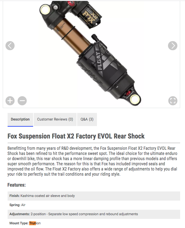

Hi all, I've had a search on here but I'm struggling to find out how to fit an X2 on a 2022 (large)Trek Rail 5. I called TF tuned but didn't get anywhere in the conversation when asking what hardware kit to buy. It's quite confusing as the website says this is a trunnion fitment despite the eyelet not going through the shock.
and apparently my current shock isn't a trunnion fitment?
Basically I would like to fit an x2 on my trek rail 5, can someone tell me what size x2 to byt and what hardware kit from the tftuned website?

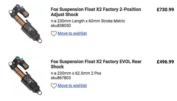

Ok, after more research it seems that when these companies advertise these products some state that the shock is a trunnion and show a standard fitting in the photo, so you don't know what you are getting unless you call them. Anyway, will I have issues if I fit a 62.5?

This is the reply I got:
"Unfortunately, we do not believe the Fox Float X2 will fit that frame. We have had one in the workshop and the air can doesn’t quite fit and clear the charge port on the seat tube
Many thanks"
So whilst they didn't try to sell me something else they didn't offer a helpful solution, which is the same tone I had from the guy on the phone who refused to just tell me what I needed and said go look on the website...I then had to force him to help me navigate through it to find what's needed in the trek section...which doesn't say it will fit fox shocks so was none the wiser after a very awkward and unhelpful conversation. I then said it's ok, I'll do my own research and find out (rather than ask a knowledgeable company to just tell me what I need). Honestly, you can't give money to companies these days as the staff just can't be bothered.
A helpful company would be saying "Yes Sir, this is what you need and the cost is this much, and we have the shock in stock if you'd like to buy it from us, AND the total comes to £xxx so if you'd like to order now over the phone it will save you traipsing through our website and having to research what you need for hours on end."
But no...all I get is "it's best to use the website" and "We don't believe it will fit". I was calling because I was having trouble finding the right part on the website, I wasn't calling for a chat. lol. Anyway, I will report on here if the 62.5 fits to save others from the struggle. I'm really surprised Trek put an £80 rear shock on a 5 grand bike to be honest. It leaked after first use.Apart from that the bike has been awesome. Especially with the front forks I bought, but now it's time to match things up.

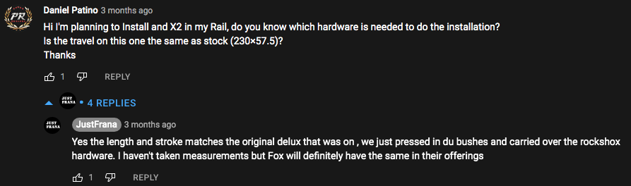

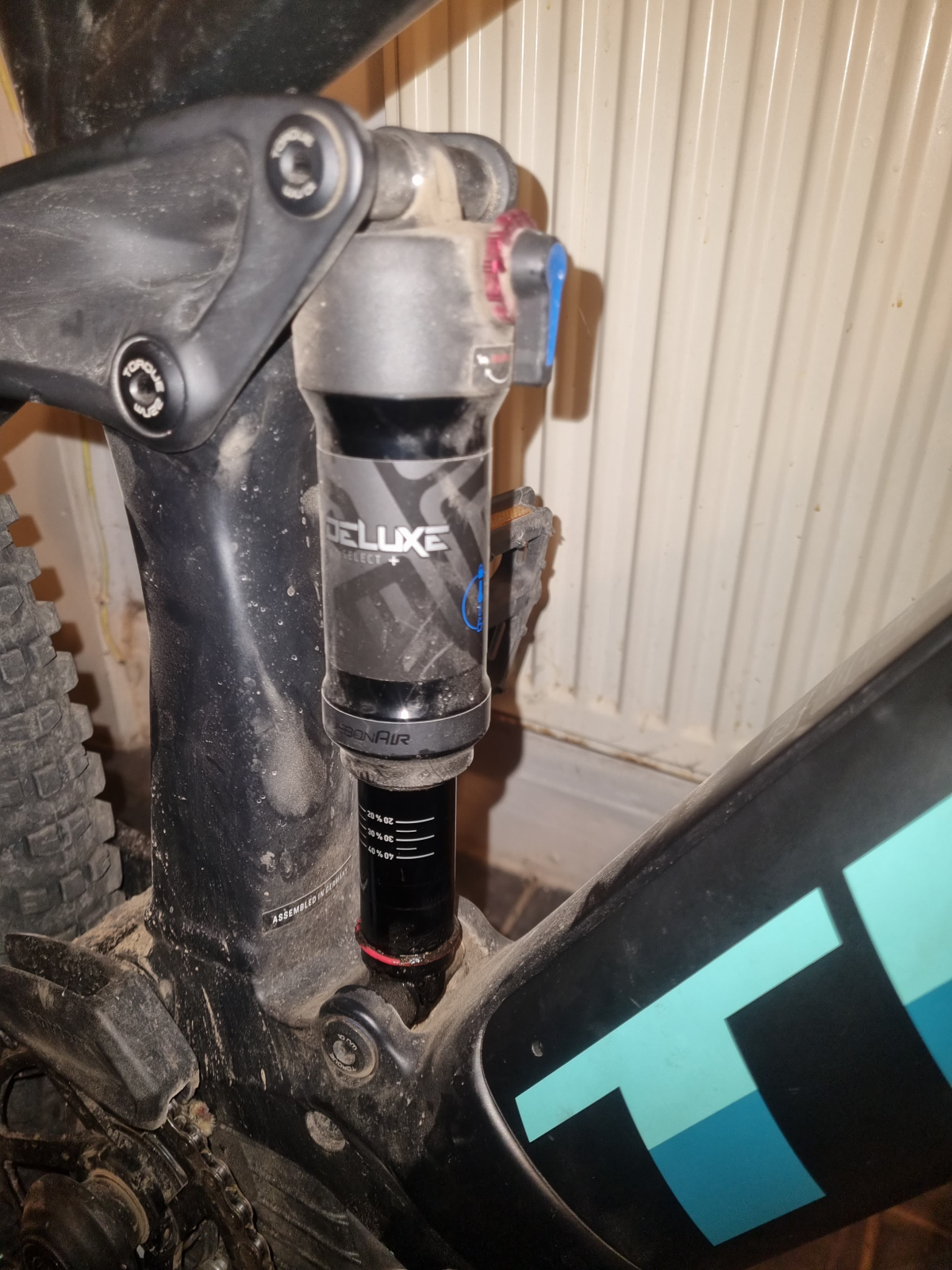

I have fitted a 230 x60mm x2 to my rail 5. The standard non trunnion one. All the mountings from the rockshox shock can be swapped over to the x2 including the bushes. The bolts straight in.
Viserys
Apr 17, 2021
13
7
And my rail is a medium. The rail 7 with the trunnion would need a fitting kit but th standard deluxe on the 5 gives you all the hardware you need.

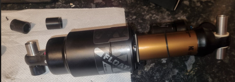

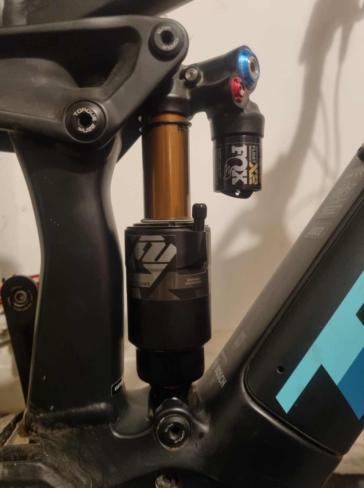

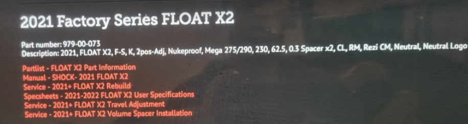

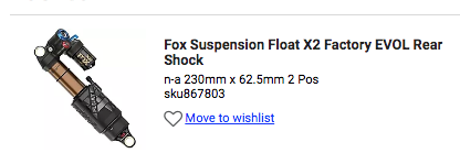

So, I bought a 230, 62.5:
Had to take it to he local bike shop to remove these bearings...it was a real pain even for the bike shop as they didn't have the fox tool, but they persevered and did a great job:
Here's how to do it.
The I swapped over the hardware:
This is the result...plenty of room and funnily enough it doesn't hit the charging port, nor did it catch on the moon :/.
That's where the ring sat after a big gap. The shock didn't foul anywhere and I didn't need to buy any new parts to fit my Trek Rail 5 (L).

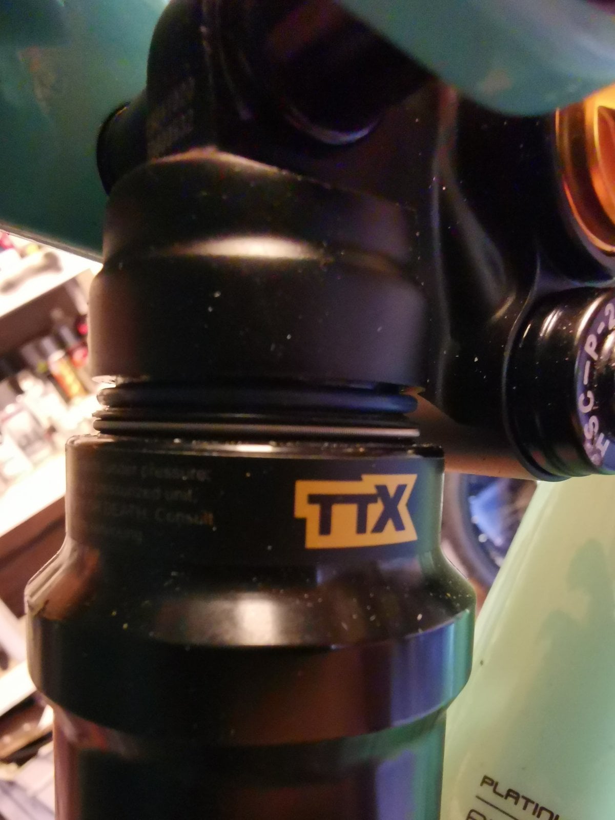

I fitted an öhlins ttx1 with 65 mm on mine with no problems.
NOTE that you cannot run the mino link at low with that 5 mm extra stroke as the rear frame then hits the seatpost.
I'm running my mino link in the low position with 5mm extra stroke over the standard shock without such issues.

Have you fully bottomed out the shock and also the bump stop?
With the mino high, full 65 mm squish on aluminium rail 7 2021 there is about 3 mm gap to the seat tube.

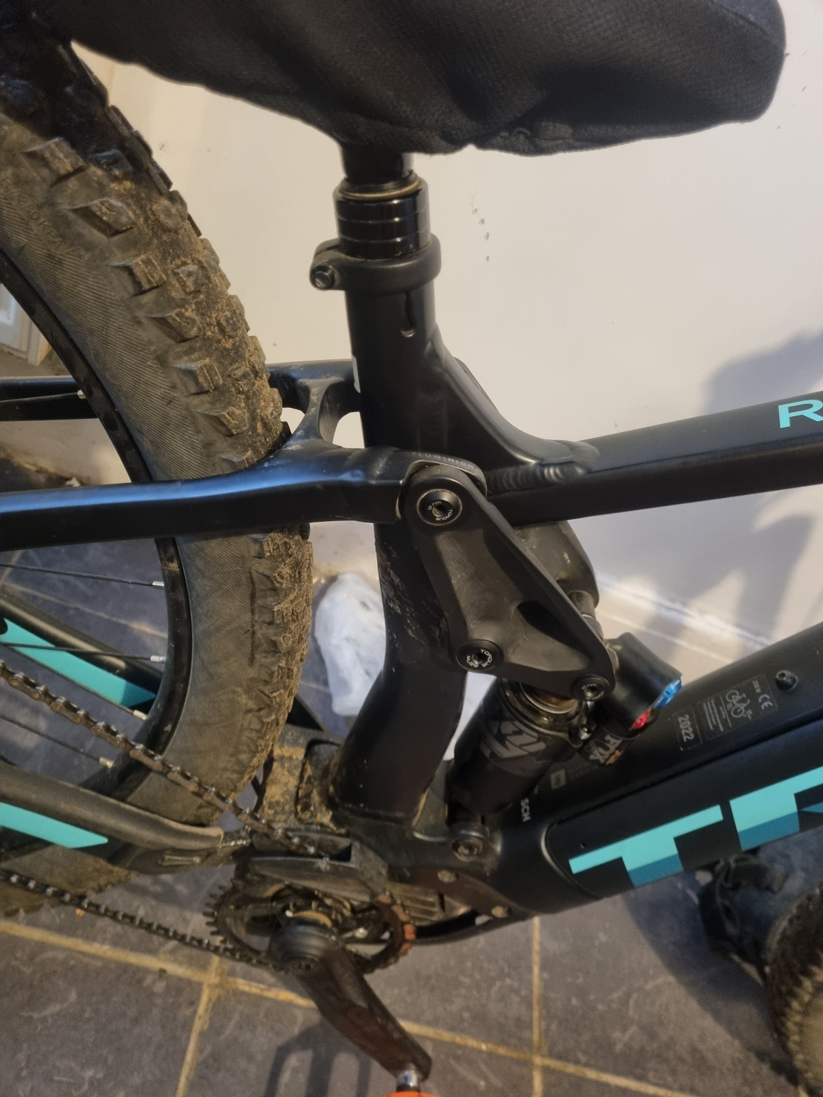

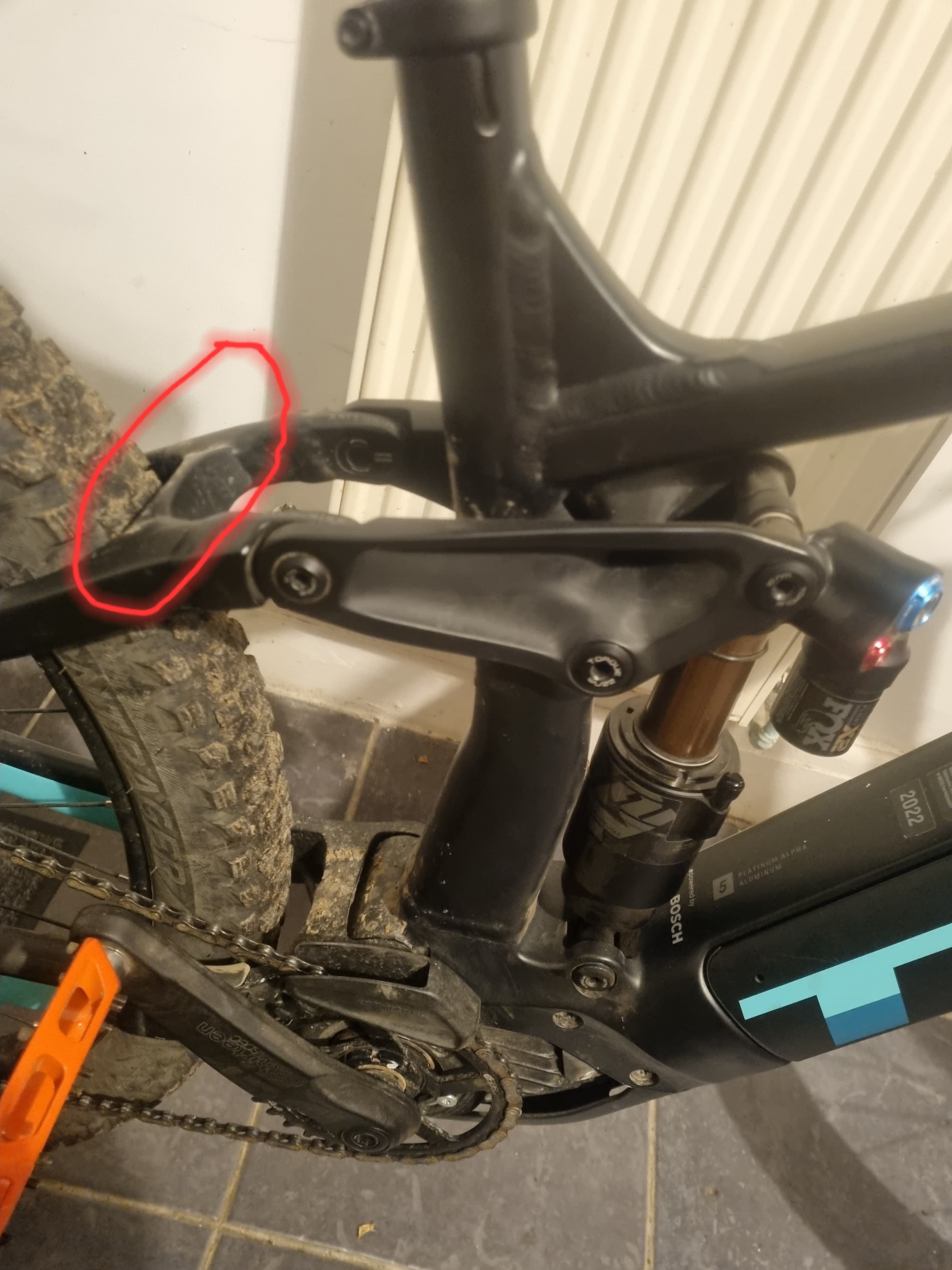

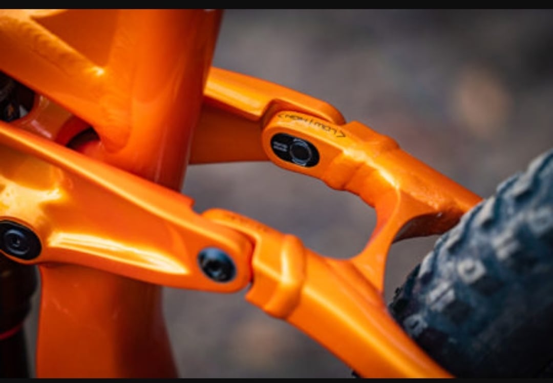

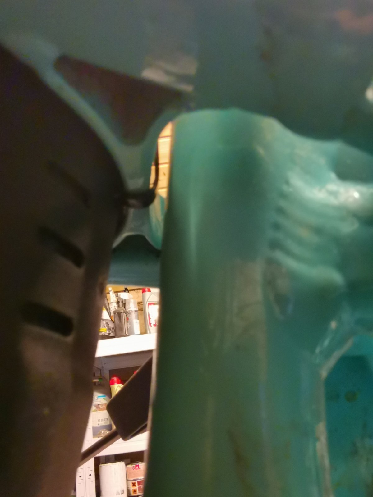

I mean the rear frame where the tire is mounted, it has a joining part between the tire and the seat tube that hits the seat tube if too much travel. But i only can say this on the 2021 model as the 22 has different frame, situation might be different.
Thanks. Hopefully it will never touch with my 62.5. To be honest I think it's a mile away on my bike in the low position but the frame does look the same as yours. Is yours an large too?
My bike is xl. That picture was just showing the part that might hit. I'll take pictures after work.

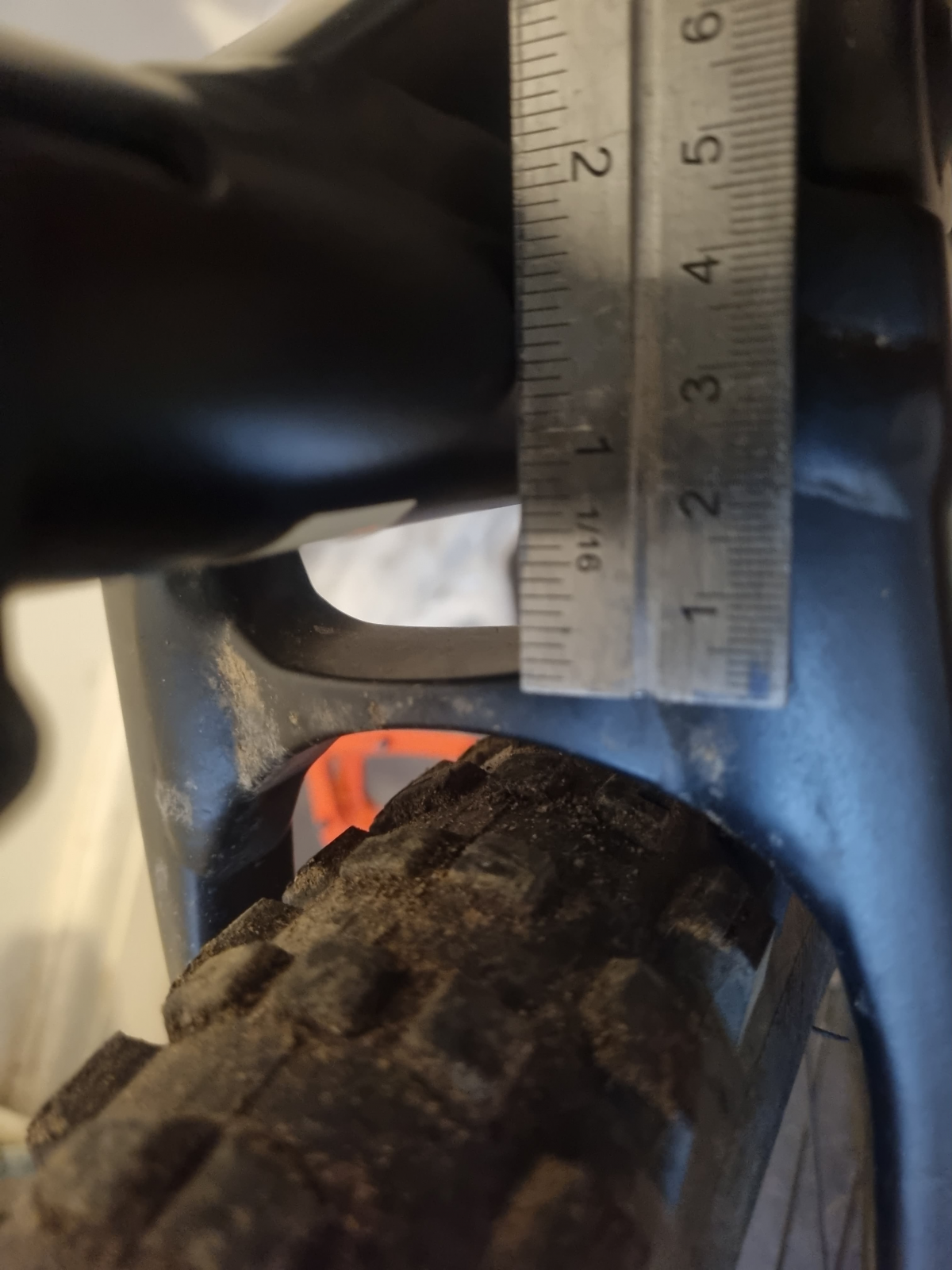

Thanks...we await the photos.
Sorry _almost_ forgot 😁

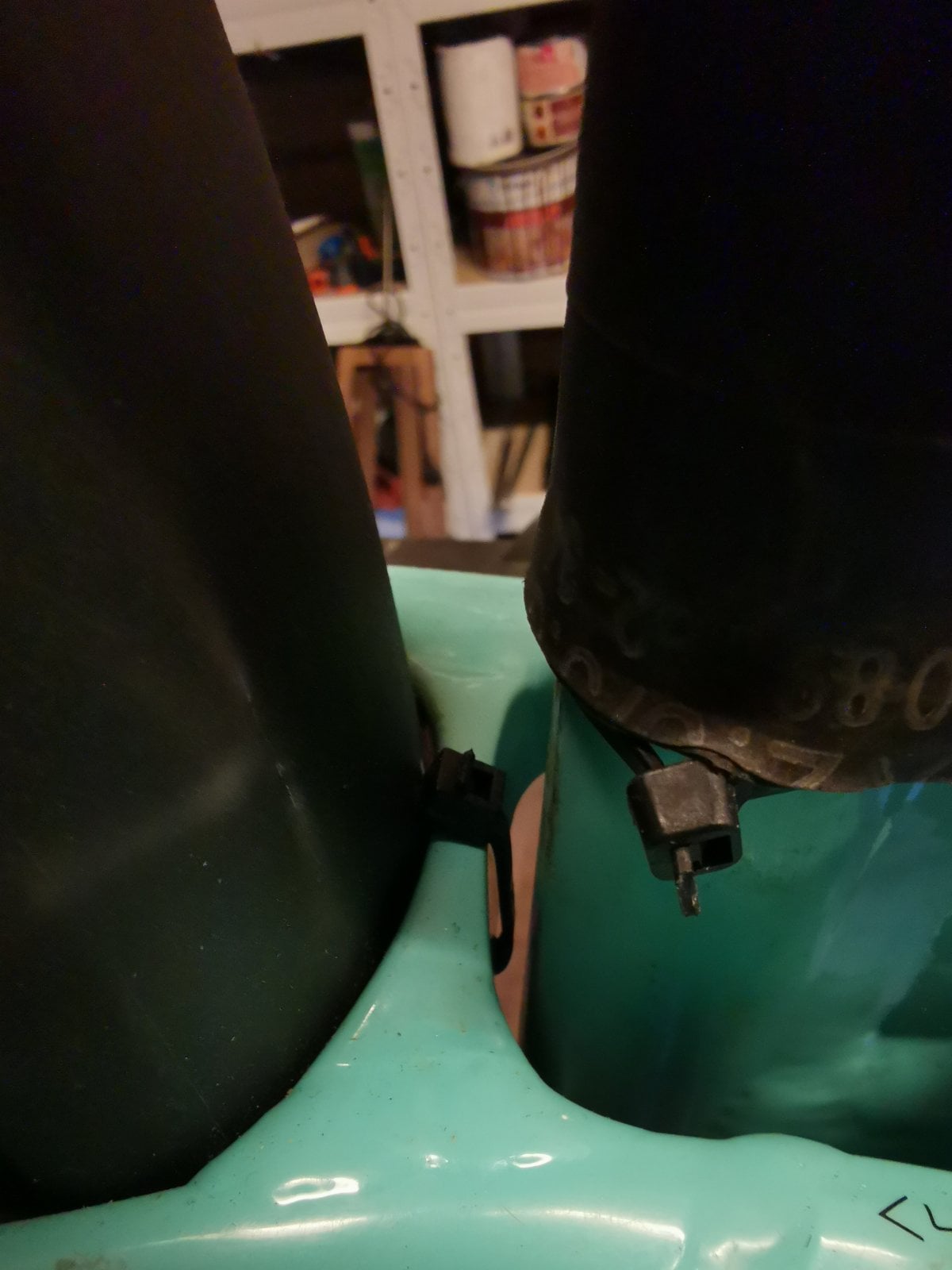

I gauged that with a 4.5 mm drillbit. I'm pretty sure that even as it looks the shock is bottomed out, there might still be some movement left and since the leverage ratio is 2.4 it could get really close on hard bottom out.
So to be safe i'm going to glue a piece of broken Magic Mary there to give some cushion.

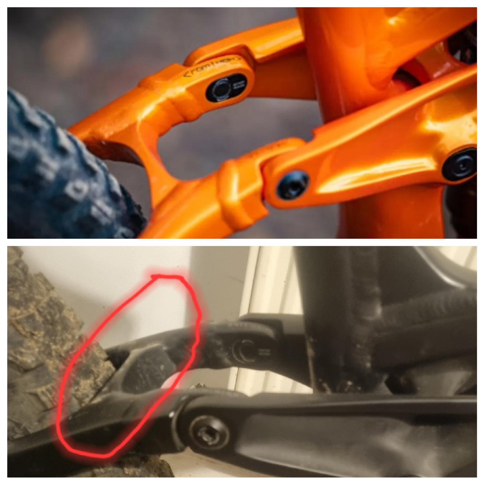

I presume you mean this part of the frame? If so it's an absolute mile away on mine. Is the frame section there completely different to yours? Could you take a pic further away for us....like this?

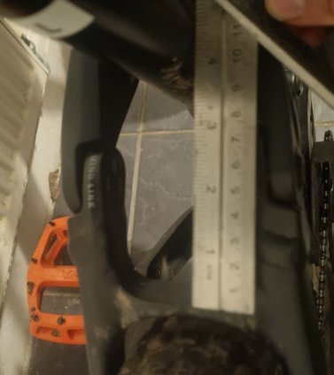

I've just put the 2 photos together and the 2022 Rail 5 gap between seat post and the lateral join you mentioned looks a lot further away compared to a 2021 Rail 7.
What does your ruler say? Could you take a photo like this?

By letting the air out? I can only get it so far by bouncing on it in situ.
If you are going to use more than the 57,5 mm strike, yes i really suggest you check clearance thoroughly.
Let all the air out and carefully compress the suspension until the shock itself is fully compressed.
This is the only way to find out if something is not clearing.
When i tested mine i noticed that with mino link low you could get away with 60mm shock travel, but 62,5 was already almost hitting, and then you need to take account that In a bottom out situation things flex, so you want to have some room for it.
Well from just looking at it when I bounced up and down I could tell it would be an absolute mile away on full compression. It was so obvious that if some volume spacers hadn't turned up today I wouldn't have bothered letting the air out.
This is how it looked with no air in and after I sat on it:
And this si the measurement:
Like I said, nowhere near on my 2022 Rail 5. I could easily go to a 65 with no clearance issues in my opinion. I hope this helps people in the future, but to conclude....the 62.5 fits with the standard Rockshox hardware and has no clearance issues anywhere. Fully checked with no air in and on track with a decent impact landing or 2. Here's an example of what I'm doing with no issues from the shock:
