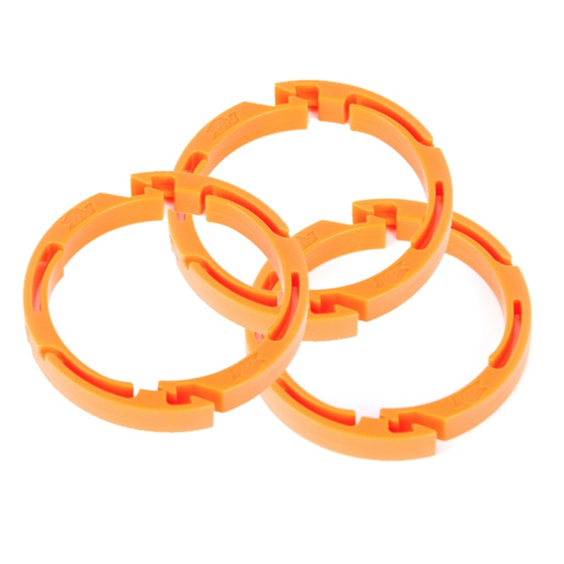

If it bottoms too easy, try to put some tokens (spacers)
The shock currently has no volume tokens in it, it can take 3 which is how many came in a bag with the shock. I didn't think that adding the tokens would dramatically change the the amount of air the shock would need to achieve sag, but I could be completely wrong here. I just thought, as the tokens only change the end of the stroke, they won't effect the sag amount. But of course there will be less room for air. I will try adding the 3 tokens tomorrow.

And keeping the same pressure with tokens maybe eliminate bottom outs.
But try first with one token or as fox says volume spacers.
And remember that there are different thicknesses of tokens.

When you add tokens, less air is needed to get the same sag.
Ok, I just never thought it was that dramatic a difference. Maybe just 10psi. I don't want to end up with a shock that I am not using the whole Tavel due to the ramp up from the tokens.
The spacers/tokens are all the same size, but you use multiples
First try with one and if that wont work, change the thickness of token

Oh sorry, you don't have Fox. Maybe RS has same thickness of tokens
The Fox X2 shock (which this is about) has same size rings...

I run 300psi for I think 25% or 22% sag on the stupid cascade link. Ya need 3 spacers minimum. Maybe 2 tho if you’re not jumping. Then you’ll have a lower psi. For commuting I used to run 260 with 3 spacers.
4 is the max. Which would give you the lowest psi at that sag so best tiny bump (but not small) compliance but you’d never touch bottom unless you’re doing house sized jumps

I run 300psi for I think 25% or 22% sag on the stupid cascade link. Ya need 3 spacers minimum. Maybe 2 tho if you’re not jumping. Then you’ll have a lower psi. For commuting I used to run 260 with 3 spacers. Which would give you the lowest psi at that sag so best tiny bump (but not small) compliance but you’d never touch bottom unless you’re doing house sized jumps
I’m 96kg unless I start drinking.
I'll try 2 spacers tomorrow and see what psi I need, and then see if there's any unused stroke

Went all out and added all three volume spacers this morning. Acquired sag with 250psi. 30psi lower. That's about 10psi per spacer. Havent got time to test today.
Ive left HSC wide open, and LSC just 3 clicks in from wide open ready to test.
