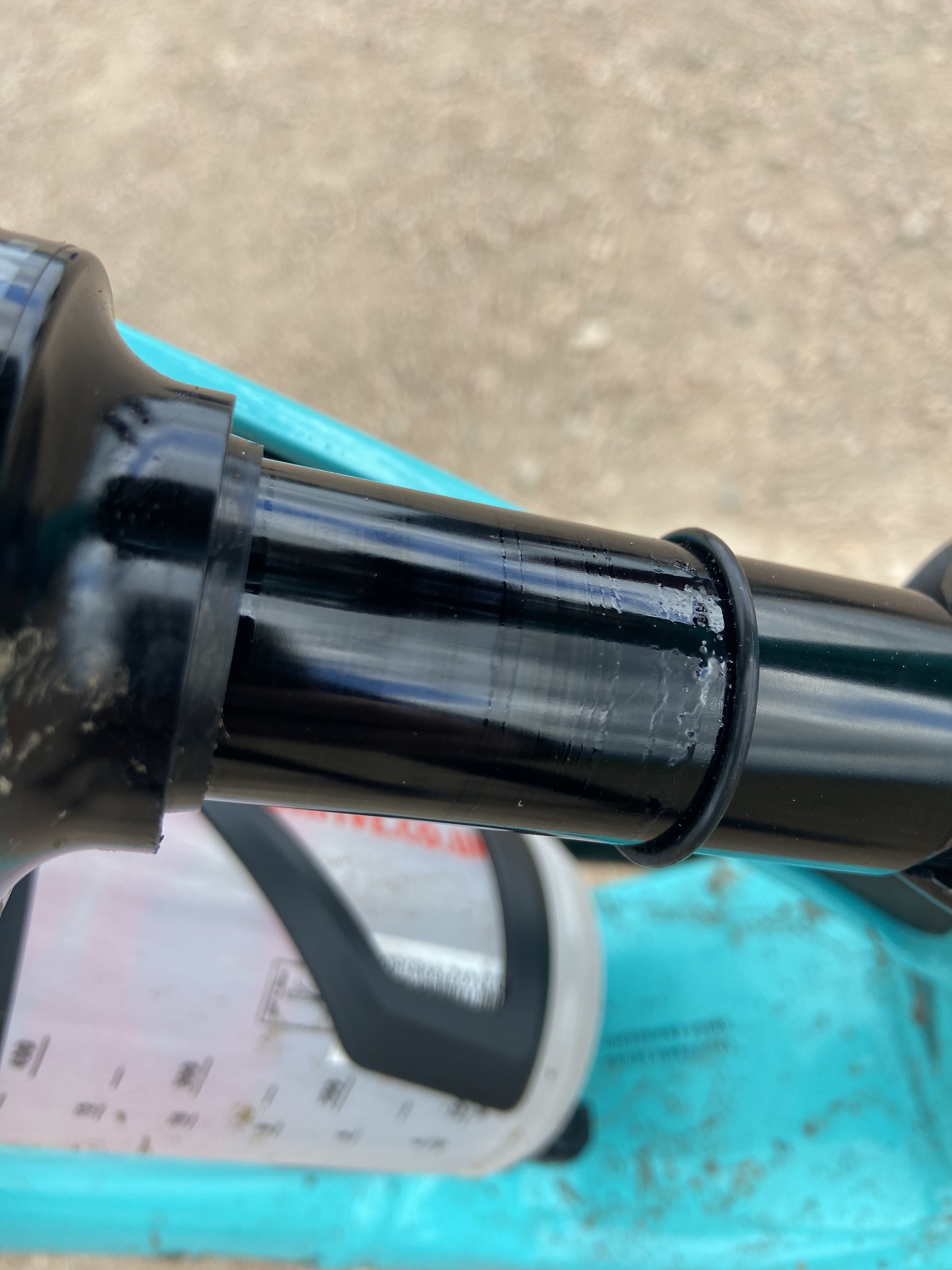

My shock (fox float x)had to go away under warranty after 3 weeks of having my Kenevo in Feb. It’s now leaking again and got to send it off for repair again so will be without the bike for 3/4 weeks.
My question is, is this a normal amount of oil leaking on the photo attached or should it not leak at all. I am wondering if it was overfilled from the previous repair but it doesn’t seem to be getting any better 😞
Has anyone else had similar issues? Tredz haven’t been helpful at all to be honest just want to send it off again.

Looks quite a lot
They do produce a little oil sometimes past the seal but it shouldn't be anything like that on a new unit
Just wipe it off and ride the bike. When the shock is assembled, lubricant is slopped all over the parts before they're put together. Some lubricant is trapped between the sealing surface and the wiper surface. When the shock is new, the lubricant will work its way past the wiping surface. "Overfilling" isn't a thing. Only a few cc's of oil go in there. "Overfilling" would result in a shock that doesn't work properly. You can expect this phenomenon on new shocks as well as those that are recently rebuilt.

Would you still expect a large amount of oil after every ride? I have to wipe the shock every every section of my local trail and there is a fair amount of oil on there. If theres only a few cc of oil in there I’m shocked there is any left 🤣

Mine has a weep like that I noticed. Put it down to settling in past the first seal. It did not persist after that though. Two volume spacers fitted, if relevant
