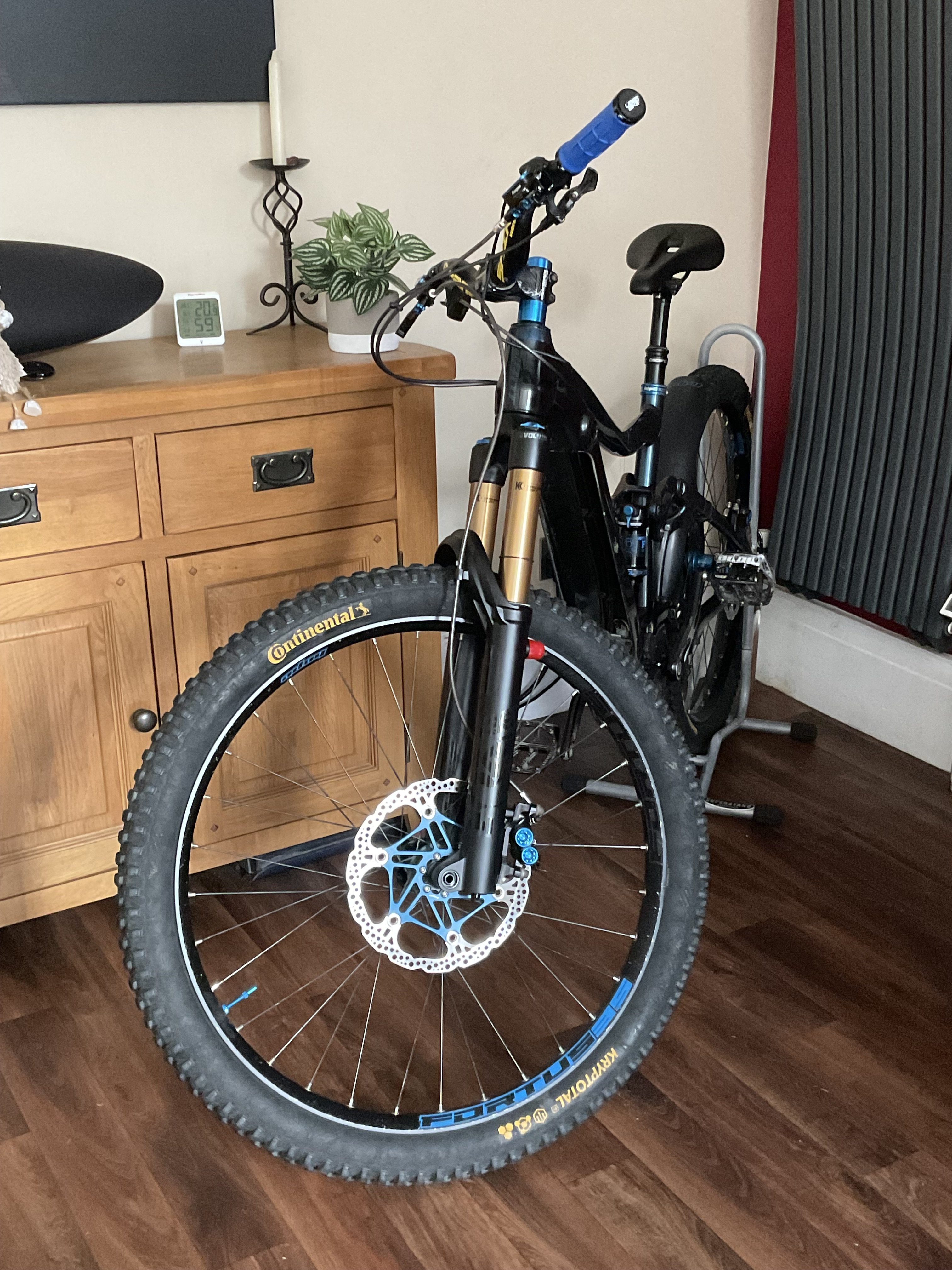

Pic for some colour.
(Blue decals on their way… this O.E. stealth is boring, but at £800 discount who cares?)
