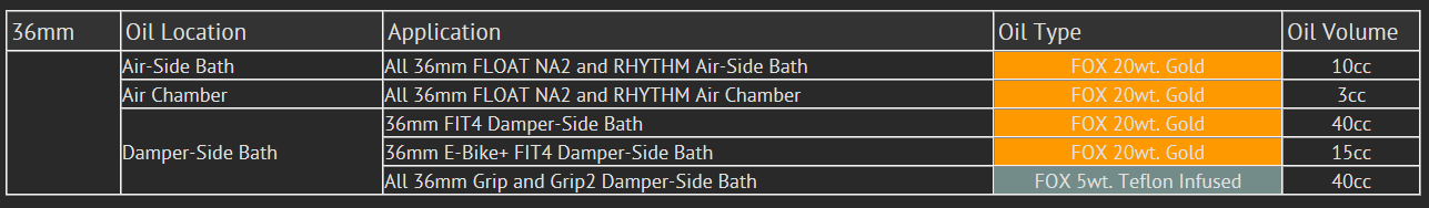

Hello People i am about to do a lower leg service on the above fork. I have bought the seals went with SKF in the end. I can not figure out which oil to use can any body help? the chart is below. As i have the Grip2 damper i will put 40ml of Fox5wt in that side but what the difference between Air-side Bath and Air chamber? I s the bath the lower leg and air chamber where yea attach shock pump?
