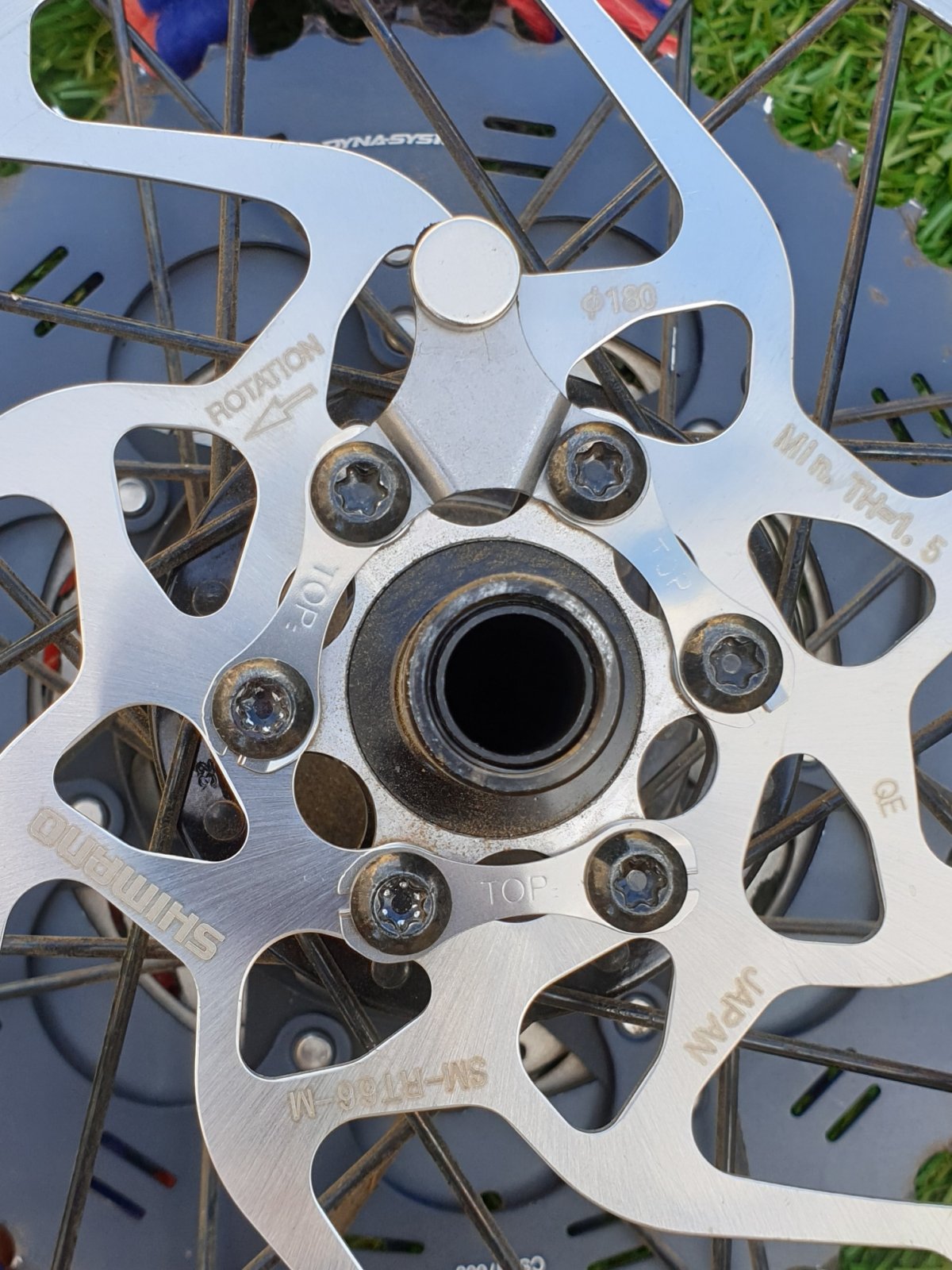

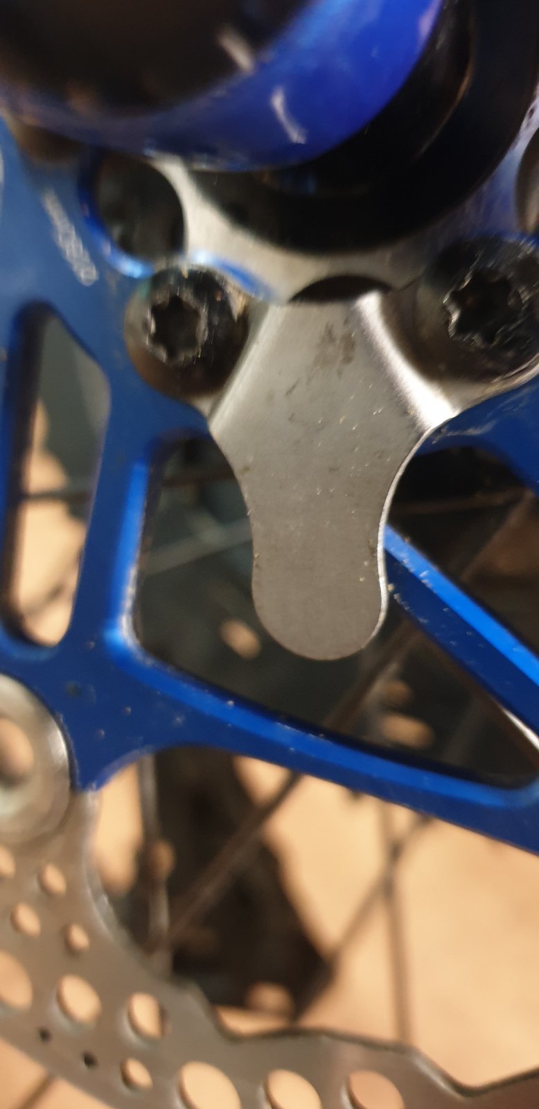

Coukd somebody with a Focus please post a picture of there speed sensor magnet that is on the rear disc. I have a w011 error and think my magnet has fallen off.
The silver metal plate is there but cant remember if there should be a magnet on it... the plate alone does not appear to be magnetic....
Thankd

Mine became dislodged on the first ride. Fortunately I found it stuck to the disc.
It was only held on by its own magnetism and a bit of double sided tape.
Now Araldited on.

Thanks for replies. Just checked the rear disc and the magnet is stuck to the rear of the disc!!!!
Just glued it back onto the shaped plate, then its out for a quick test.....
