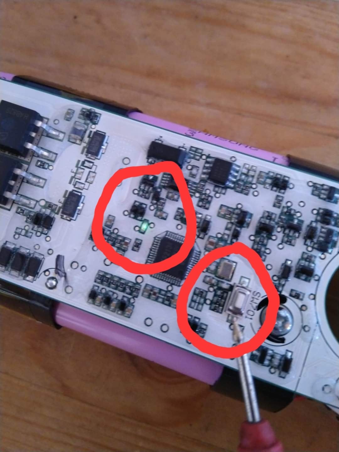

Turns out there is a reset button inside the battery, pushed it and battery and bije now working.. wouldn't take apart if bike still in warranty as it is tamperproof

it's this little button and green led should come on too then it was fine... like said battery case is very fragile so I'd only try it our of warranty

Mine would not turn on or take a charge. When I dropped the motor and removed the battery I connected everything up again and tried to charge. Only one of the charge level indicators on the outside of the casing illuminated, the one in the middle, so I assumed the battery was cream crackered and resigned myself to buying a new one if I wanted to get the bike going again.
I might give your potential fix a go now but have read in the past that the casing is tricky to get off.

Yes if you gently go around the case join with Stanley blade and maybe gently warm it, which I should of done.. then I used flat blade stumpy screwdriver to prize it open

It sounds like the battery protected itself due to a short circuit elsewhere on the network. Well done on finding the reset switch but do not ignore what probably caused it to go into defence mode in the first place. There is probably either a charging port or on/off switch....or maybe terminal connection at the motor PCB which is not well protected against water ingress.

Yes if you gently go around the case join with Stanley blade and maybe gently warm it, which I should of done.. then I used flat blade stumpy screwdriver to slowly prize it open... its takes bit of time and effort to get apart

Just had a look at my battery.
The good news is that the casing came a part okay. I used a half inch chisel for the initial separation until I could get a flat blade screwdriver in. I worked from above, pressing down on the casing to help release the clips. I also found the wedges that you use to keep your brake pads separated when the a wheel is removed useful to stop the clips springing closed again.
The bad news is that press that little button as much as I could, nothing happened.
Looks like the poor old Focus is spares and scrap after all.
