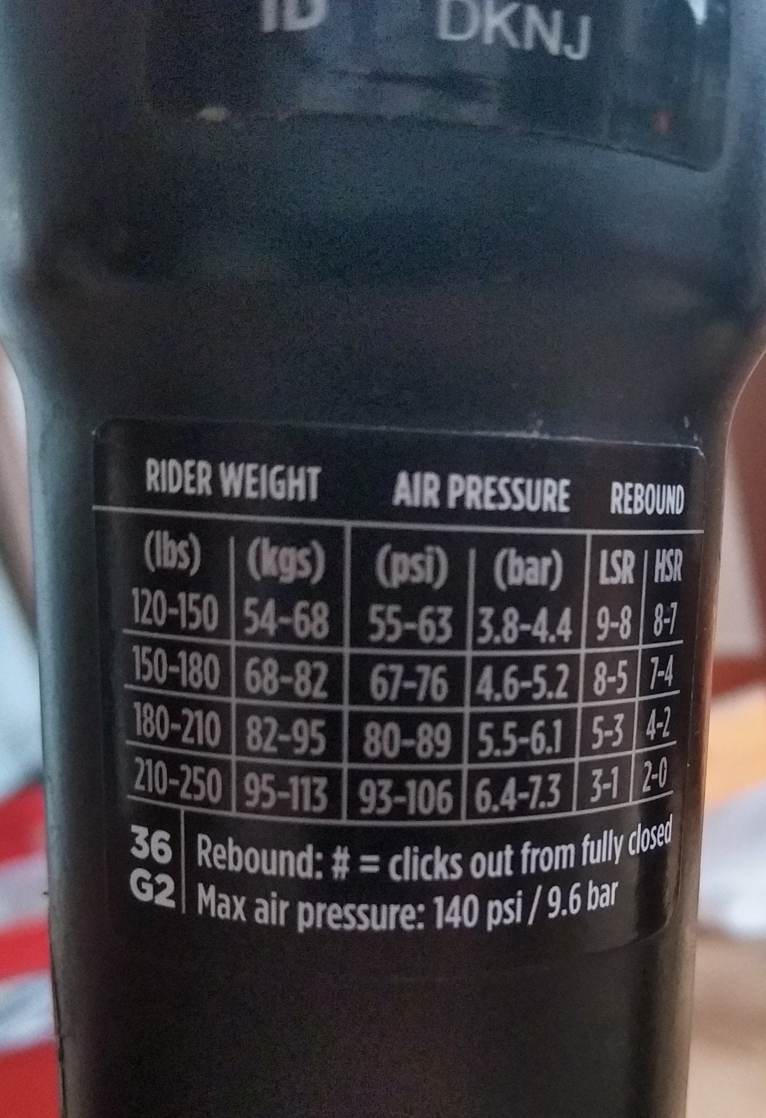

i just follow the guidelines for pressure, see the sticker on the fork. for me thats 185 in the back, 90 front.
Moots YBB
Dec 18, 2018
67
56
Brussels
this is what the fork says, you might be right i oversimplified the pressure for the rear shock, i think it's all beside the point, as the subject is the flip chip, or do you imply my bike might understeer if the pressure is too low ?

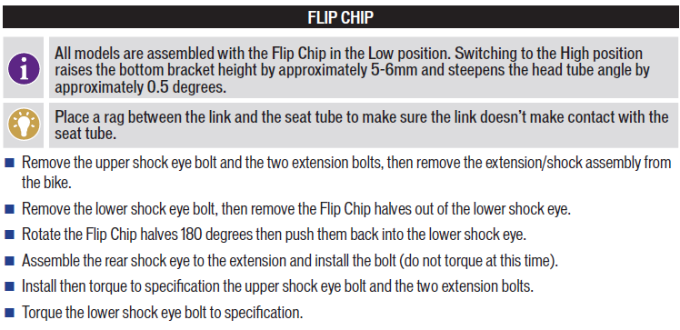

The manual says all models are assembled with the flip chip in low position:
1550821731219-png.11163
1550821778250-png.11164
1550821820705-png.11165
1550821838709-png.11166
I never tried the high position. @Specialized Rider Care can you maybe give some official advise? I assume there must be a reason why you have choosen for a default low position?

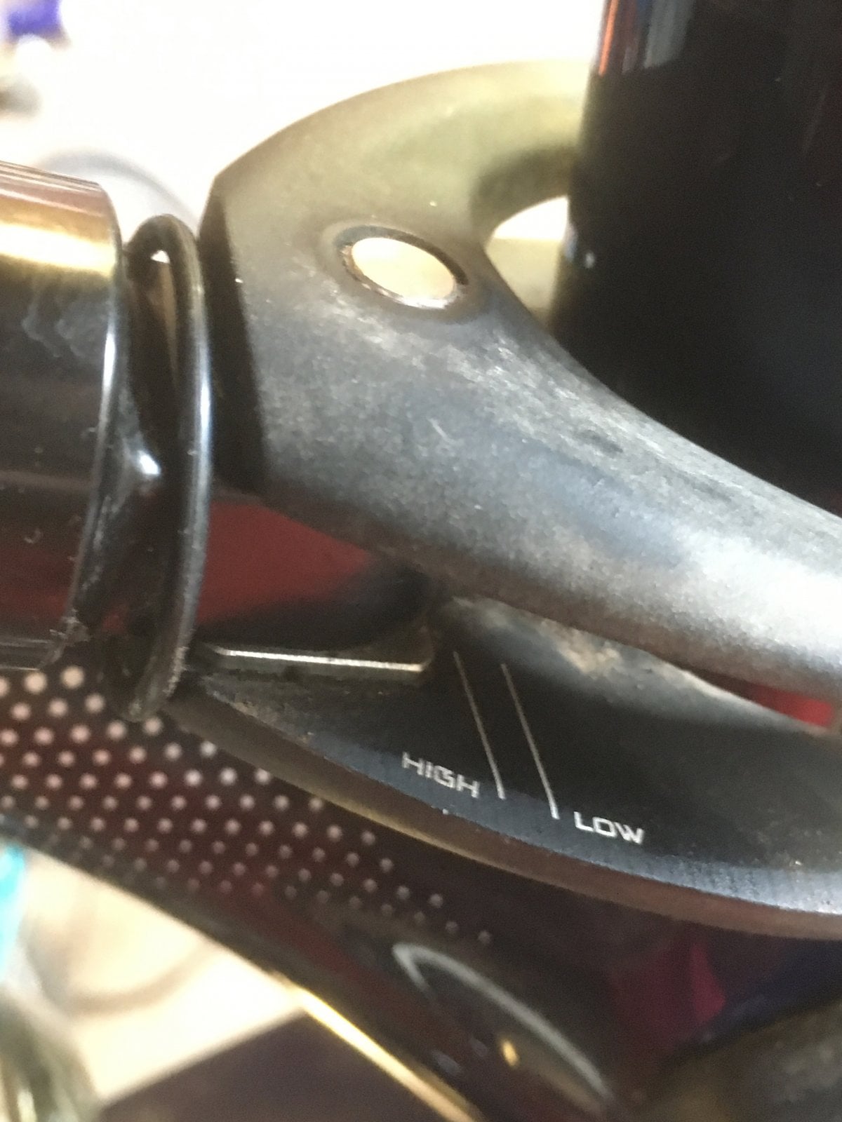

EDIT: confirmed my bike came from the dealer set to high. see following post for a video link on how to do the change and a couple of photos of the disassembled parts. If you're unsure which setting your bike is on (it's not 100% clear from the markers) you have to disassemble it.
I SAID:
regardless of what the manual says, mine, collected from a dealer 3 weeks ago, came set to high. (assuming the marker lines on the assembly are meant to indicate which setting the bike is in ... which I am now questioning ...).

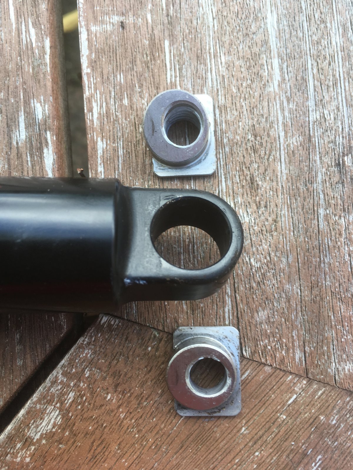

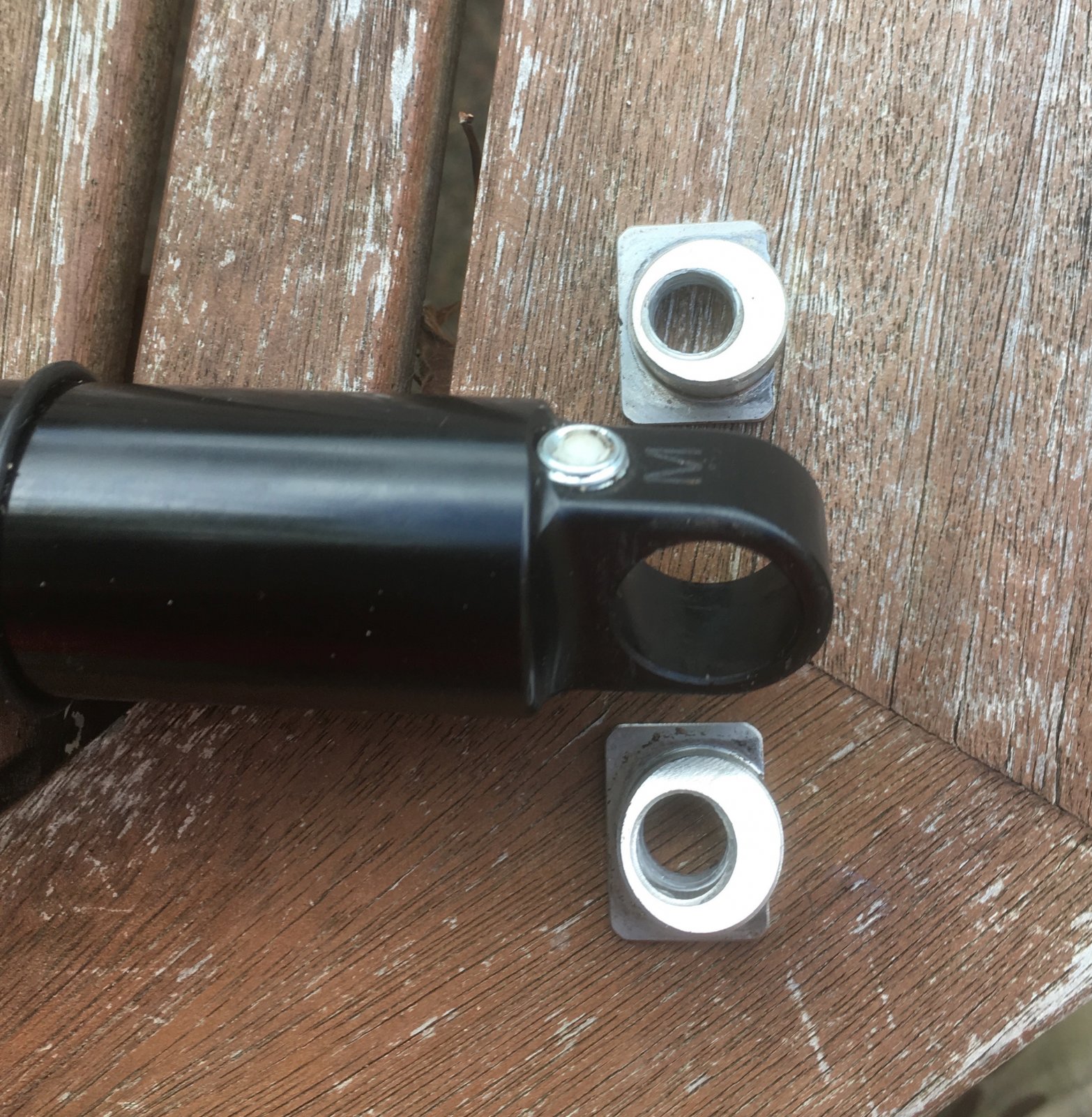

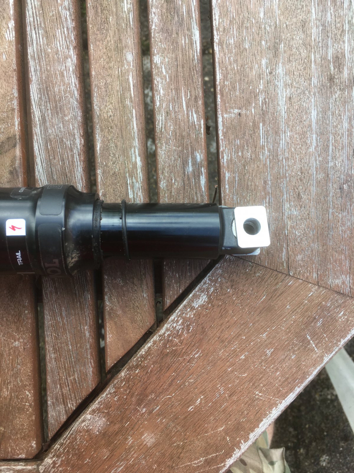

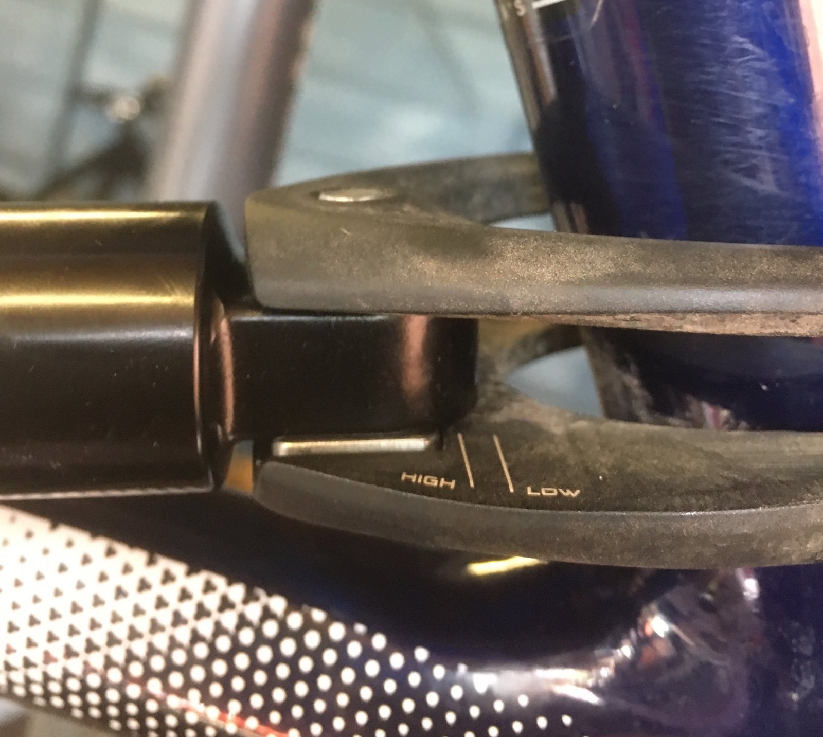

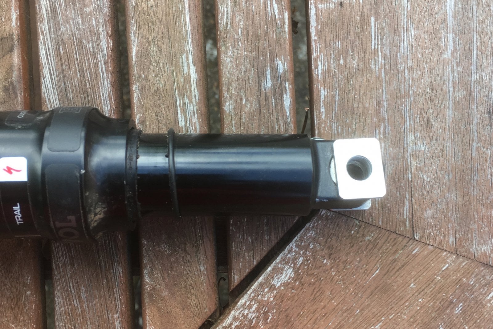

OK I just did the flip. I followed this video.
It's a few minutes job, you need a workstand, 5mm hex key, a 6 mm hex key, a torque wrench for those, a rag. I also let all the air out of my shock first to make manipulating the rear assembly easier.
I started like this (not a great pic as I was photographing the chip not the end of the shock).
I took out the shock, the chip at the end was orienated like this:
Here are the chips removed from the shock - top chip half at the top of the photo.
here they are rotated 180% in the horizontal plane:
here's the shock back in the frame - the end of the shock now extends well beyond the high mark and almost to the low mark. it's moved in the direction you'd expect given the mounting bolt is now a few mm closer to the shock body.
conclusion: mine came from the dealer in high, I just set it to low. on a ride up the street it certainly feels more 'ground huggy'.
I'll give it a try for a ride or 2 but I'm more into flow than steeps so will likely switch it back.
This is an easy job, don't be shy.
