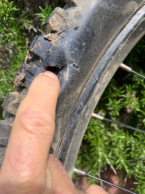

I've run tubeless for a long time, and they're pretty good with punctures. But you gotta keep renewing the goop. Not a huge deal, but I forget and with the CushCore, it's REALLY hard to get the stuff in the tire. My problem is rips from rocks. (See the picture in the above thread) I bought a DD Maxxis tire, and I'm gonna stay tubeless for now. BUT, the Tannus system makes the most sense to me because I feel it is PROTECTION as opposed to a bandaid after the damage. (SLIM etc). It also looks like you can ride it if you do go flat... All that said, I'm lazy and not so mechanically inclined... so the install intimidates me. (I have the bike shop put on my tires)
