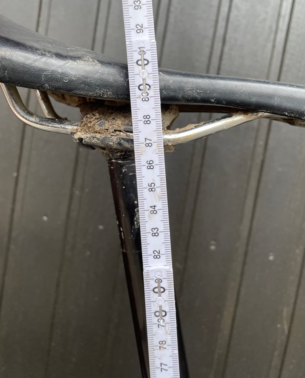

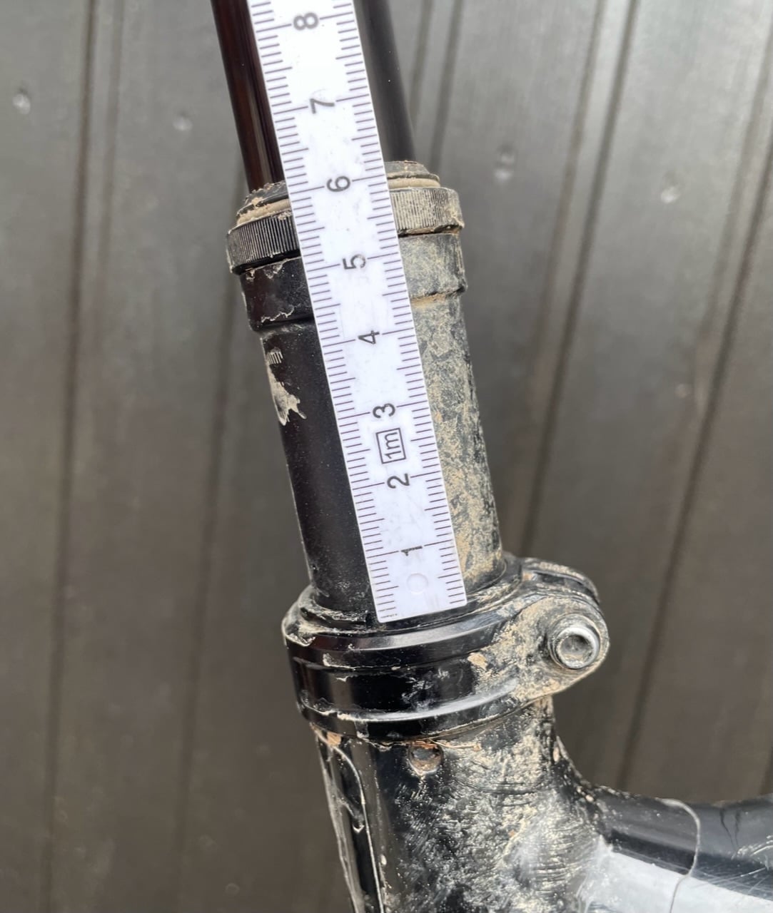

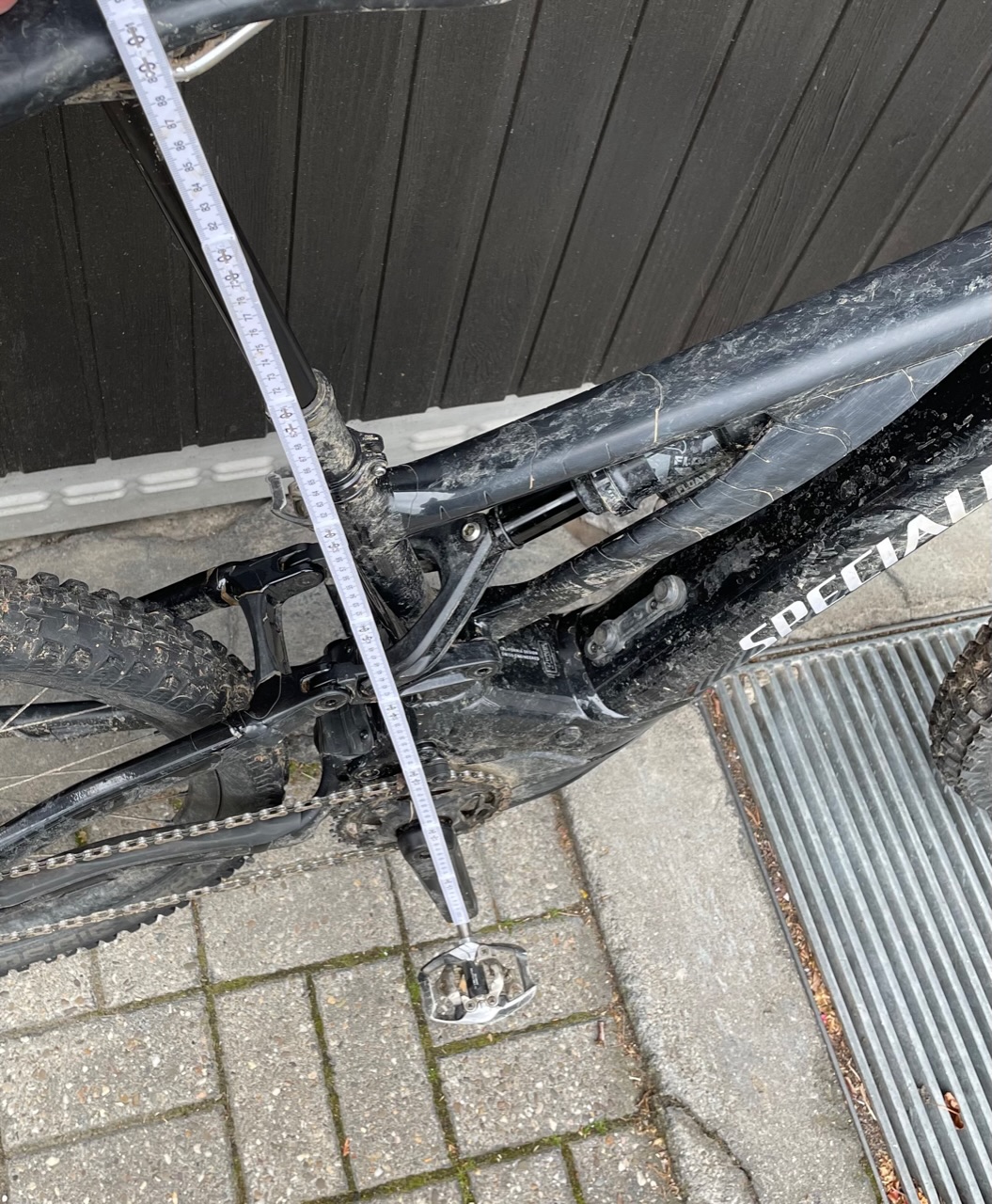

I only have this pictures after a muddy ride. I‘m using SQLab saddle instead of the stock specialized one.
