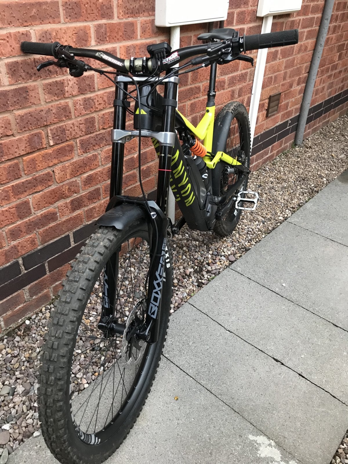

Fitted some 200mm boxxer debonairs

looks good - did you make any other changes - smaller front wheel etc to compensate for the much slacker head angle woth that fork on? will be good to here how it rides , im considering the same for my mondraker e crusher

Yes i went down to 27.5 its worked well bb height is the same give or take a mm the ha is about 0.8dg slacker now 65.4 in low, i had to buy a 20mmx110 front as the axle is 20mm also i need a hope steerer reducer £10 as the steerer come standard 1 1/8.

Looks radical! It seems to me that the crank arm support of the shimano motor will be the weak link on this setup. I guess it was not designed to withstand the impacts that a fork like this can take.
