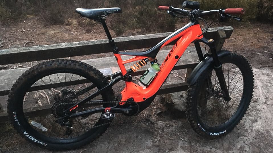

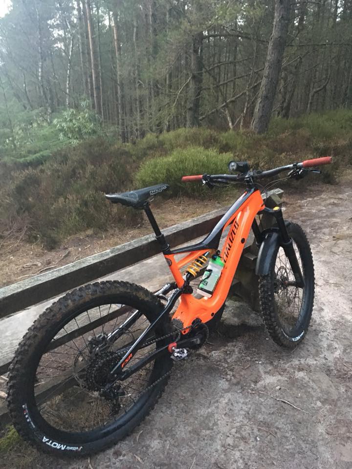

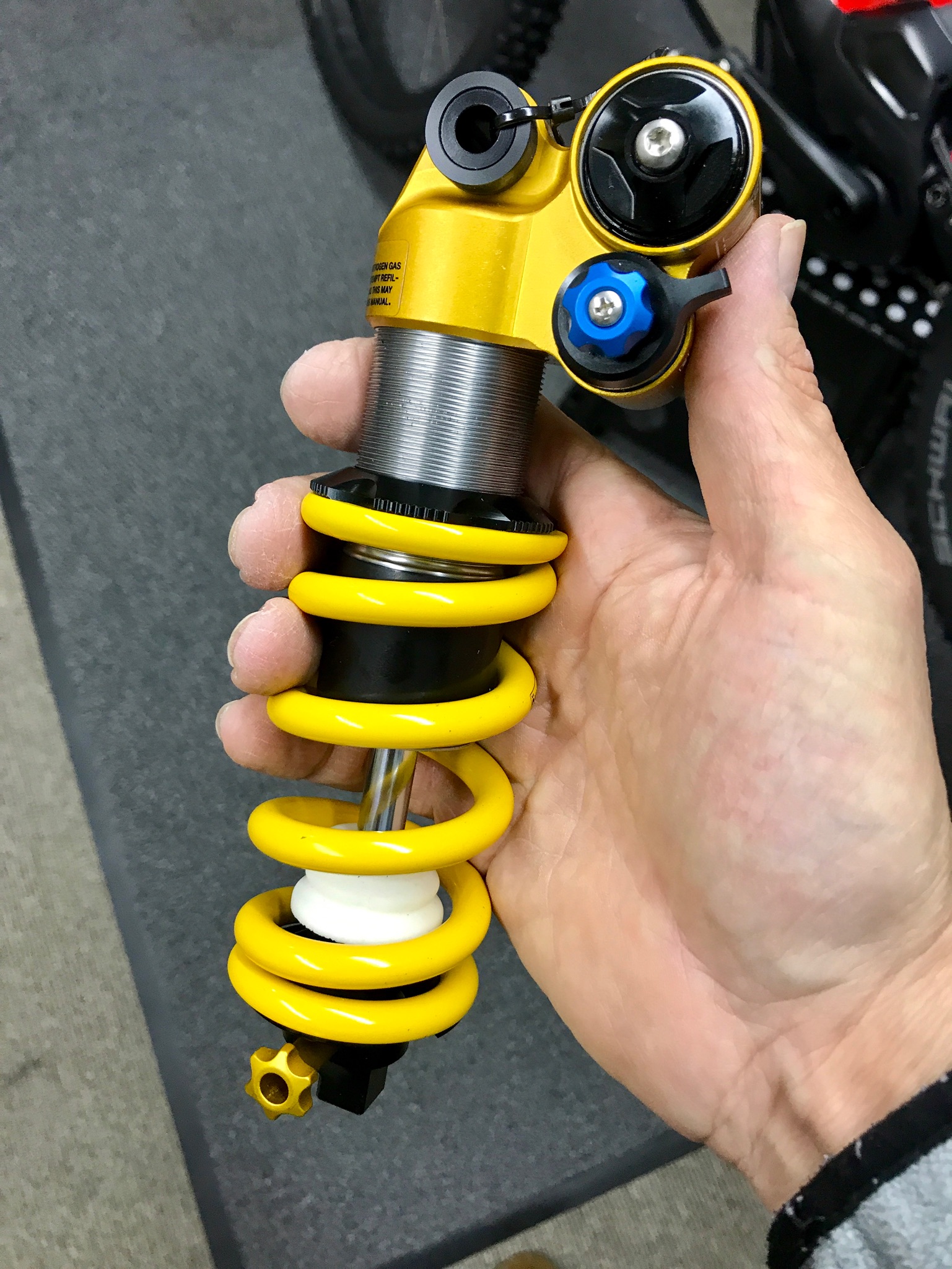

First ride on the Öhlins TTX Coil shock
James_MTB
Jan 15, 2018
290
267
Obviously, the trails came alive!
The shock is very very smooth and an absolute joy to ride.
I didn't get on with the RockShox Monarch RT3; it wasn't as good as the Custom Fox Float Factory DPS (from the previous years model).
The fork feels completely different; its way more balanced (Ohlins Air converted to 160mm). I know the travel hasn't increased, but the ride is completely different.

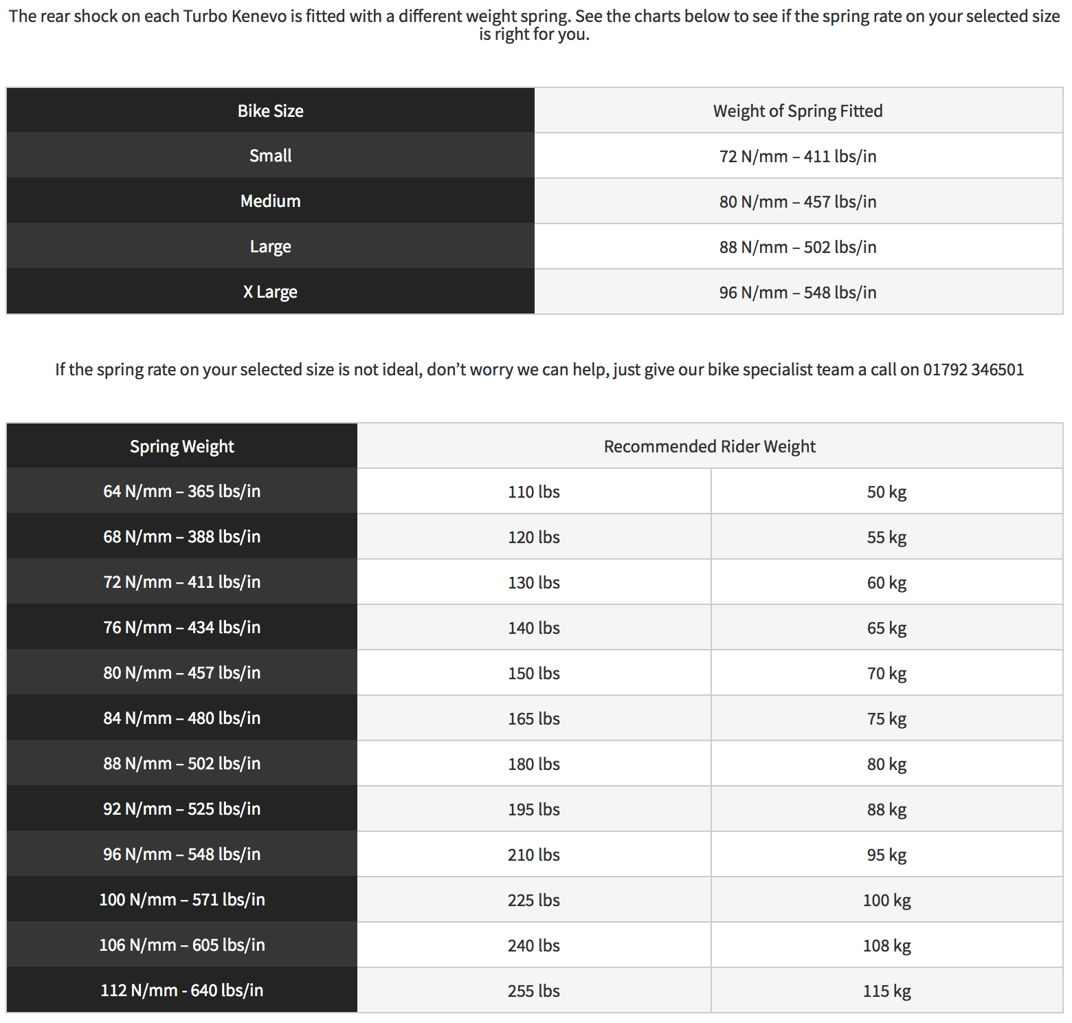

Having never run a bike with a coil shock before, do you set up sag the same way as an air shock, or is it all managed by the spring, based on rider weight ?
Which brings me onto my next question, I'm near on 18 stone (fighting weight!), anyone know if the Ohlins that comes on an 2018 XL Kenevo would be sufficient to support my timber ?! :unsure:
I know Rob tested an XL one in his excellent Youtube updates, but he's a LOT light then me!
Thanks...!
James_MTB
Jan 15, 2018
290
267
Managed by the spring based on your weight; make sure you wear ALL your riding kit before getting on the scales.
Your LBS will sort the spring for you
SteveVentoux
May 13, 2018
174
152
Bucks
Thanks James...had a bit of a dig around and found this handy chart on the Tredz website, seems I would have to get a different spring fitted from the stock one...or lose 3 stone :D

Hi, thinking of getting one of these shocks for my 18 levo. can you elaborate on whether the extra 1.5lbs of weight from the shock was even noticeable? Also, what pound spring did you go with and do you ride aggressive(jumps, drops, etc) or just singletrack talked to a rep at ohlins and he recommended a 571 spring for aggressive riding my rider weight is 182lbs thanks!
