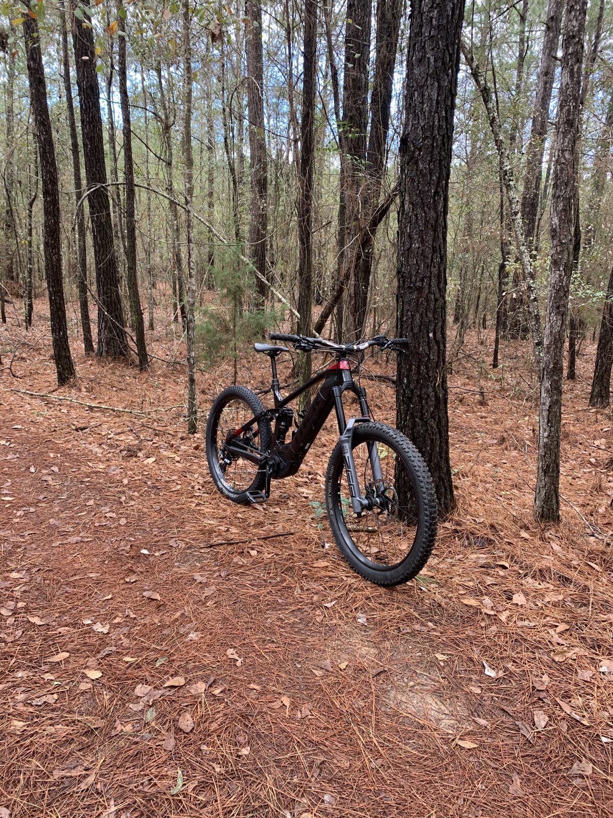

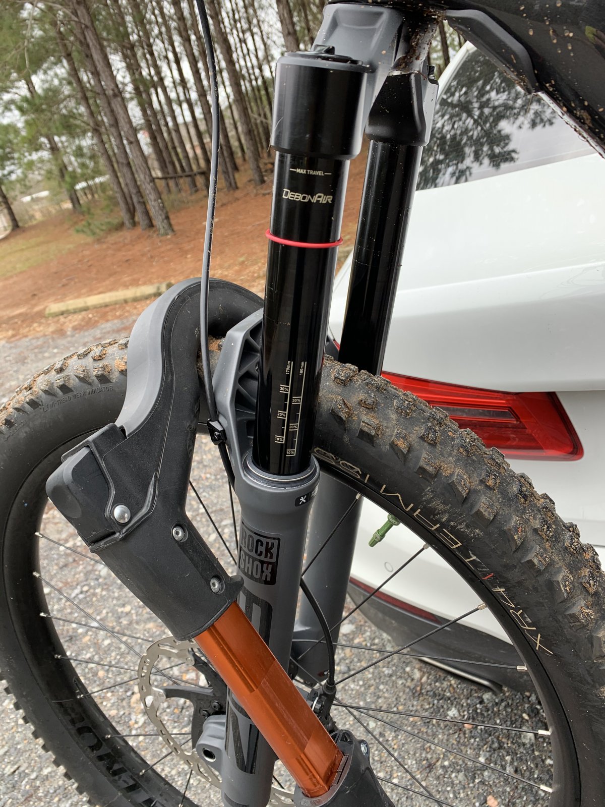

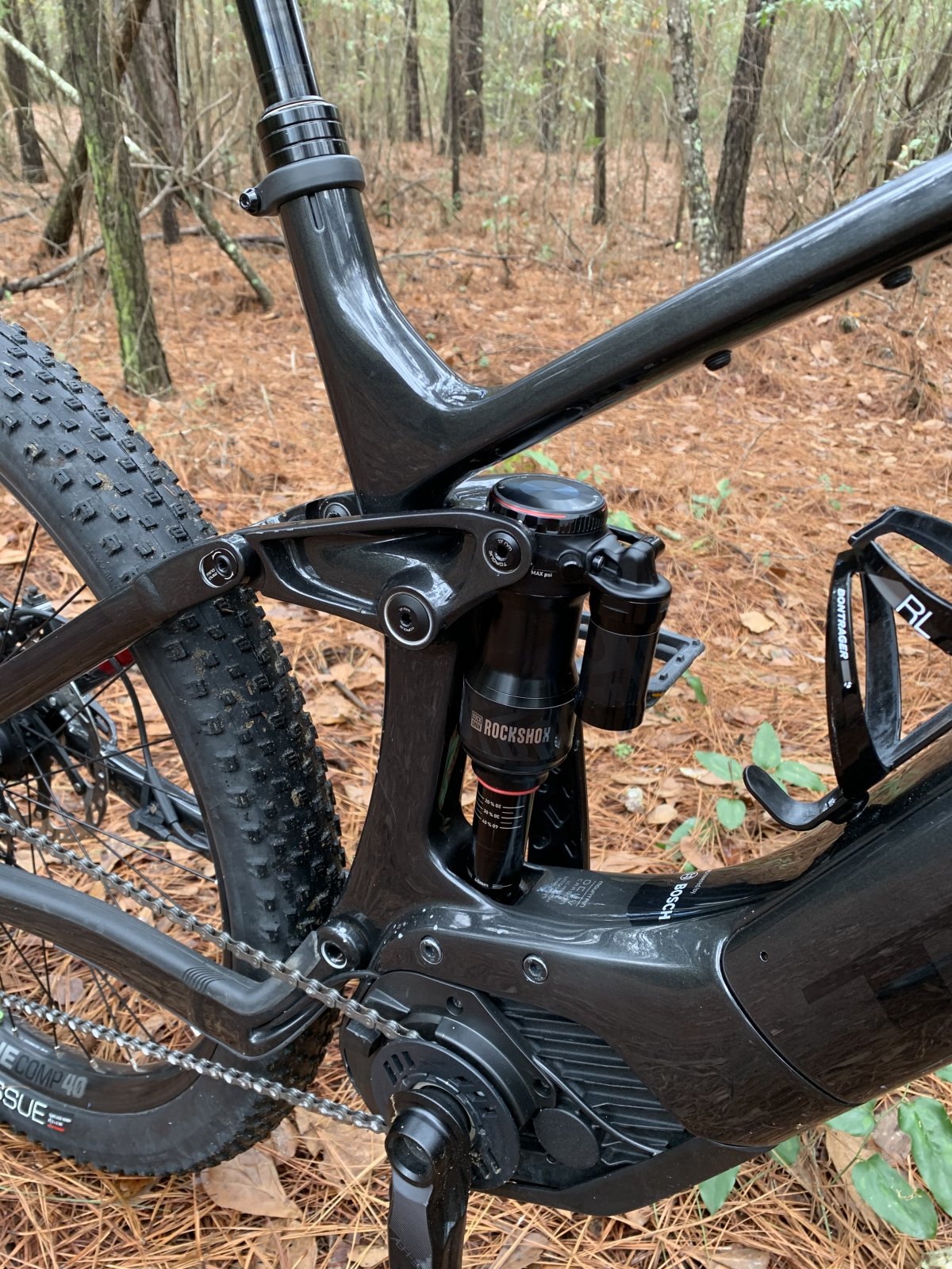

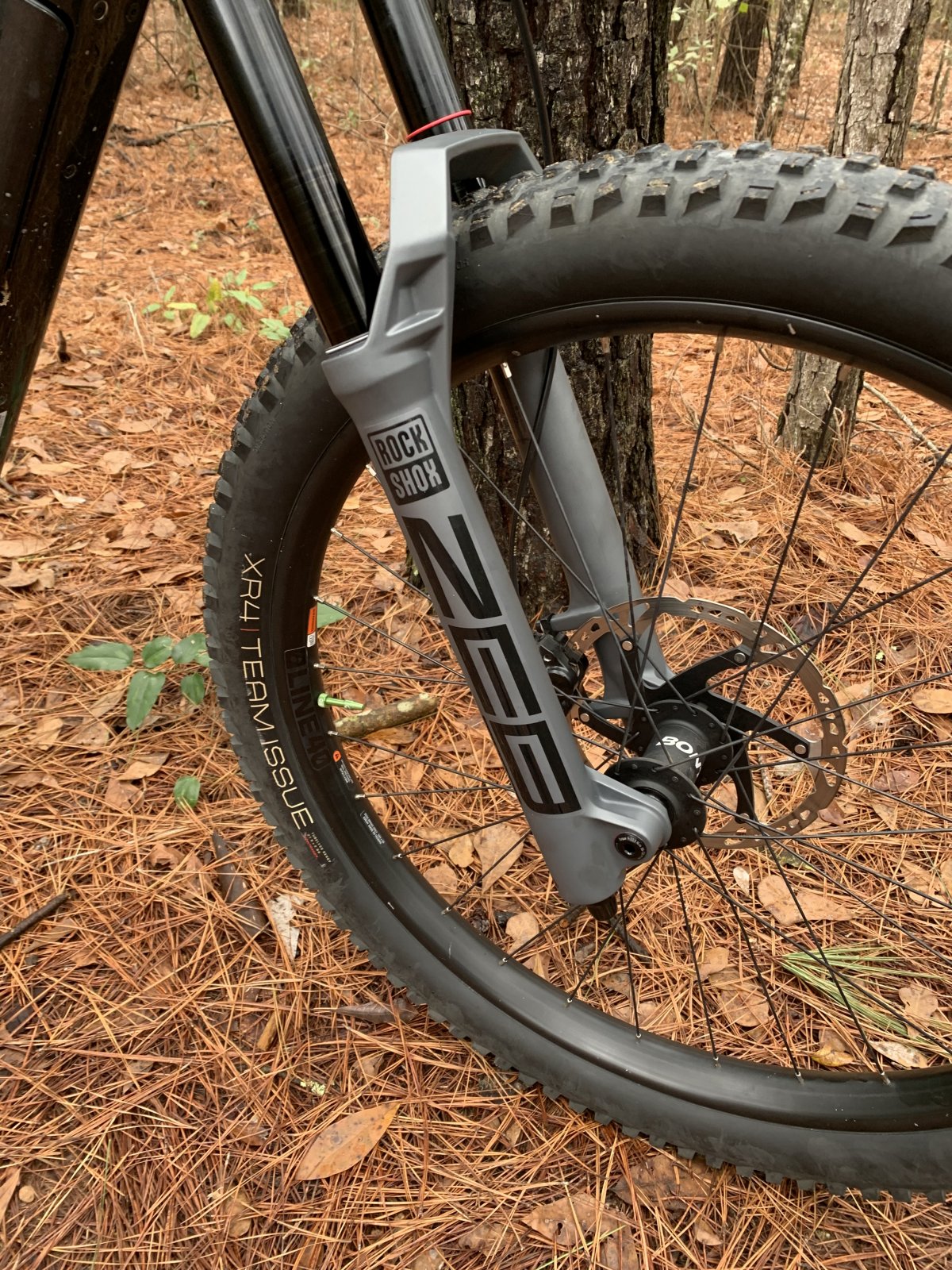

Replaced my Yari 160mm motion control with Zeb 180mm ultimate. I switched the minolink to “high” to minimize effect of over forking. I replaced my Deluxe RL to Super Deluxe Select+ with MegNeg.
Fork: I installed two volume spacers and running air at 80 psi (10 psi lower than recommended for my weight 100kg) -5 rebound.

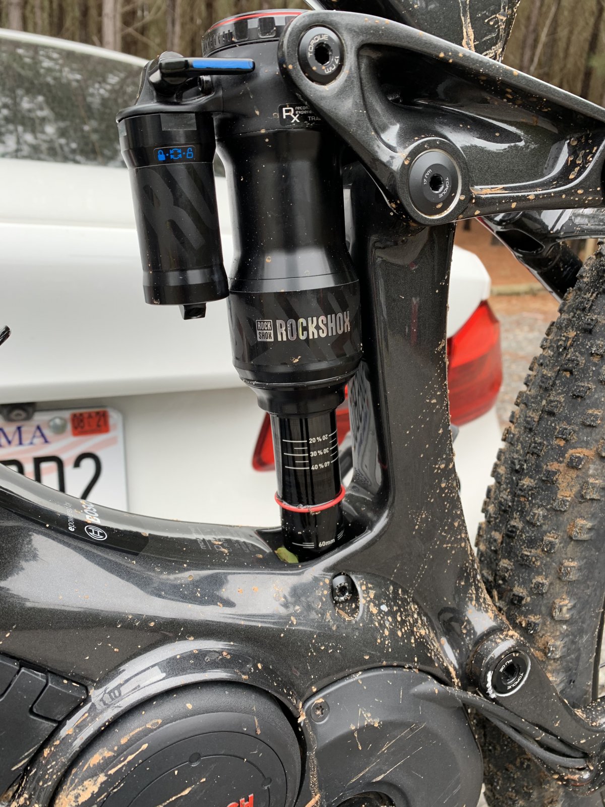

Shock: I’m running two spacers and two bands at 275 psi -5 rebound.
Tires: 27.5 2.8 with cushcores set at 20 psi
The trail was super wet and slippery and could not really get as aggressive as I would like.
My first impression, Wow! Super plush and great mid-stroke support. Another interesting thing, I was surprised at how quiet the fork and shock were. Hard to describe but everything felt muted. I love the feel of the bike.

what size frame do you have? I read that this shock’s chamber was to long and hit the downtube on full travel.
Does have enough space at full travel

Good stuff. Those Zebs look good! I still can't get over how amazing my forks feel after changing the damper to a lyrik spec - you'll find the harder you punish them the better they'll feel.
