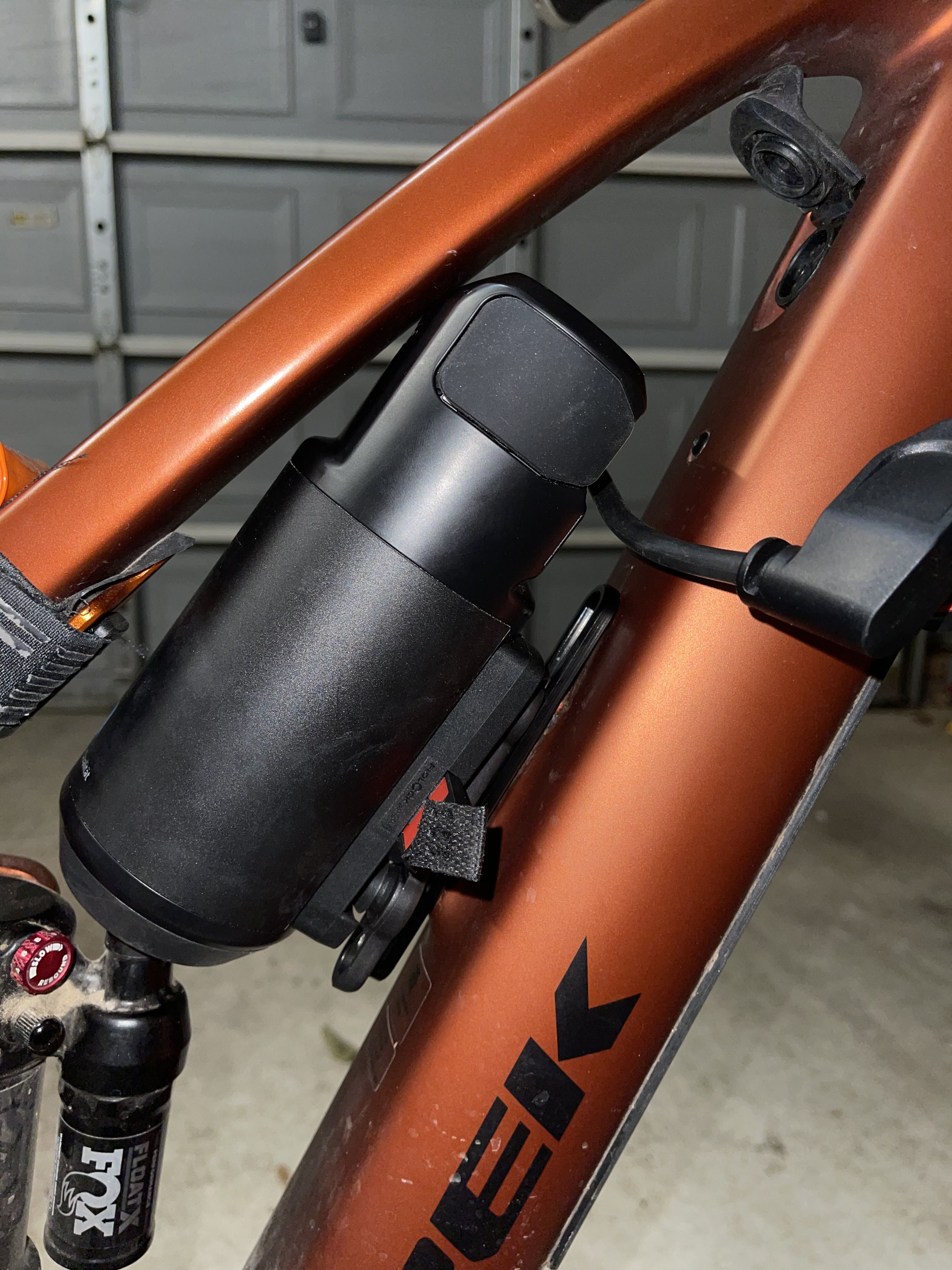

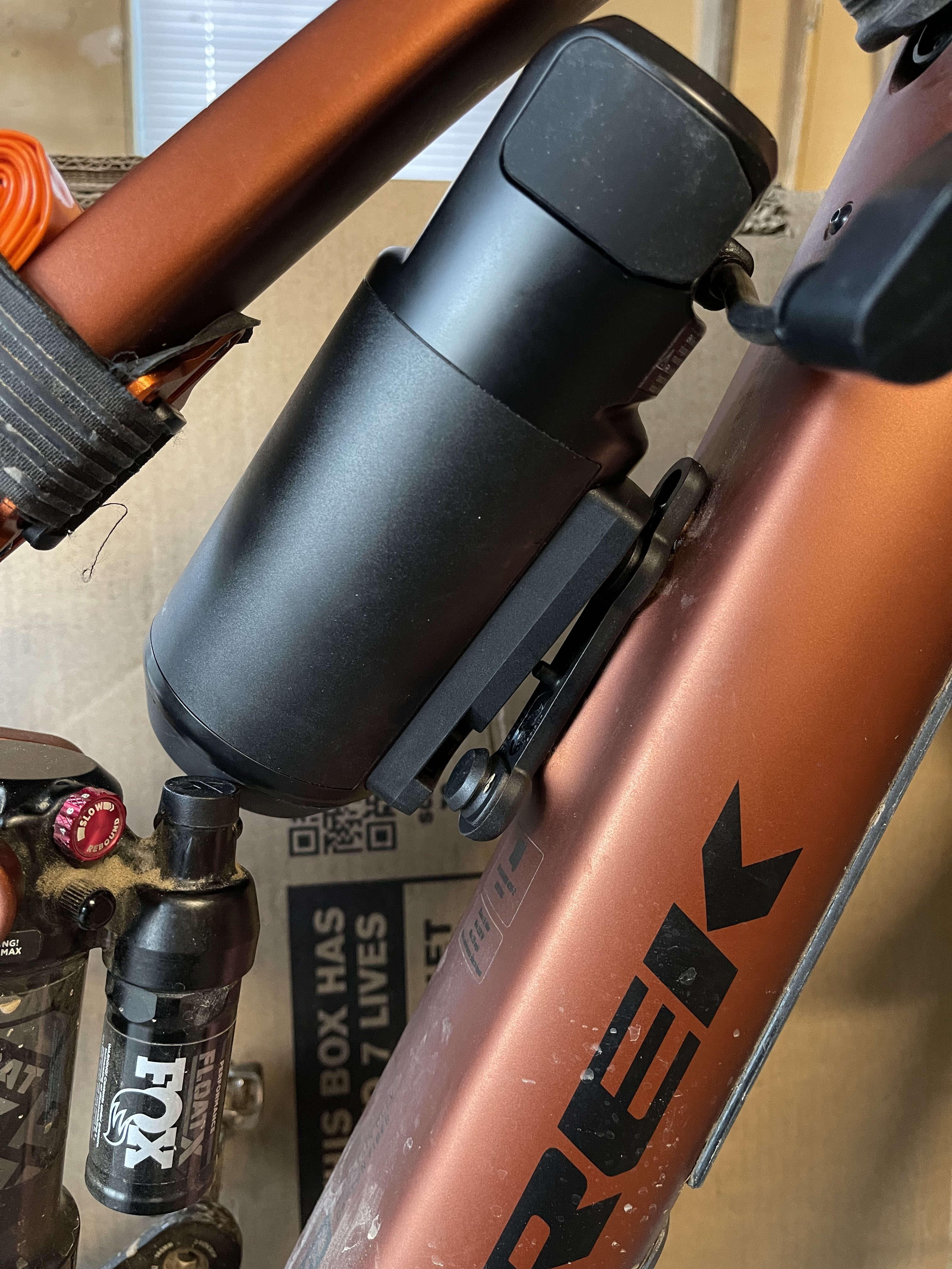

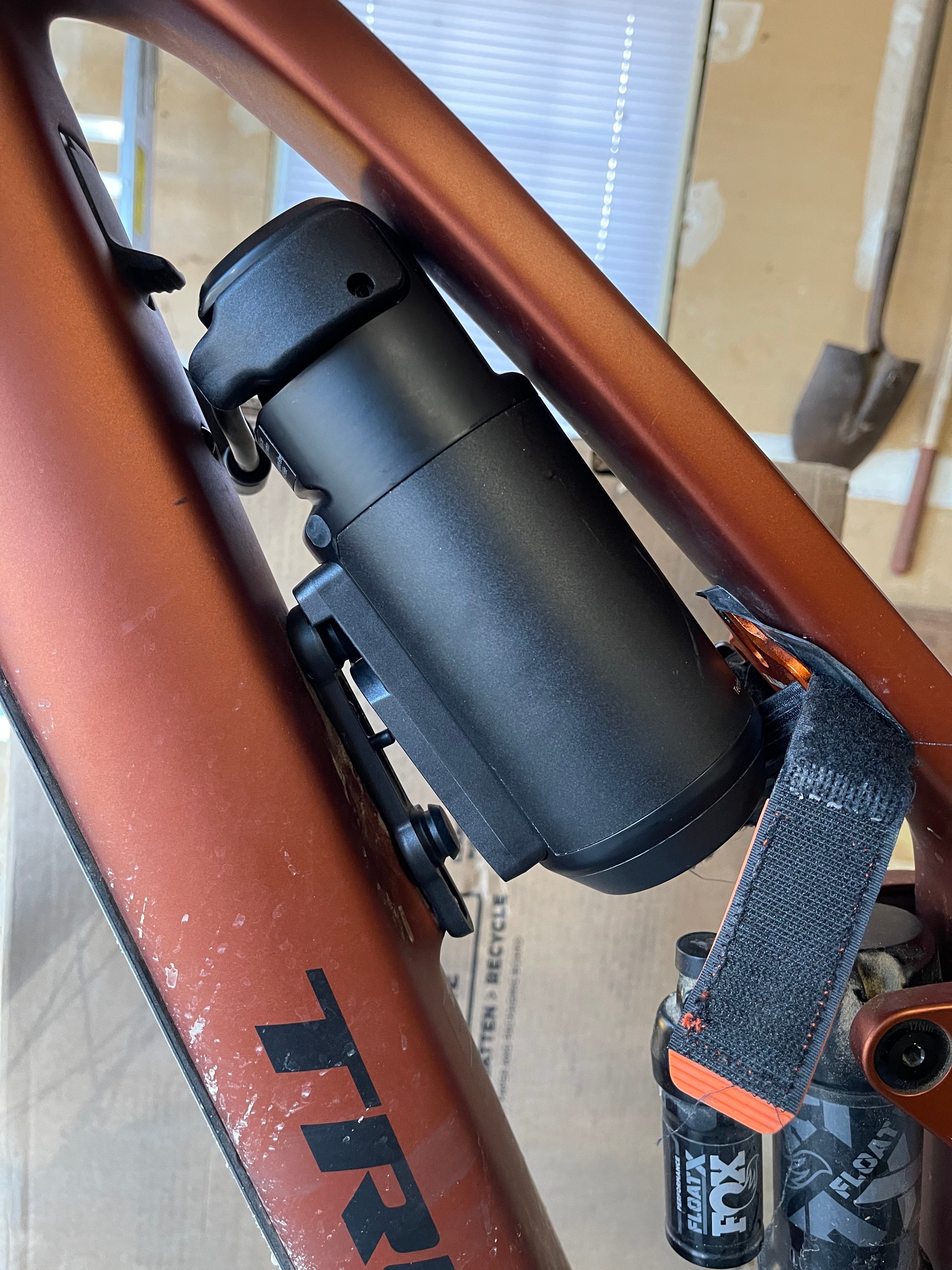

The Fidlock mount for the range extender (RE) does NOT work on a small EXe frame. The top of the RE pushes against the bottom of the top tube, pushing the RE cockeyed against the top engagement point of the mount, using it as a fulcrum, and away from the bottom engagement point of the mount.
Turning the Fidlock mount upside down puts the RE too low and it hits the shock.
This adapter https://a.co/d/iz5orXJ raises the Fidlock mount as it lays on the down tube and there's not enough room for the RE to fit. There's no way to fit the RE without it hitting the bottom of the top tube or the shock.
This adapter worked https://a.co/d/8zon1BJ, but I don't how it'll work in real-world riding.
