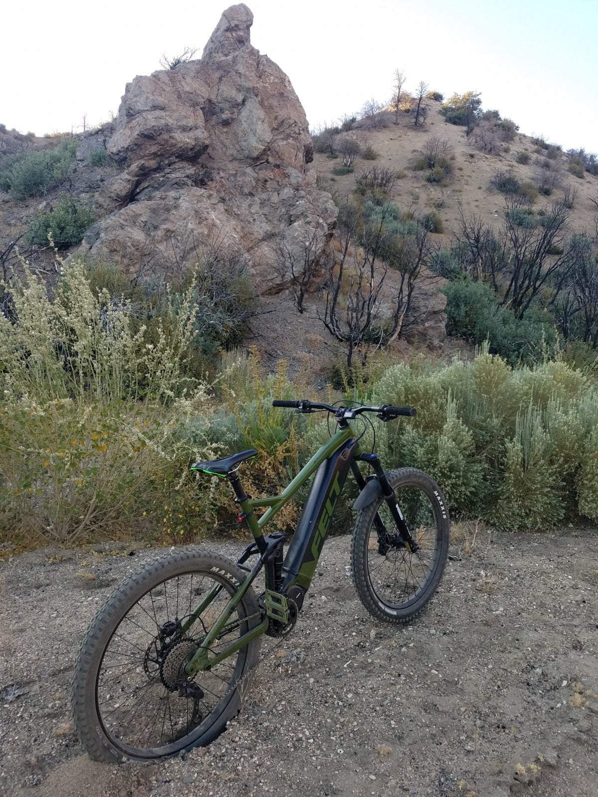

I have the 2019 E-50 and I love it! Such a great bike. I would love to see more tests on them in the magazines/online just to see if I'm missing anything from a more expensive bike.
I'm 6'3" and I have the XL (22"). I think the large will fit you perfectly.
A spare battery is a must if you want to go more than 30 miles in "trail" or "boost". I've been going down to "eco" just to get more range. I suppose that was the biggest disappointment, but one that I'm easily over since these bikes are so much fun.
Not sure about the 29" swapping over. The provided suspension is decent but I really want to get a triple crown fork on this bad boy!
