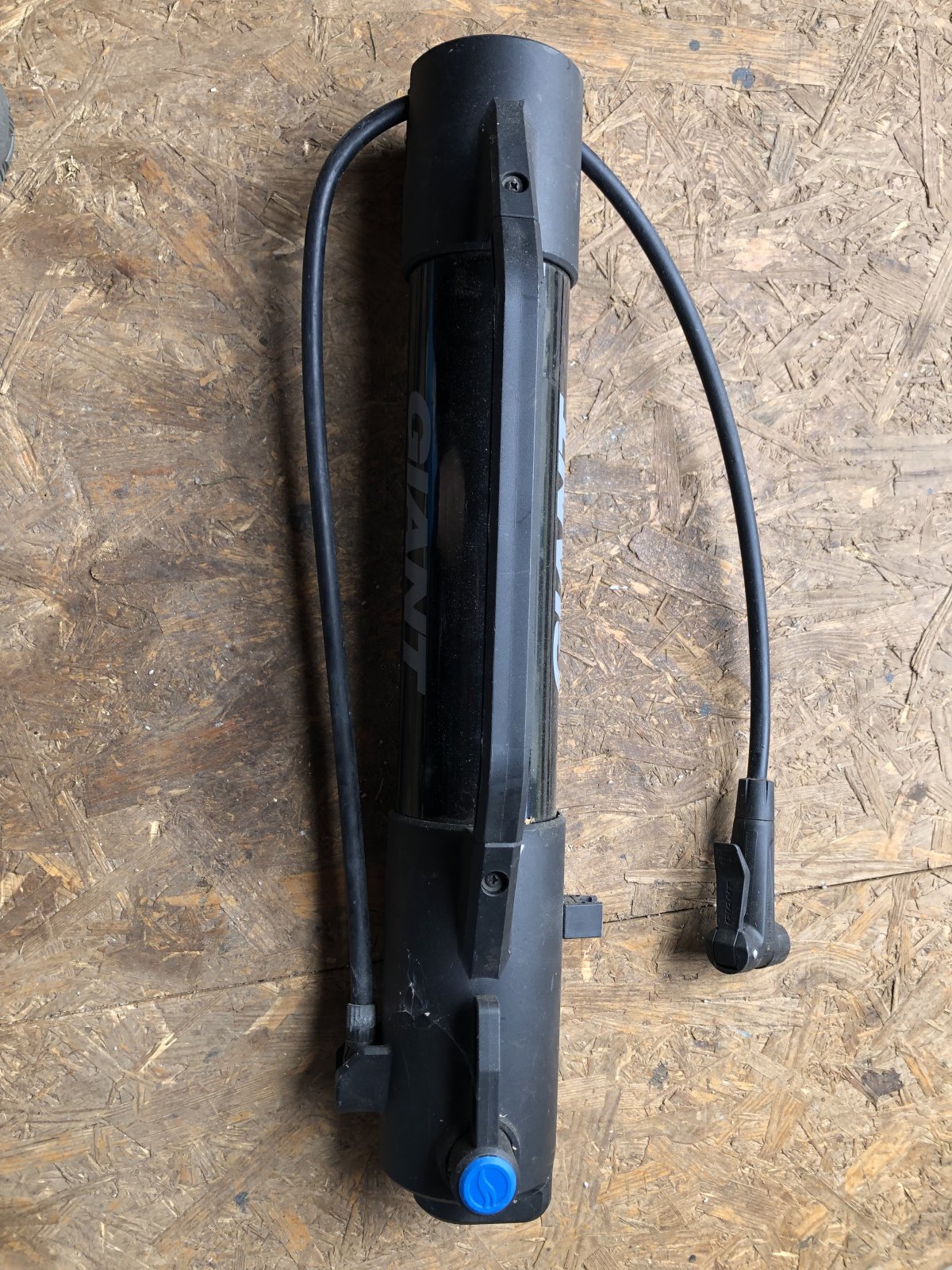

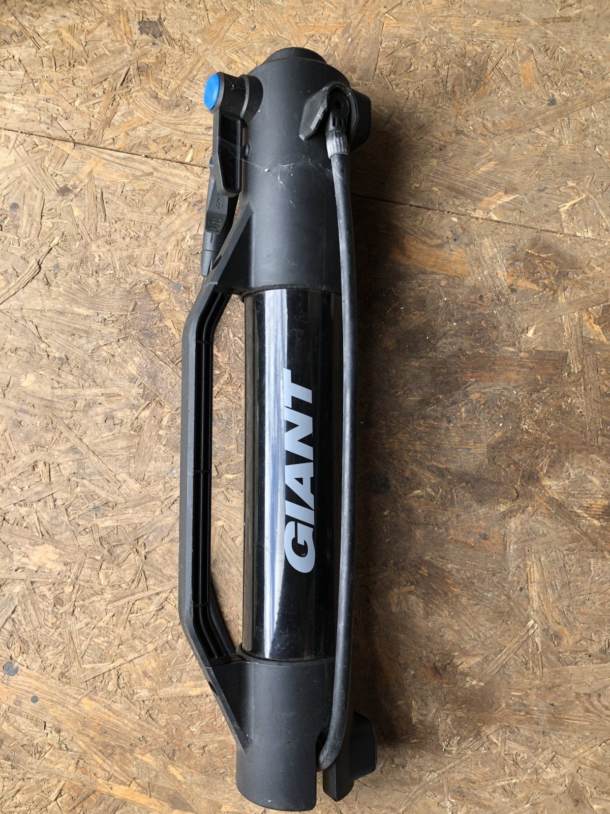

Hi, great advice above. Only thing to add is I had trouble when first getting into tubeless (then I had normal rims due to not being able to afford tubeless rims on my MTB) but Sept in Wales and Blackthorn hedge trimming was doing my head in.
always got leaks, some slow, some quick until I used this from Giant (only bought Giant as I had a Giant track pump).Pumped it up to about 100 psi. Let it go and the seals went bang, bang as they the high pressure forced the tire on the rim and the sealant did the rest. Also using gaffer tape now 76FDF90D-9B45-44F9-88B8-26BF67ACE4C3.jpeg
as the trim tape is marketing testicles.
Haven’t had a puncture for years. Only use the kit now when I need a new tire.
Remember in the early days getting some BMX inner tubes and trimming them off with a Stanley blade after stretching it-round the rim.
may be worth trying. Good luck.
