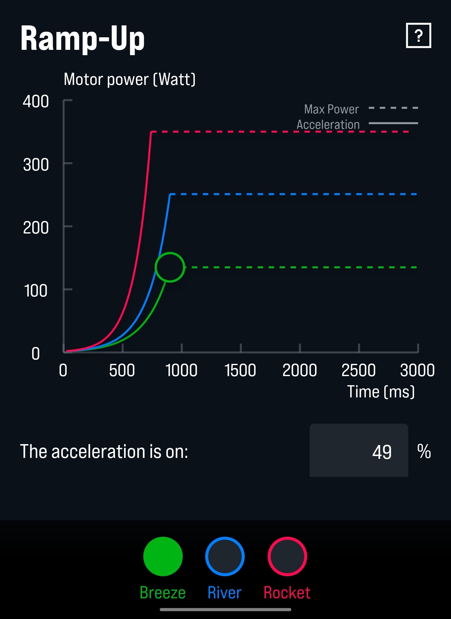

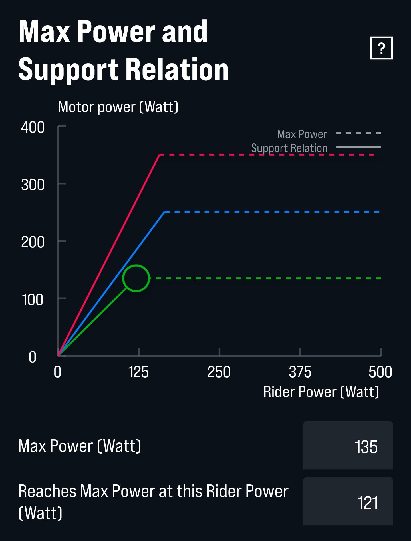

Anyway, here's my current settings in the Haibike Lyke CF11, mainly natural trails, with some bike park style stuff in there. I'm not based in the Highlands, so max elevation is around 450 metres here.
I keep it in Breeze mode most of the time with occasional bursts in River and Rocket when it's steep or I'm tired....
Screenshot_2023-10-04-14-04-56-08_6fe034b66d213069db7e8b3823411fbc~2.jpg Screenshot_2023-10-04-14-04-48-53_6fe034b66d213069db7e8b3823411fbc~2.jpg

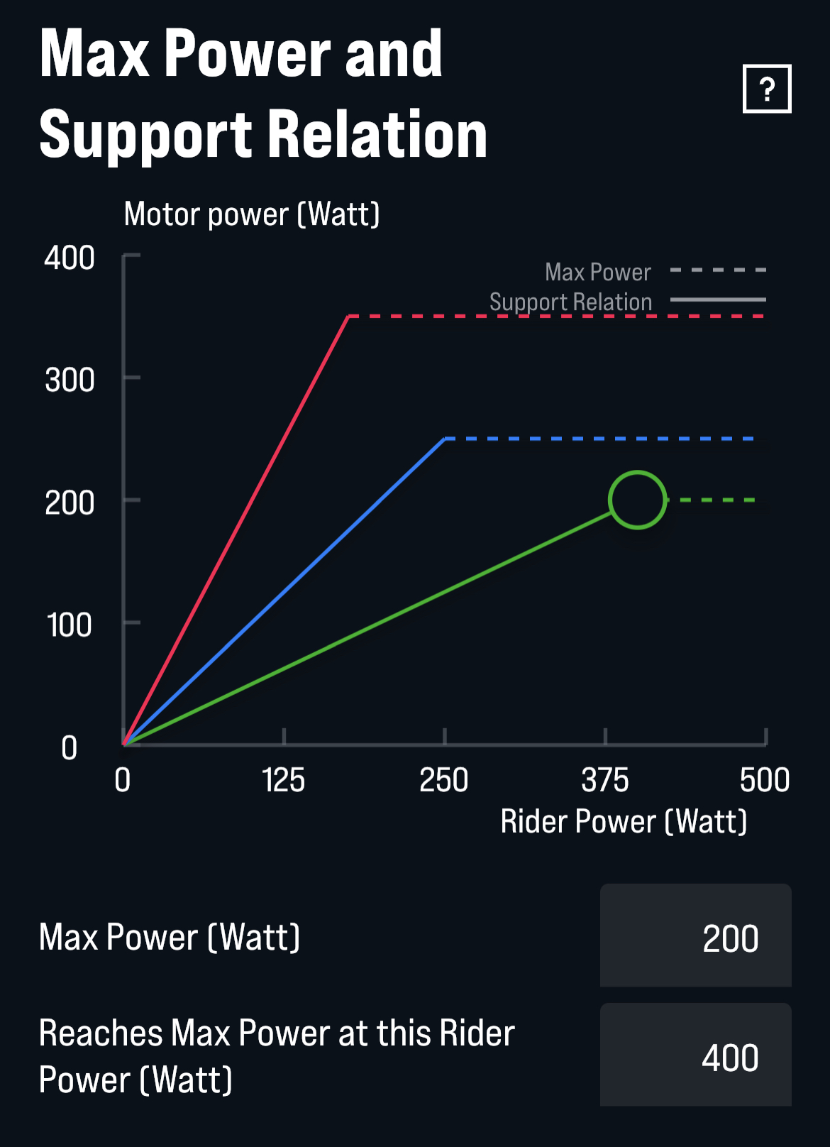

Running with this right now and actually quite liking it. Basic idea is: half my input power in Breeze, match my input power in River, and double my input power in Rocket. Capping at 200W, 250W, and 350W respectively. Not played with acceleration much, all are at 35% or 40%.

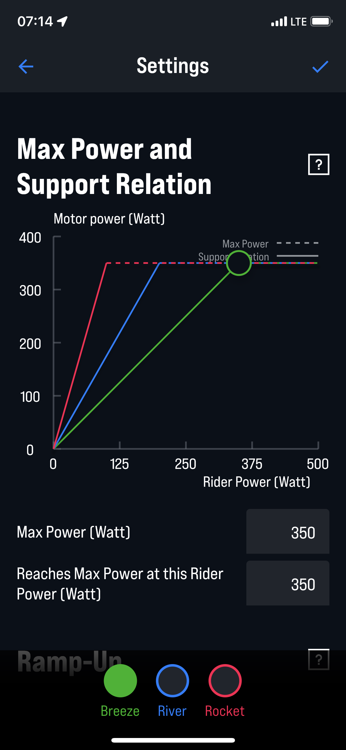

This is my preferred profile.
Basically, you can get full power in any setting, but low settings require a lot more effort to get the full power.
Breeze (low) setting requires 350 watts input to get 350 watts assistance.
River (mid) setting requires 225 watts input to get 350 watts assistance.
Rocket (high) setting requires 100 watts input to get 350 watts assistance.
Furthermore, the response level is adjusted in each setting with Breeze feeling completely natural and Rocket feeling the least natural (still not overly jerky).

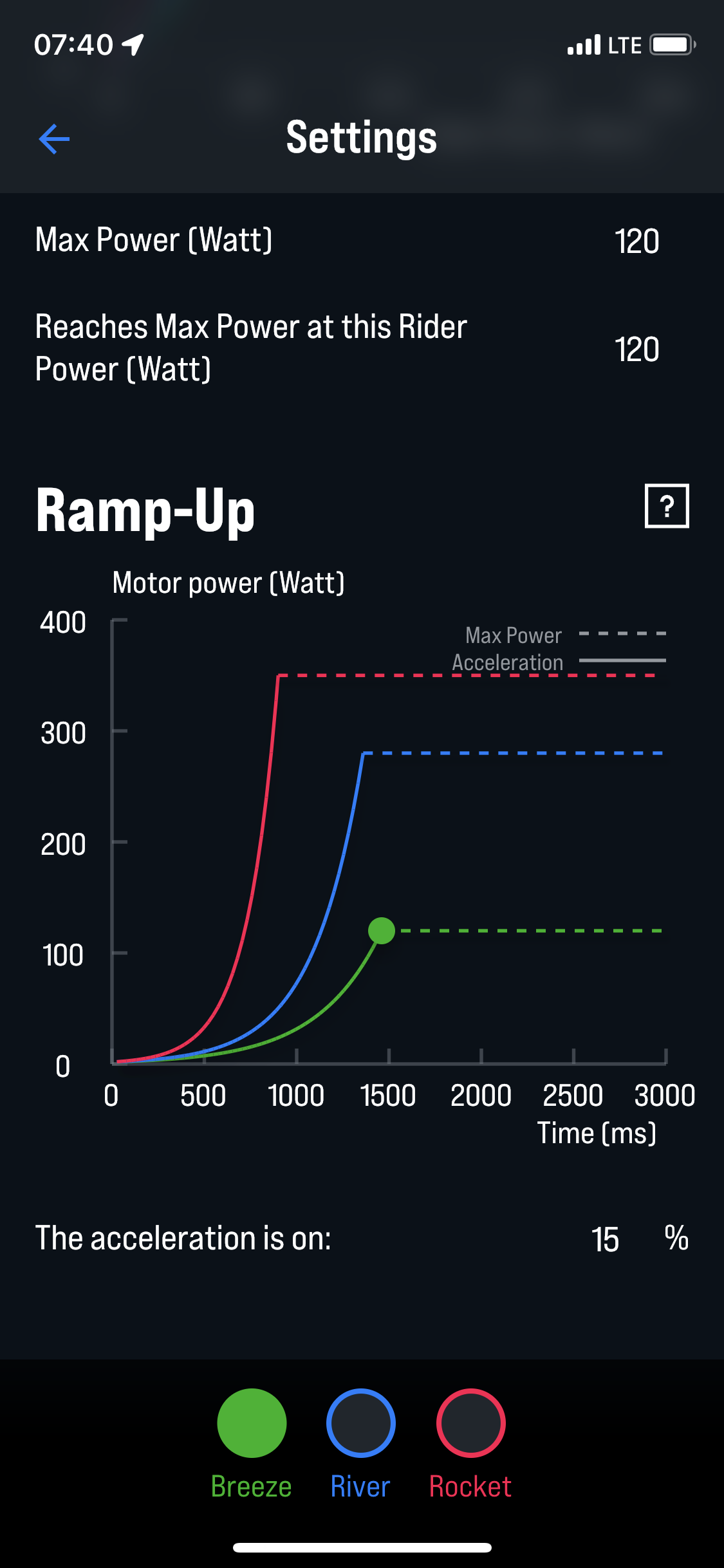

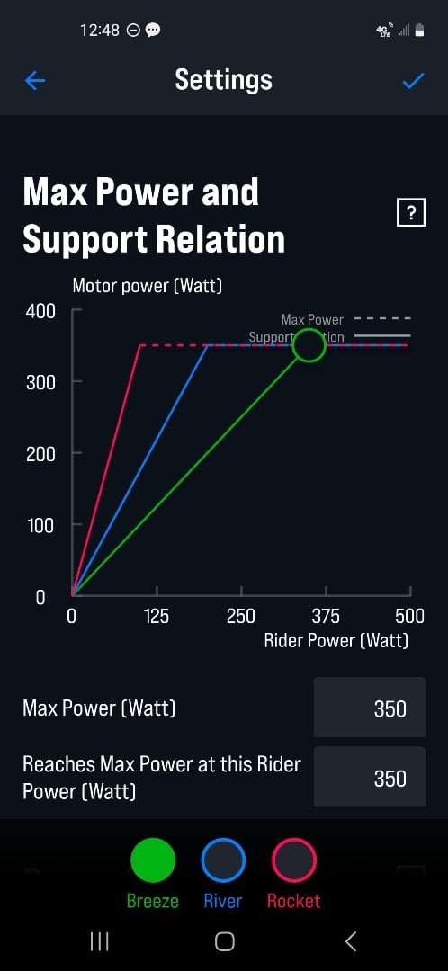

Here are mine:
Same as suns on the power side, recently moved my Rocket mode to ramp up as fast as possible. Everyone talks about utilizing all the different modes for different conditions or tailoring them to their desired effort. I pretty much only ride in rocket or with the battery removed. With battery I just want to go fast; it’s the dirt biker in me I guess. Also learning to use the power better in the tech, had a great time on Arab in Moab yesterday. Lots of punchy little tech moves that rewarded good timing with pedal assisted power.

I've been happy with the settings shared previously. Made some small tweaks to get Rocket mode assist with bit lower effort (350W by 160W input instead of 175W) and dropped the power caps on Breeze and River to 150W and 225W respectively. Part of my motivation for power capping is to ensure those modes get me more range independent of my input.
I also made a profile for "Acoustic" rides where Rocket is my 1:1 mode (rider:motor), River is 1:0.5 and Breeze is 1:0.33. Tested it out yesterday with a buddy and actually did most of the ride without assist (Heckler SL) with bumps into Breeze to take the edge off on steeper sections. Might make sense to go more aggressive on minimal assist for that kind of ride.
