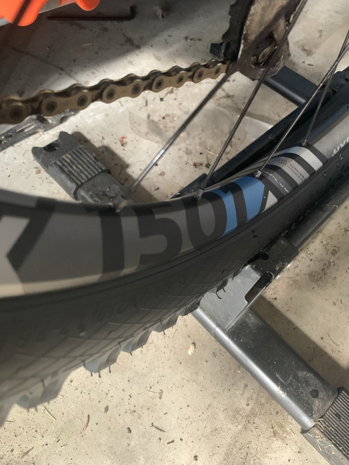

Got my 1501s just in time for my park visit!
Weekend saved

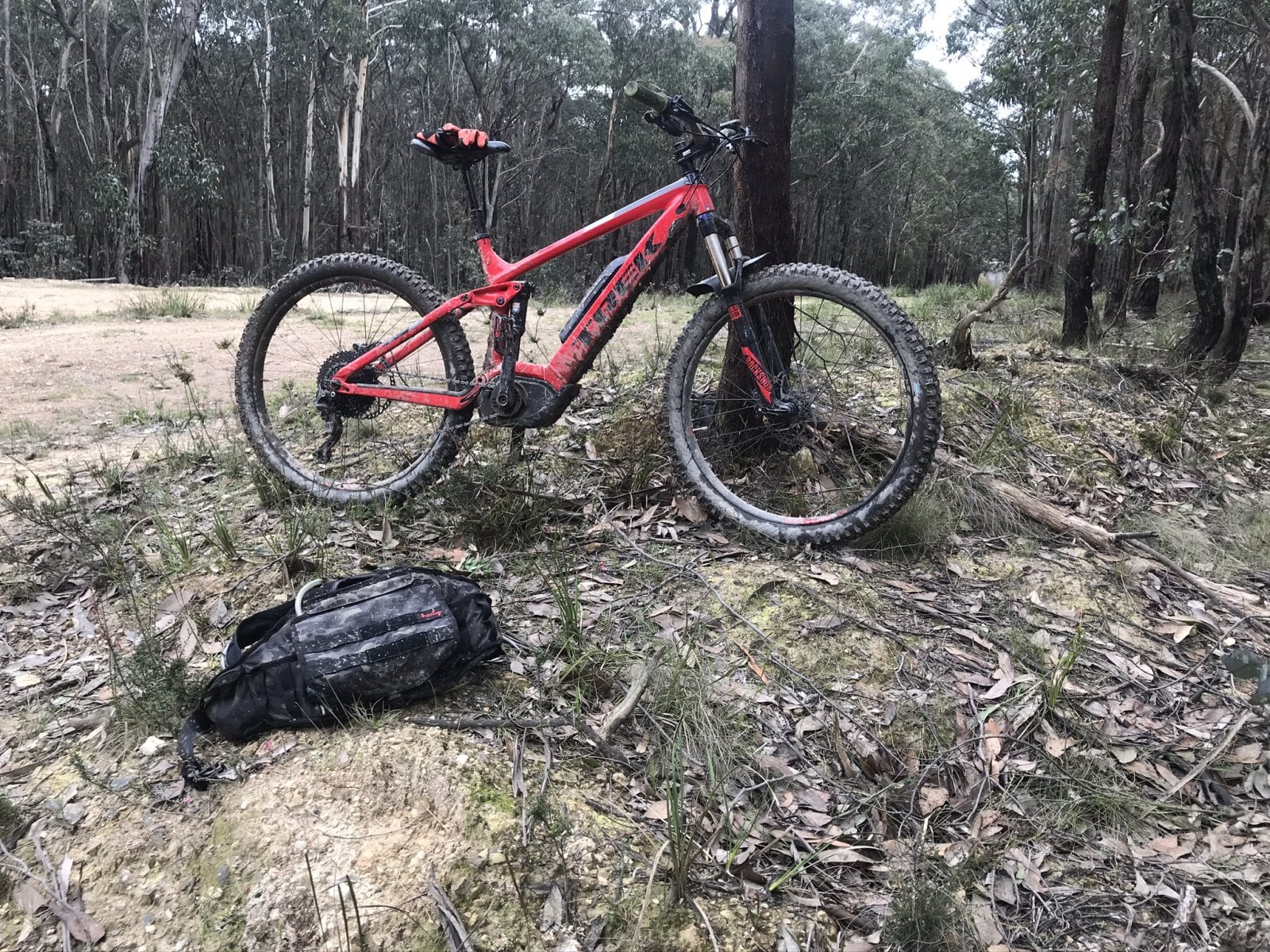

May I ask which Powerfly model you have?
It is not any particular model of Trek bike that is at fault, it is the Bontrager wheels in general. I do like Treks, this is my 2nd, all bikes no doubt have their faults, and Treks tend to deliver good bang for buck. But the Bonty wheels are not fit for purpose in my experience. The cheap alloy ones are soft and tend to break spokes. The more expensive alloys are still not that strong. Generally the freehubs on all Bontys are not very well sealed and require frequent servicing. The carbon rims are pretty tough, but still suffer from the same poor hub design - i.e. the centre is bonded in place. Seems like it can let go at any time - On my accoustic, I had 2 years and lots of kms out of my Line 30 Pro wheels before it failed. Seems like it is happening earlier on the e-MTBs, probably due to the extra torque/weight
Im in two minds - The Trek has been fantastic !
Would change some components - forks - upgrade to 36 ( i have had these rebuilt and can't really fault them to be fair )
i don't need more than 130-140mm of travel - but always nice to have .
Brakes maybe go to 4 piston - but again cannot fault the set on bike .
So , its really just the hubs .......
Any hoo - i have been eyeing off a Levo - but there is a bit of sticker shock - when i bought my bike in 2018 the comparable trek / specialised was around $7000 ( AUD ) now the price has risen to around $10,000 AUD .
Similar specced bikes , midrange equipment - still all brand name .
So, i m happy to stick with mine at present - i always vowed , ride 5000km and then see if you really want - not need a new bike .
Im not quite there , but prob just after Xmas - and its coming into 'our' riding season in Australia .
See how I go - with the riding , the economy etc , pricing may adjust after Xmas too - stock is very sparse i
at present .
All Good , I have a bike to ride !
