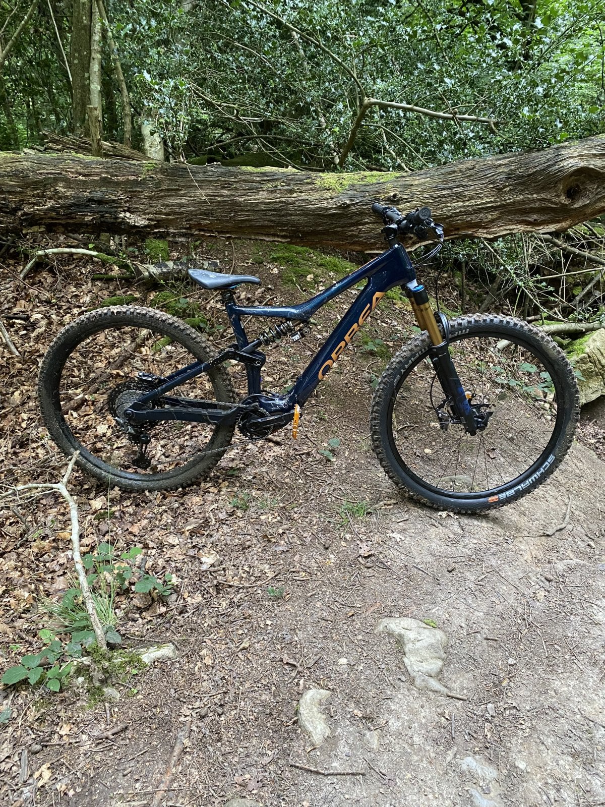

I’ve been looking into the storia v3 for an Orbea rise, the 116 is quite abit more expensive at £1300 I feel, I’m also looking at Ohlins. All that said seems even the DHXP performs well also.
Ive checked a few reviews and some say EXT and others say PUSH so maybe not much in it. I’d also been looking into Smashpot or acs3

So what are your initial thoughts?
I threw the new bike down most of the trails at Forest of Dean and it just soaked everything up, I seriously doubt I’ll switch back to air or even bother giving it more time, I’m really happy with the traction and way isn’t phased by roots and handles drops just fine. The lok function is nice, also Mojo are class the way they help setup everything
Given you get a heavier spring for trail parks etc I can’t see much logic in keeping the air, might as well sell it for £500 meaning the upgrade one cost £450 In the end….

Sorry meant to say only need 0.1k to notice the difference ??
I mean I could keep the air and try more but I don’t need any better/different to what’s happening, maybe an e pensive placebo ?
There is a big difference between monster truck tyres, coil or air…..the dissector/rekon with the air is the lightest combo and very playful, on rock gardens this combo felt easier to man handle or correct errors but the heavy MM/BB coil combo doesnt, the lines need to be picked a little better or you get weighted the wrong way quickly and it’s a little harder to shift things around…..when you get it right though, it’s right a lot better is my feeling so far
I went to stainburn with mates but my energy was poor today, bad nights sleep xyz and had 2-3 offs, nothing major but mistakes probably due to tiredness, I knew it was probable before hitting the double black rock gardens of doom ?
