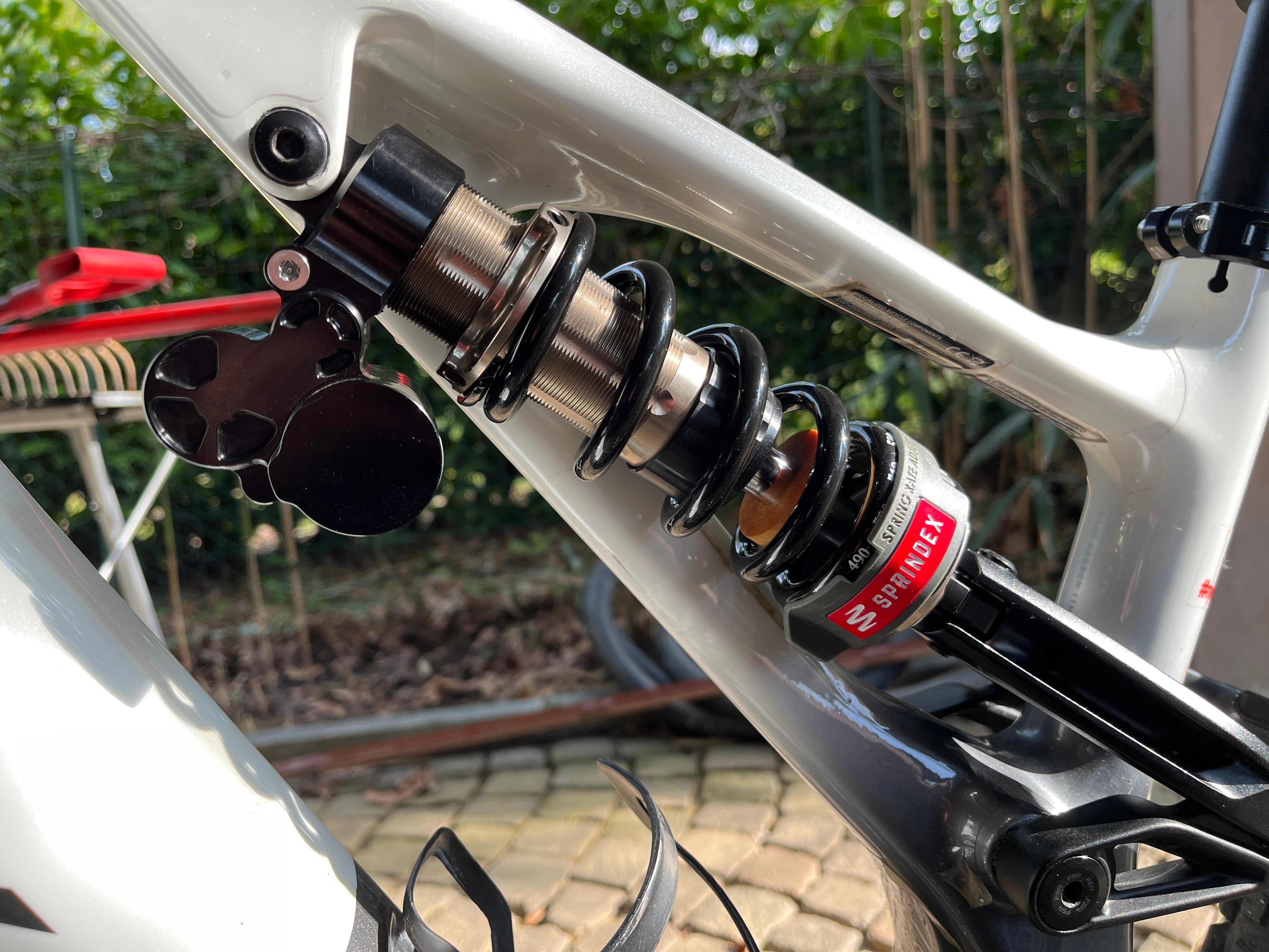

Hey everyone,
wondering if anyone has had a similar issue, there is a knock/clunk in the shock at full extension. For example, if I simply lift the frame or seat to allow full extension there is a clunk or knock sound, almost like the piston is having a harsh top out. It does it 100% of the time, whether I extend it fast or slow. It just gets louder if you go faster.
shock is new, literally installed it today. Hardware is new, bike is new. Everything is torqued and triple checked.
this is on a new ‘22 Turbo Levo with a new as well cascade link long shock kit. I installed a stock Fox shock and no noise so I know it’s not the link. I even reinstalled the EXT without a spring and it still makes the same noise at full extension.
I’ve probably reinstalled the EXT 7 different times today ruling everything else out I can think of.
of course it’s the weekend so I can’t call Cascade or EXT, but hoping someone here maybe has a solution :)
so much for a “custom” shock… :(

I just had the first ride with new Ext e-storia yesterday and had the same symptons. I was just about to check the rebound settings. Interesting post! Will report if I find something.

Please check this video first, especially starting from 2:27
Thanks, great video but unfortunately that didn’t help with this issue at all.
However I did snug up the preload collar a turn at its “over extended” length on a bike stand, never had to adjust preload that way before.
I was really hoping that was it when I watched the video, but nope, still exactly the same issue/sound.

No solution yet but wanted to provide an update, I’m still frustrated.
I’ve been speaking with EXT and they are saying it’s normal. Maybe so, but I still don’t accept it. Why is an expensive shock doing this, I can buy a budget, used, 10 year old shock that doesn’t do this.
I was told “this is inherent with the e-Storia and everything sounds normal to me.”
Note that a key highlight point on their website specifically says “Internal negative spring to avoid harsh top-out and improve bike platform stability”. Well it’s clearly useless at doing its intended purpose then.
Just to be fair, I haven’t actually ridden the bike with this shock yet, so functionally it may be sound. I have no comment or experience with its performance yet, maybe it’s epic! I dunno. But this knock bothers me for what I’d consider a high end shock. They did ask me to ride it and report back.
If I can’t figure it out and it’s an acceptable issue to them, I’ll be returning it and getting an Ohlins or something else built for me.

My ext arma, ohlins ttx and cane creek kitsuma coils have all knocked or clunked when lifting the bike. Never noticed when riding.
The only coil that didn't do this was a super delux.

When you set your preload, did you set it with shock installed on the bike while unloaded/full extension. That’s what the EXT manual/video recommends, I’ve never done it that way before.
Just checked and this was my error: I installed the shock when bike was hanging in the repairs stand but still there was room to tighten the preload. 🙈
Oh man sweet! Glad it was an easy fix for you!!

My lucky day. After examining it more closely, the fault was not in the shock, but in the Oneup post. It had so much lateral movement that it rattled when riding standing position and the saddle down. It has now been fixed, Cheers!
FirstAscent
Apr 5, 2023
104
141
Portland
Sweet, glad that worked out easily for ya haha! Thanks for updating
