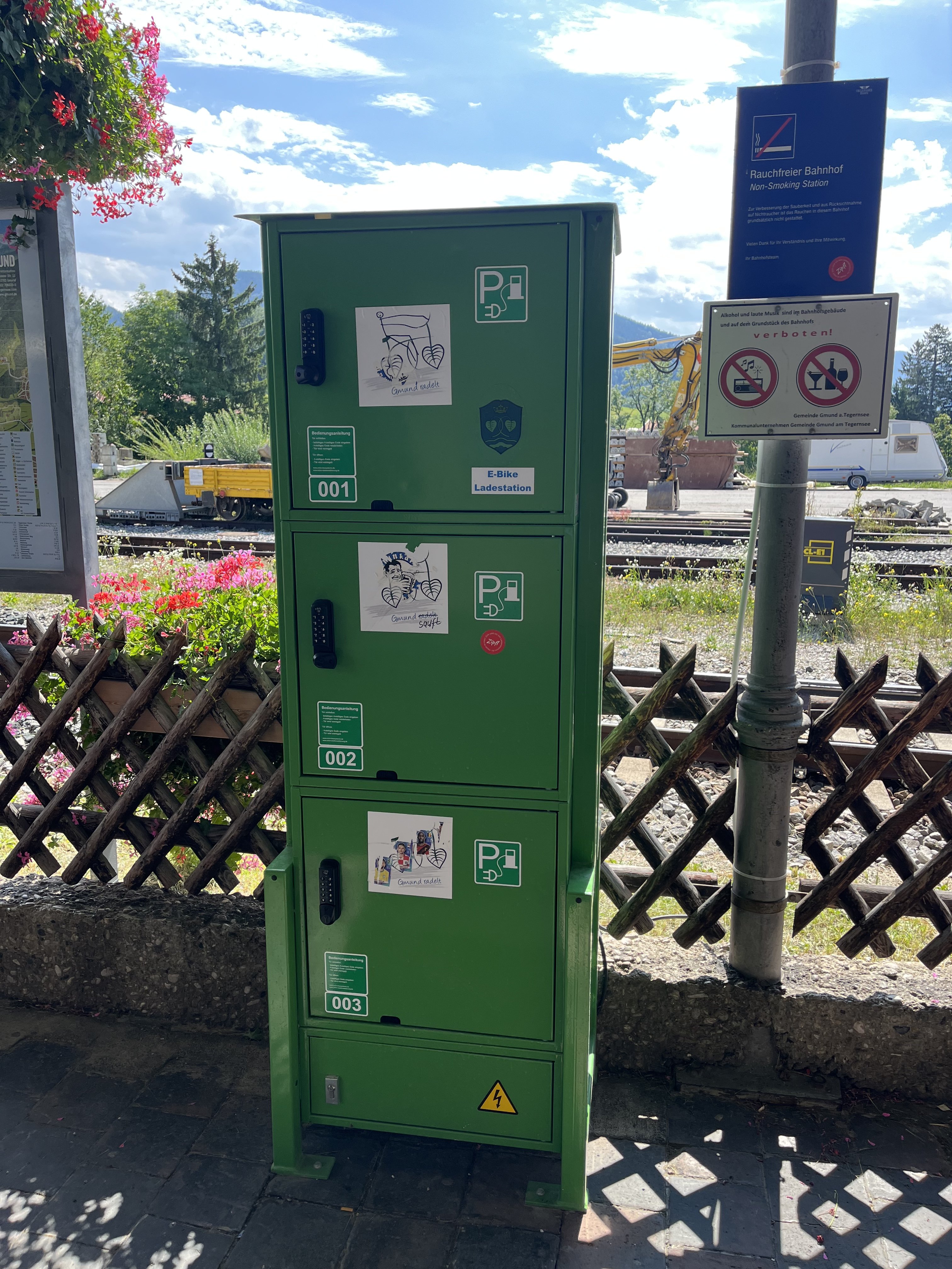

Was in Tegernsee in Germany last week and they have dedicated charging for e-bikes and it’s free!!
