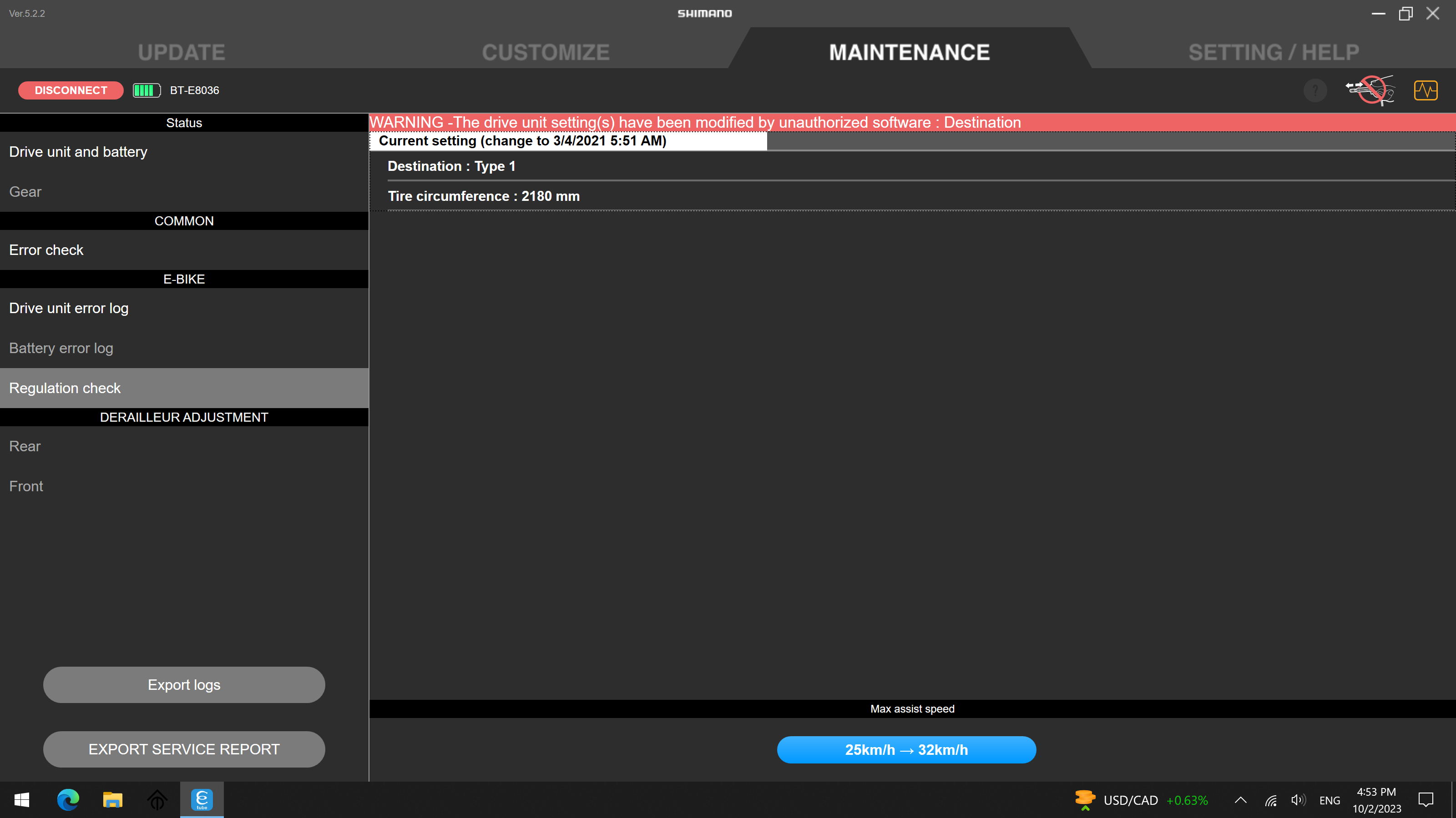

I wanted to have assist up to 32km/h, which turn out is not working good for me, so I did reverted back to 25km/h
I did that using eTuning | Ebike Tuning App for Shimano Steps Motors

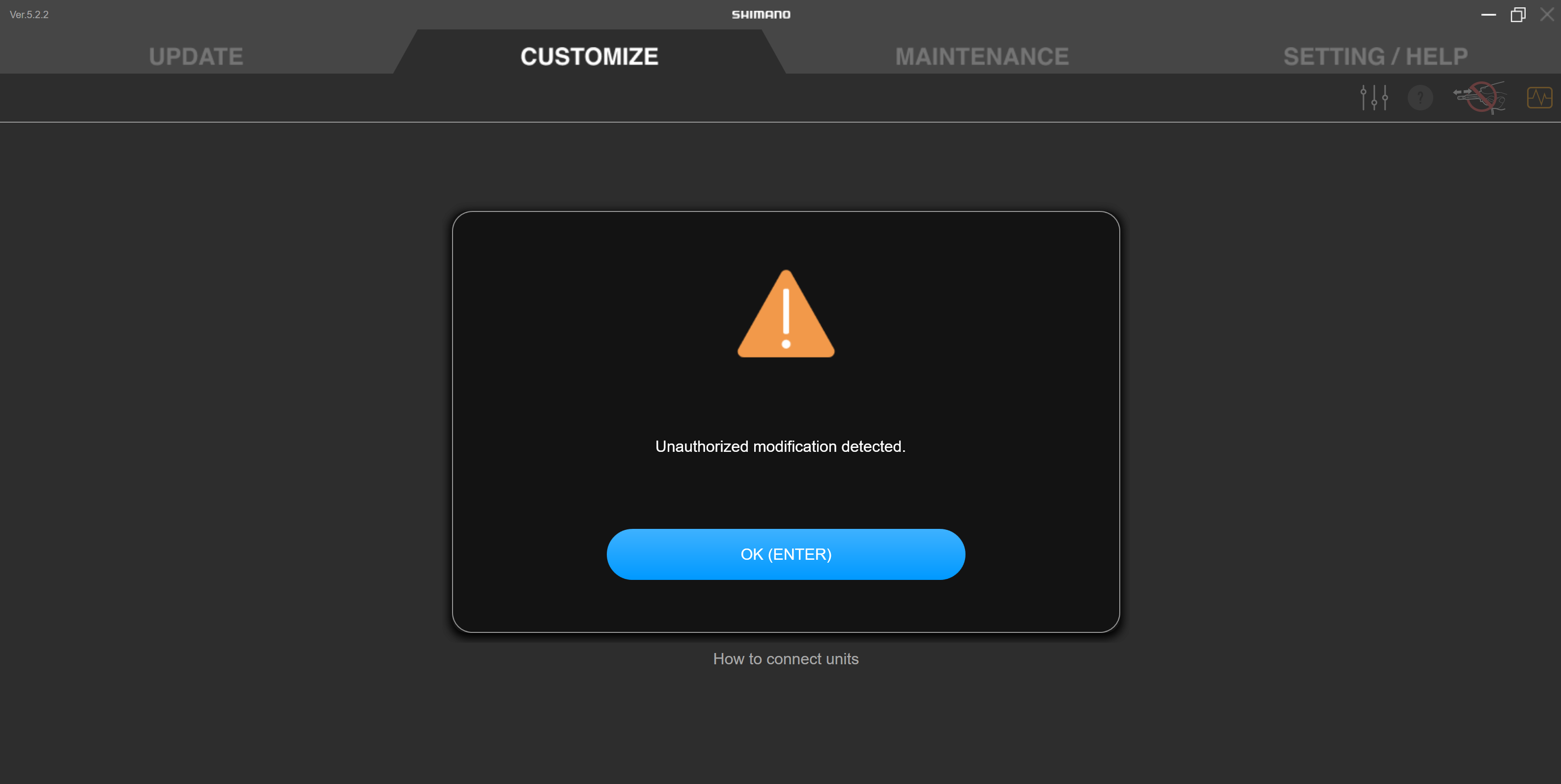

Now a days I got the original SM-PCE02(reasoning why got is bellow) and when I connect I got error messages "Unauthorized modification detected."
My question really is: is there a way to revert all to stock and remove that "Unauthorized modification detected." ?

Most probably your bike is still programmed to US mode (because you can increase max. speed to 32km/h like seen with the blue button).
You have to program it back to EU mode with E-Tuning app (and not just reduce the max. speed to 25km/h).

The red warning is definitely to the incorrect region / destionation setting, otherwise the text in the red warning would have be different:
If you read an analyse this red warning text thoroughly, then you will instantly see the reason for this warning: So, in this case it is "Destination". And yes, you most probably have to downgrade again, so you can reset the region / destination to the original setting. Don´t trust other "self claimed professionals" or rumours...
