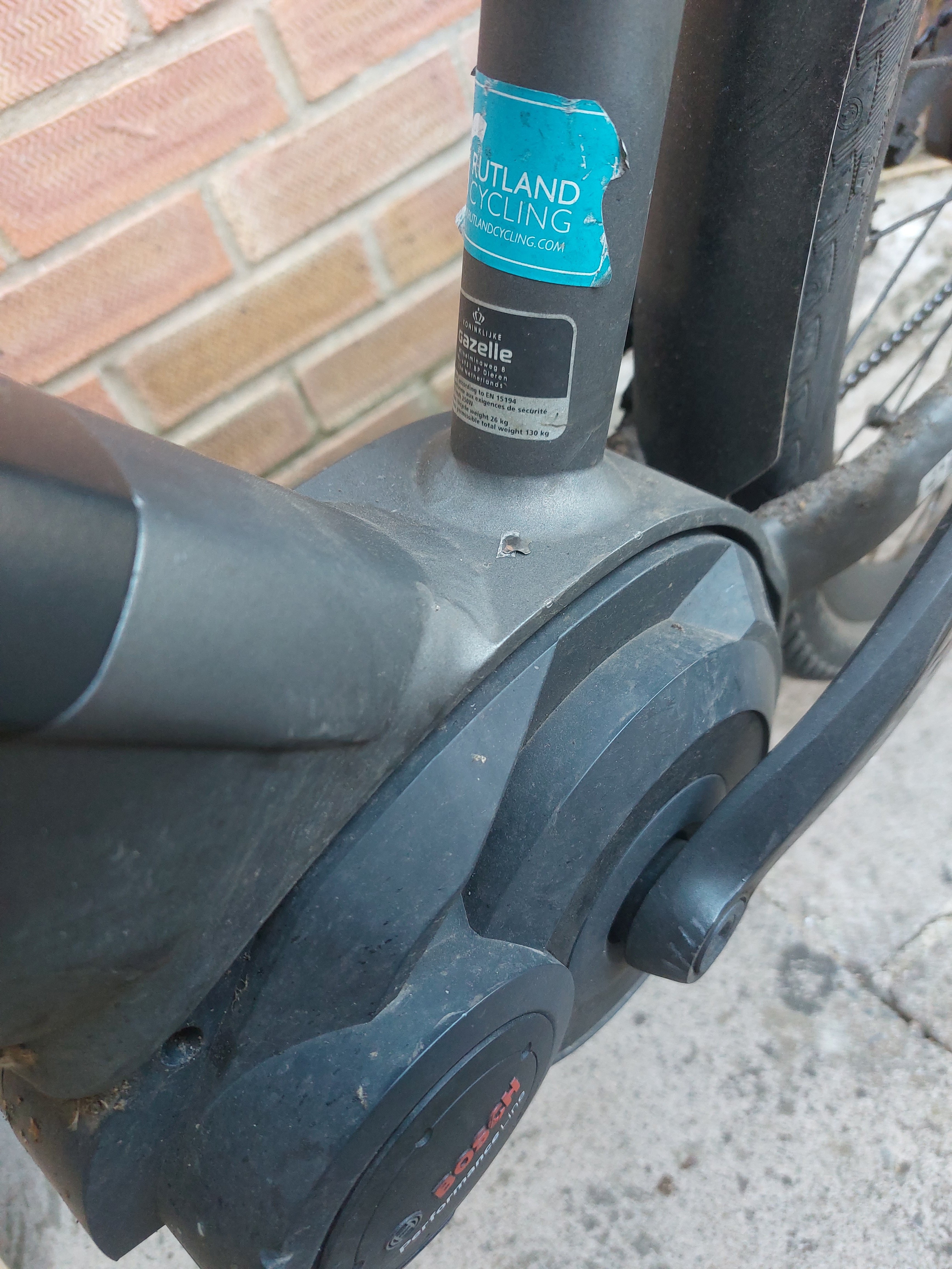

Here is the picture of the little metal piece under the switch of the battery, just in case people are curious how it looks like.
