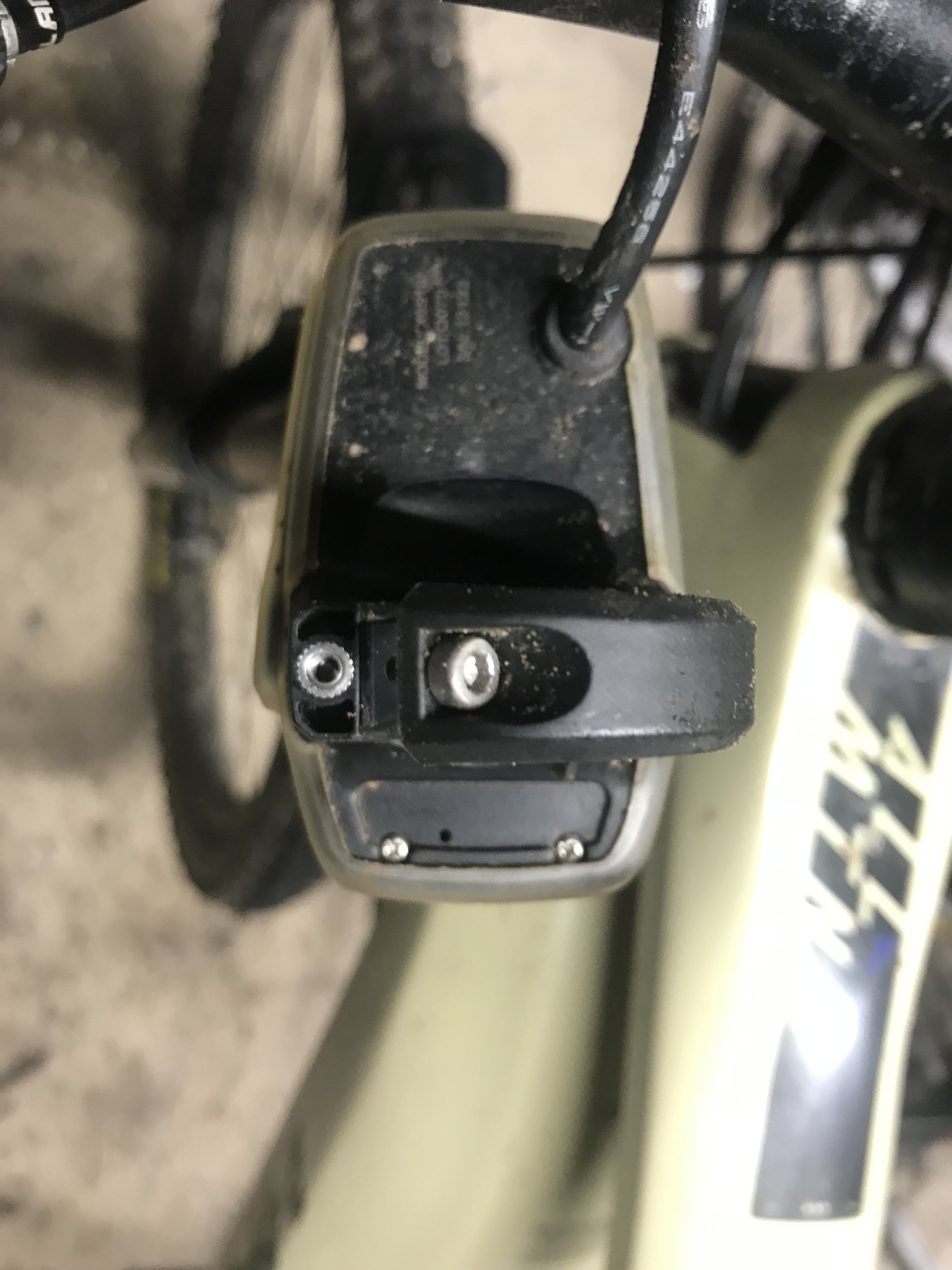

Steve, TQfreak is right about the second battery. No Yamaha display is powered by the main battery as far as I know. Could you take a picture of your controller to see what model you have ? There is a button battery in the back of the display as per TQfreak correctly mentioned.

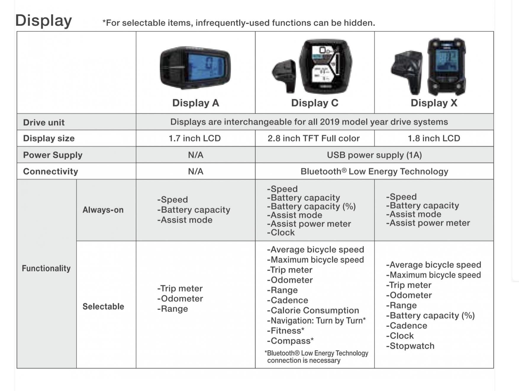

Thanks again. Whilst I am no expert I don't think they are right. I have attached a photo of the back of the Controller, called Display A by Yamaha and also and extract from the tech manual. As far as I can tell there is no battery. Perhaps you have experience of different controllers/displays by Yamaha. IMG_0758.jpeg Screenshot 2023-01-01 at 20.22.15.png

At the bottom of your photo are 2 tiny screws holding what is most likely a cover for a button battery. The only other reason for that cover would be a USB port but according to your text above it does provide the facility of USB charging and usually a USB port would be only cover with a rubber bung.
I assume the tiny screws take the back off the controller/display. No mention of any battery in the tech specs and the display only works when connected to the main battery. Why would it need another battery? I'll stick with the dielectric grease approach. Also I rode the bike for 40 minutes yesterday and it did not cut out. Surely if the button battery (if it exists) would cause problems straight away If I ever take the back off anything it never goes back correctly. .

No...they only allow the small cover plate to be removed. Assuming the controller has its own lithium battery its primary function is to send a voltage signal to the battery to switch on and only then will the screen turn on. For the sake of 30 seconds to remove that plate you will discover if there is a battery in there or not....................in fact there has to be a battery in there...........the only question is whether it is a stand alone battery or a rechargeable battery charged by the main battery once the system is switched on. Your experience of the bike switching off after you have been riding for a while is very unlikely to be any sort of bad contact problem.............that would be far more random in terms of timing. The symptoms you describe is logically more likely to be associated with loss of power due to a battery running below a critical level.

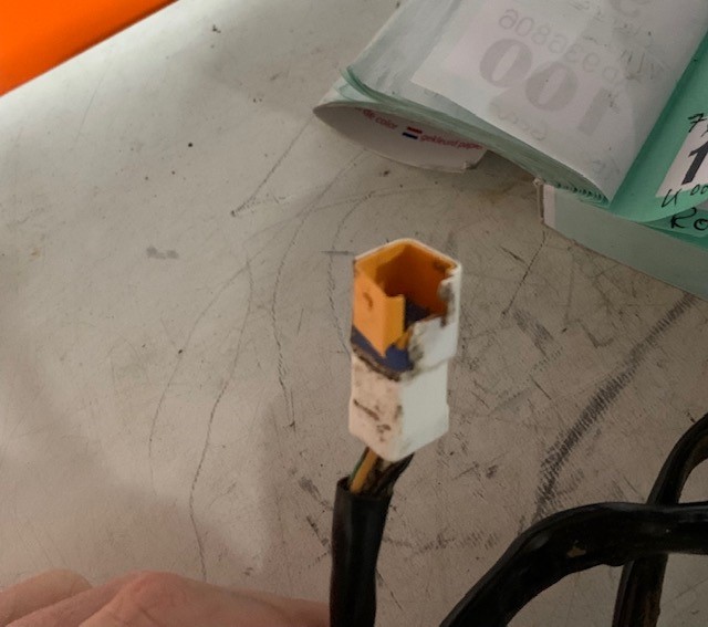

On my Giant Trance with the yamaha motor, one of the connectors (I'm assuming it's for the controller cable) was broken, and the bike had similar symptoms as you (the bike shop had previously replaced the main power cable)
When I put the motor back in, I covered this with liquid electrical tape (but no grease) it was fine for a while, but it's now playing up again.
