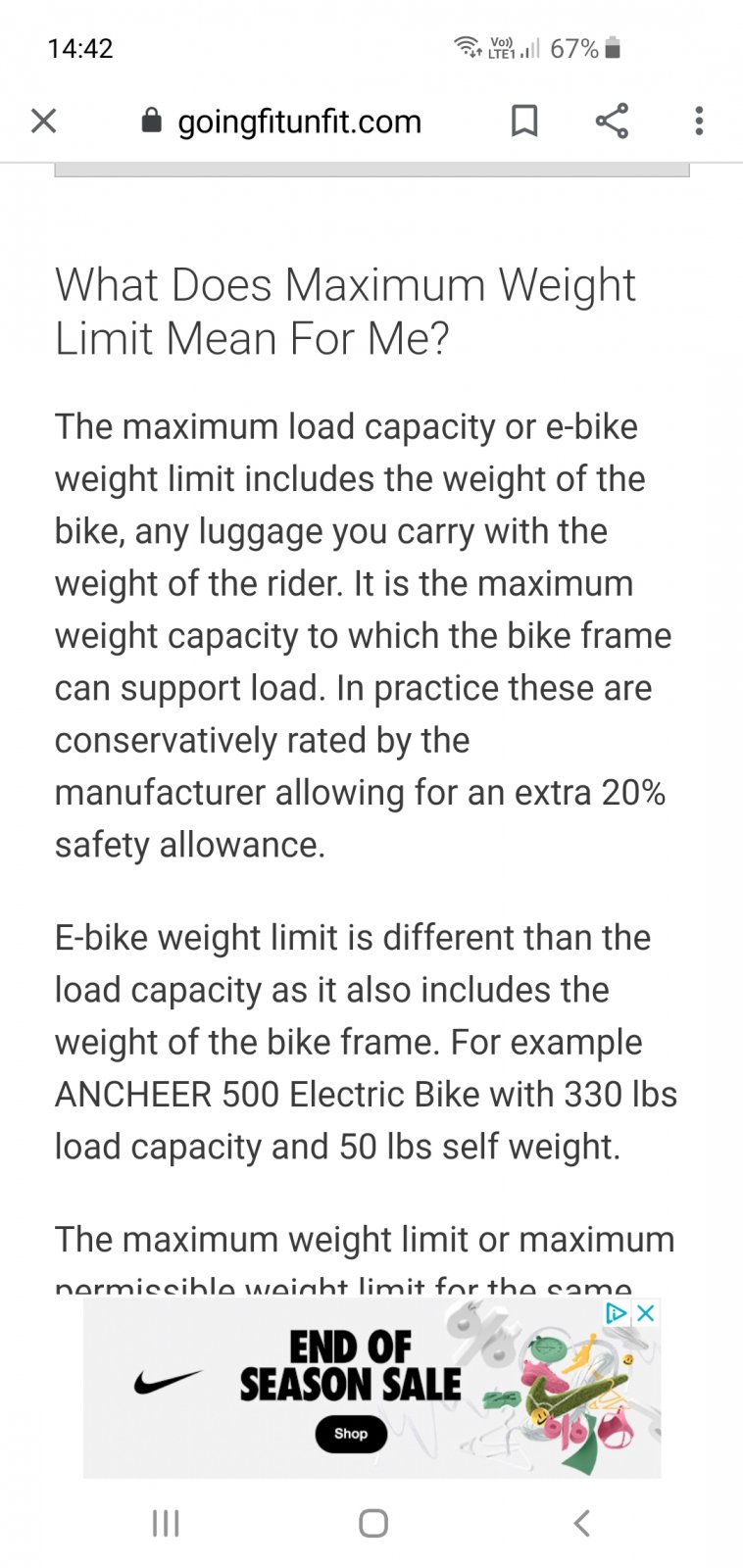

Just read this ..seems that you may have +20% to play with ..?

I'm similar,infact a touch heavier and not so much as a creak out of my cube 160sl....I assume figures given have a decent size/weight tolerance....if not I'm f*****d lol
