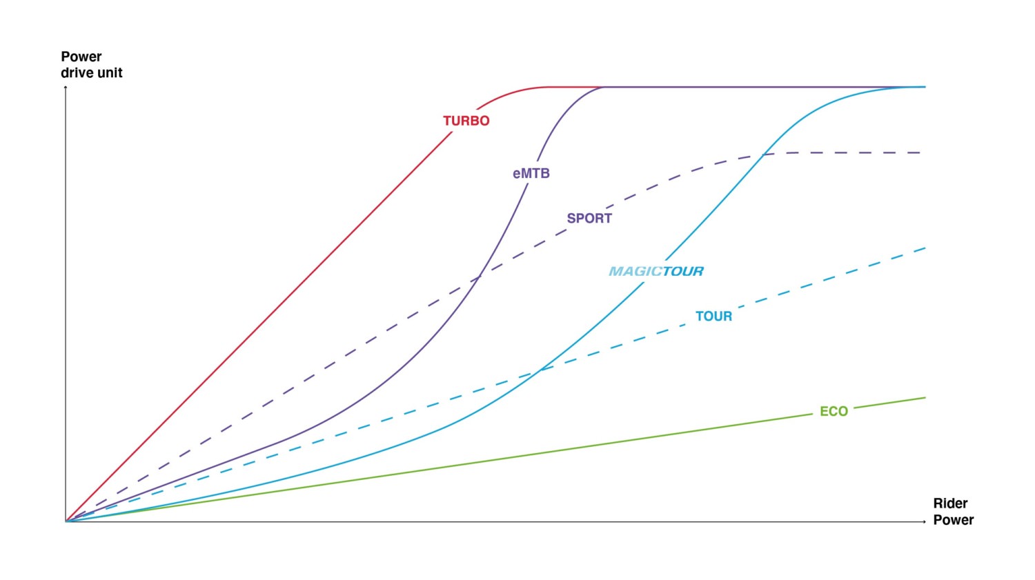

Turbo: 340% Support Level
eMTB: 140-340
Tour+: 60-340
EMTB Lite: 140-250
Eco: 60
EMTB Lite will never allow max motor support, Tour+ will allow maximum motor support, but you'll need to be pushing a lot harder to get it compared to eMTB mode.
New 2022 Treks don't have the eMTB Lite mode so I guess it was an interim solution for Trek.
Tour+ is very likely the Magic Tour setting that was originally installed on Moustache ebikes. According to EMTB-MAG, Magic Tour was due to replace the original Tour mode at some point... So I figure that has in fact now taken place. Here is the curve for Magic Tour / Tour+:

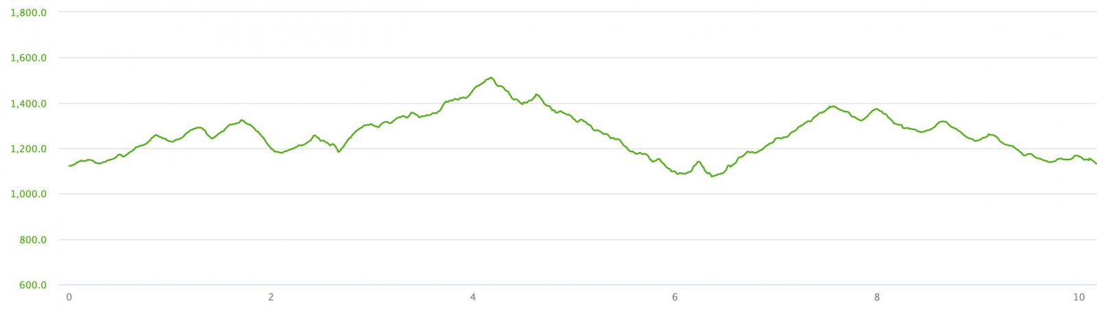

I don't think I'll go back to EMTB Lite - Tour+ is giving me over 35 miles, and 5000ft vertical on rough terrain. This is a typical winter ride (elevation in feet, distance in miles)
