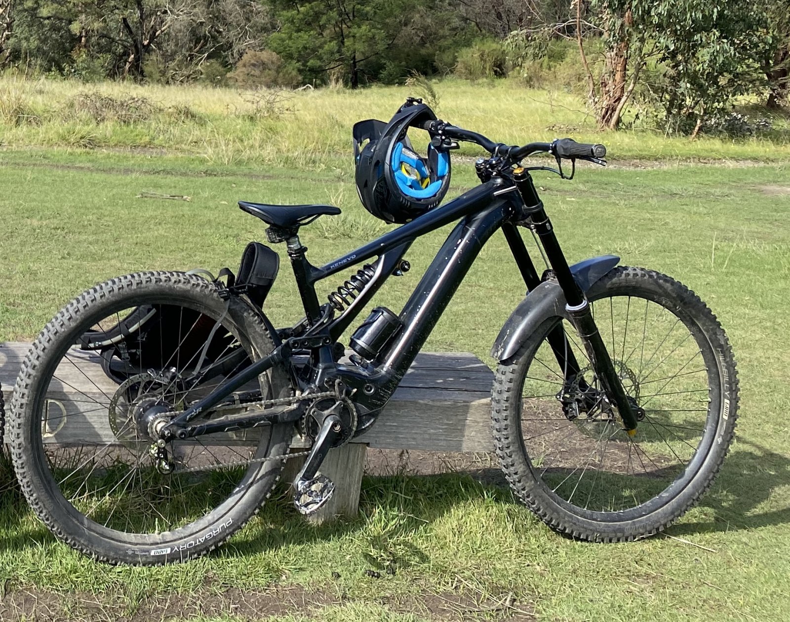

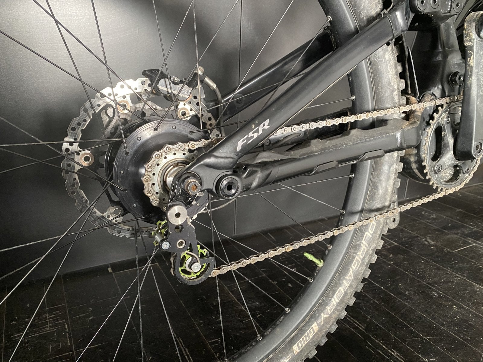

This is Rohloff focused. But for those interested... this is quite a detailed video I have put together explaining about the advantages and disadvantages of the internal geared hubs on eMtbs. The purpose of the video is to try and explain how the Rohloff works, how you change gears and what a Rohloff is really like in a mountain biking (and eMtb'ing) application. Along with some iconic Aussie trails and scenery and feedback from a couple of eMtb'ers who have recently converted over to the geared hub.

How come nikko gets an mx plug and stephen gall doesn't !!!!!
Hey, christian, did you ever try the rohloff in the sl?
Nikko was one of the two riders/owners who converted over to the Rohloff, so I wanted to provide some credibility on who each person was - and one who was a recreational mtber and another (Nikko) who is a very skilled and accomplished rider. Probably didn’t have another time on the video to say who Stephen Gall is/was and what he had accomplished ?. A super legend in Australian motox.

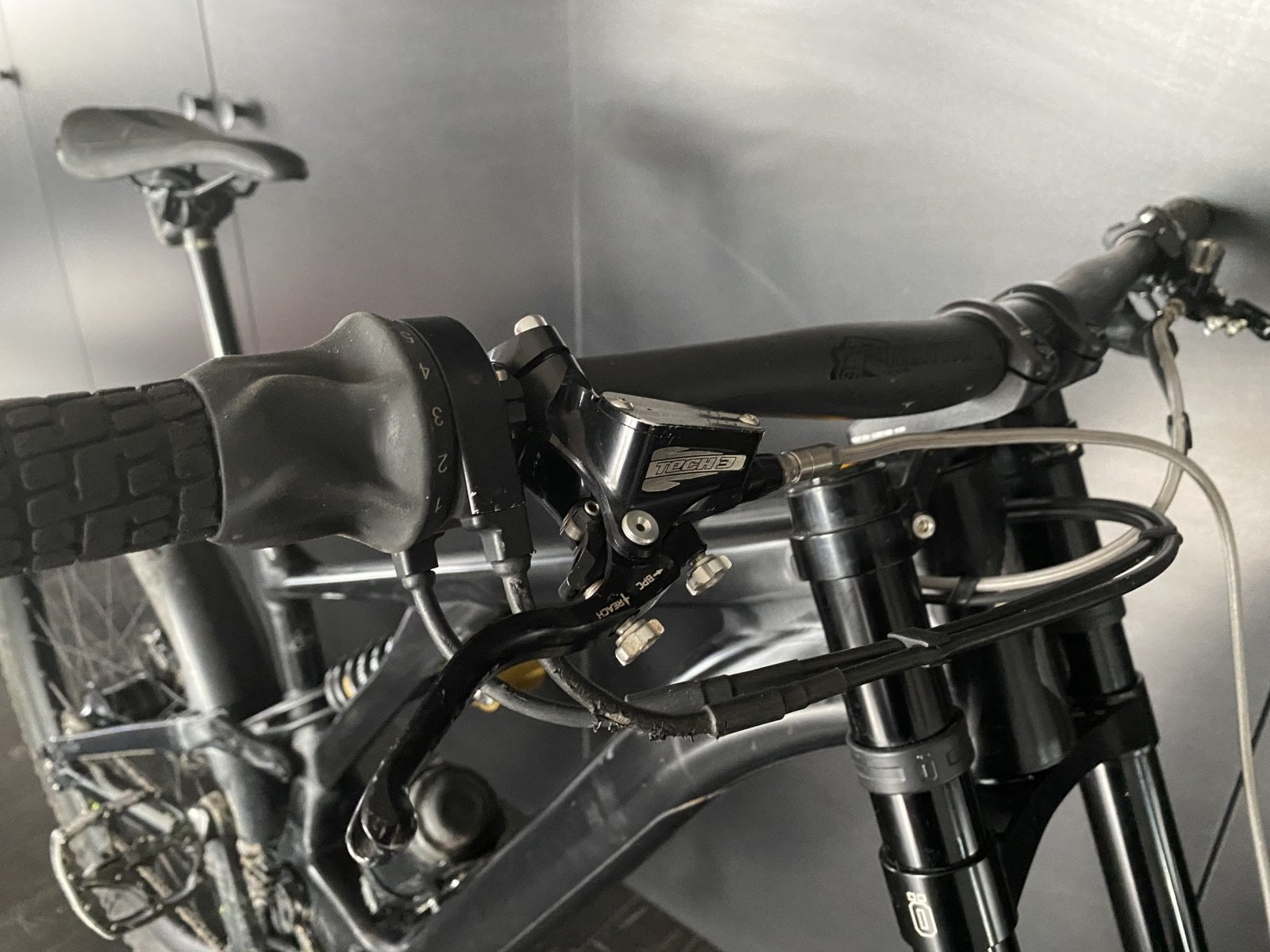

Trigger shifters are available for the Rohloff from third-party suppliers… some prefer them.

So what's the shopping list for one of these on a 148 boost bike?
I've wanted one for 15+ years but confused to what's required, there's so many different models and accessories.
Order a 148mm boost Speedhub and rotor and tensioner if they are needed. Plus determine which axle plate suits best for torque restraint (to stop the hub turning).

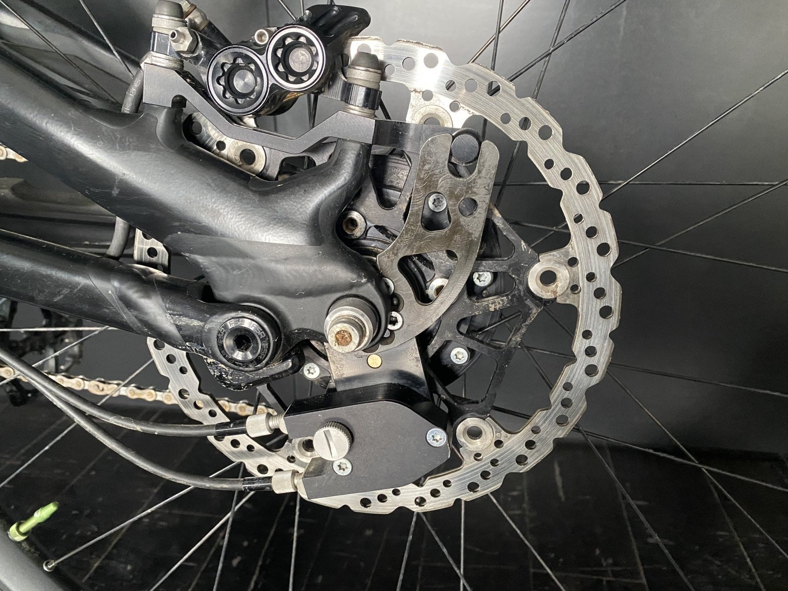

Good luck with that. I’ve tried. They won’t sell you one unless it’s through a bike shop who will assess your bike, carry out various measurements with their test kit and then take responsibility for it.
In addition it’s tricky to find a chainring for the belt drive unless you have Bosch.
(I see little point in converting unless I can go the whole way and include belt drive)
That is only for the A12 (12mm thru-axle) Speedhub version. There’s a special dropout assessment kit with a 44-page manual to determine and then have Rohloff Germany approve the data for that frame (it is not a true thru-axle, therefore custom adaptors are supplied with each frame). You cannot use a belt-drive on the full suspension mtb unless it is a custom, specially designed tensioner system as belt tension is a critical aspect of the Gates belt drive.

Yeah. optimum gearing range and spread is always going to be a hugely personal thing.
Is that a DIY fabricated trigger shifter Paul? If so it's very very impressive work.
I'd love to see the manufacture/design process. Especially the indexing mechanism. How many gears does it allow you to change per full lever push? and how does the lever throw compare to the likes of a shimano or sram shifter?
