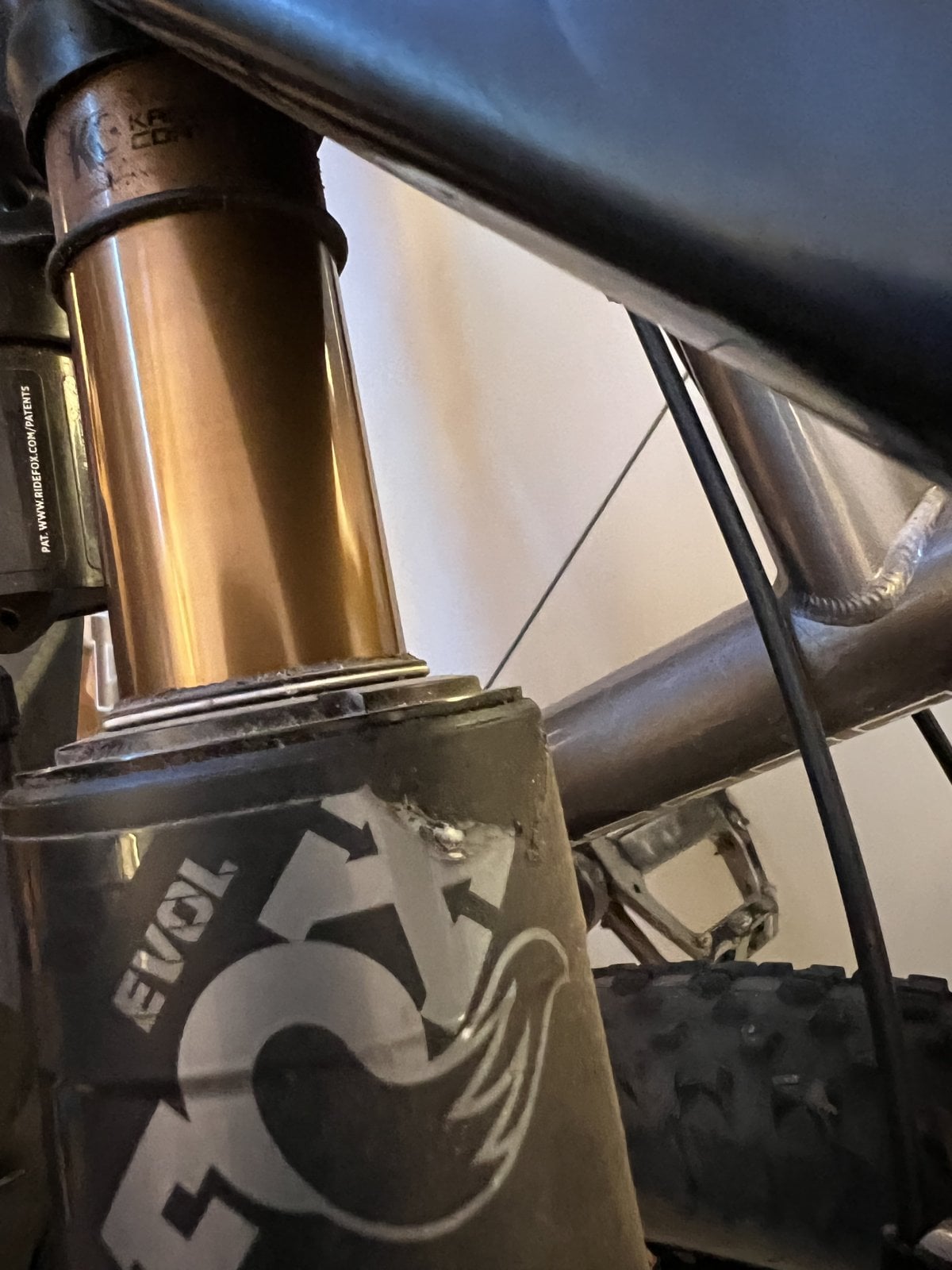

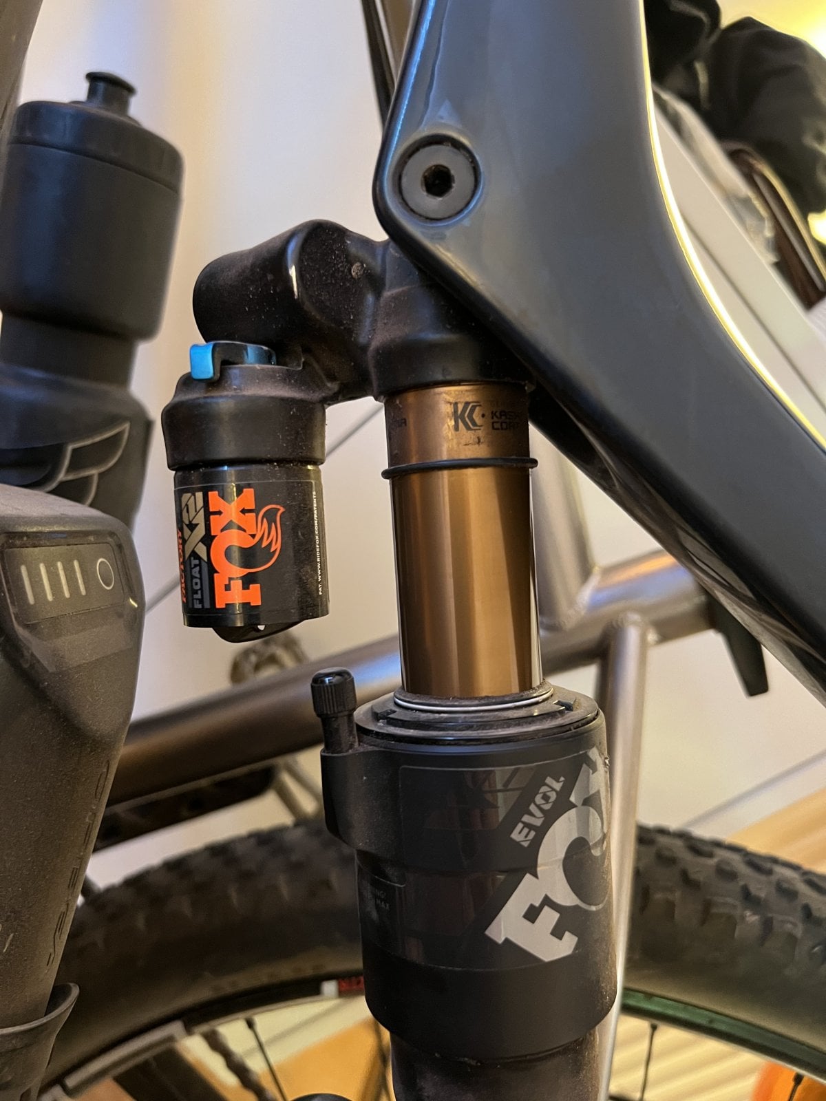

I was stupid enough to buy a brand new X2 to fit to my XL Rise hoping that there would be more room, but there isn’t. Same as the report on the medium, as the can passes under the top tube it just scrapes past, taking the sticker off the can. There is more room for water bottles and range extenders, they fit fine. Having scratched the can I can’t return it so I’m going to run it like this with close monitoring. The contact doesn’t get worse once you are past the brush point, so compressing further under a hard impact should not make it worse in theory. I’m a light old man rider in any case, so no big drops or jumps. Will report back if I die ;).
Are you using the stock 210x55mm size or 213x60 with offset bushings. Can you post some pics please?.

I meant 216x63mm with offset bushings.
It’s the 8.5” x 2.5” which I believe is the same thing. I have the bushings but not fitted them yet. As it stands I’m happy with it as I never get near the full compression mark with my style of riding. Pic shows the sticker rub when compressed fully by hand with no air in, so to answer the question is it any better in an XL frame, the answer is no and I don’t recommend it at all, unless you are a tame rider with it set up to never reach full compression I guess, which for a lot of people will kind of negate having the larger shock in the first place. I got to say though it’s a lovely plush shock in comparison, very happy.

Or thinking further, modify the can to clear. Basically grind a bit off. How thick is the can though? Anyone know?
I suppose in the interests of saving weight…. Not very thick at all. And it’s still got to hold the pressure ramp up
Feb 6, 2023
133
47
Uk
appears there is no fixed orientation either going purely by the pic
