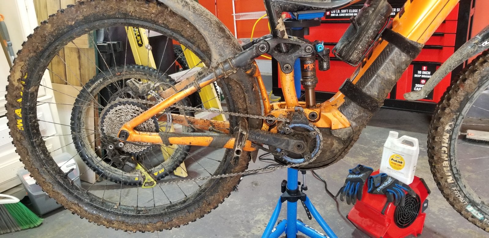

The Connex stainless SE chains are legitimate. Super expensive, yes, but legitimately durable too.
I found an open box Connex-11Se for about 1/2 price on eBay, and could not resist to buy-it-now. The chain came without the connex link ?.
The chain, I believe, will live longer than the cassette I paired it with. I may have to replace the cassette if I want to see this chain worn past 5%. It even made it through a Kentucky winter mud fest.
Would I pay $80 for it... nope. I'd buy 3 or 4 mortal chains, and rotate them in and out.

Ha ha looking through your back wheel at the perfectly centred wheel behind in that pic , took me a moment to work out what it was , though you had some special top secret gadget on the rear wheel ? maybe Iam just going nuts ?
DrStupid
Jul 10, 2019
1,464
2,128
Pleasureville Ky
It is top secret. You are nuts.
Seriously, the garage is chaos. My phone captured a bit of it.
