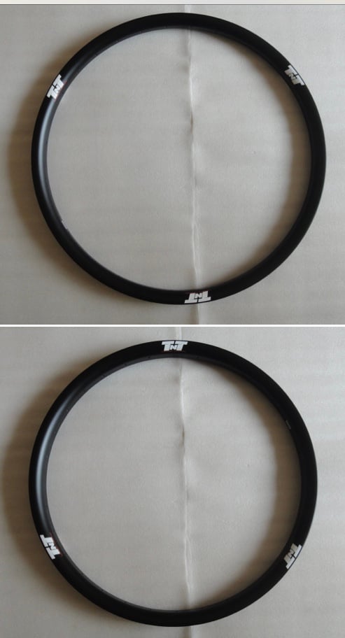

After destroying every wheel on the market, i set out to build my own.
Since i have become partial to a mixer i struggled to find a good strong matching hoops front to rear.
After a year of design, countless hours of 3D cad analysis and 6 months bashing with no inserts i finally came up with a carbon hoop that will survive on my 54lbs Enduro ebike on some of the chunkiest trails you can find.
These are wide to give the heavy ebike and heavy riders the side wall support with plus size tires.
Front is 29x38 internal and rear is 27.5x 42 internal.
After months of everything from 32 to 50 internal widths i found this combo to be the best all around combo.
There not light by carbon standard at almost 600g and 550g but they take a beating for those aggressive enduro riders.
