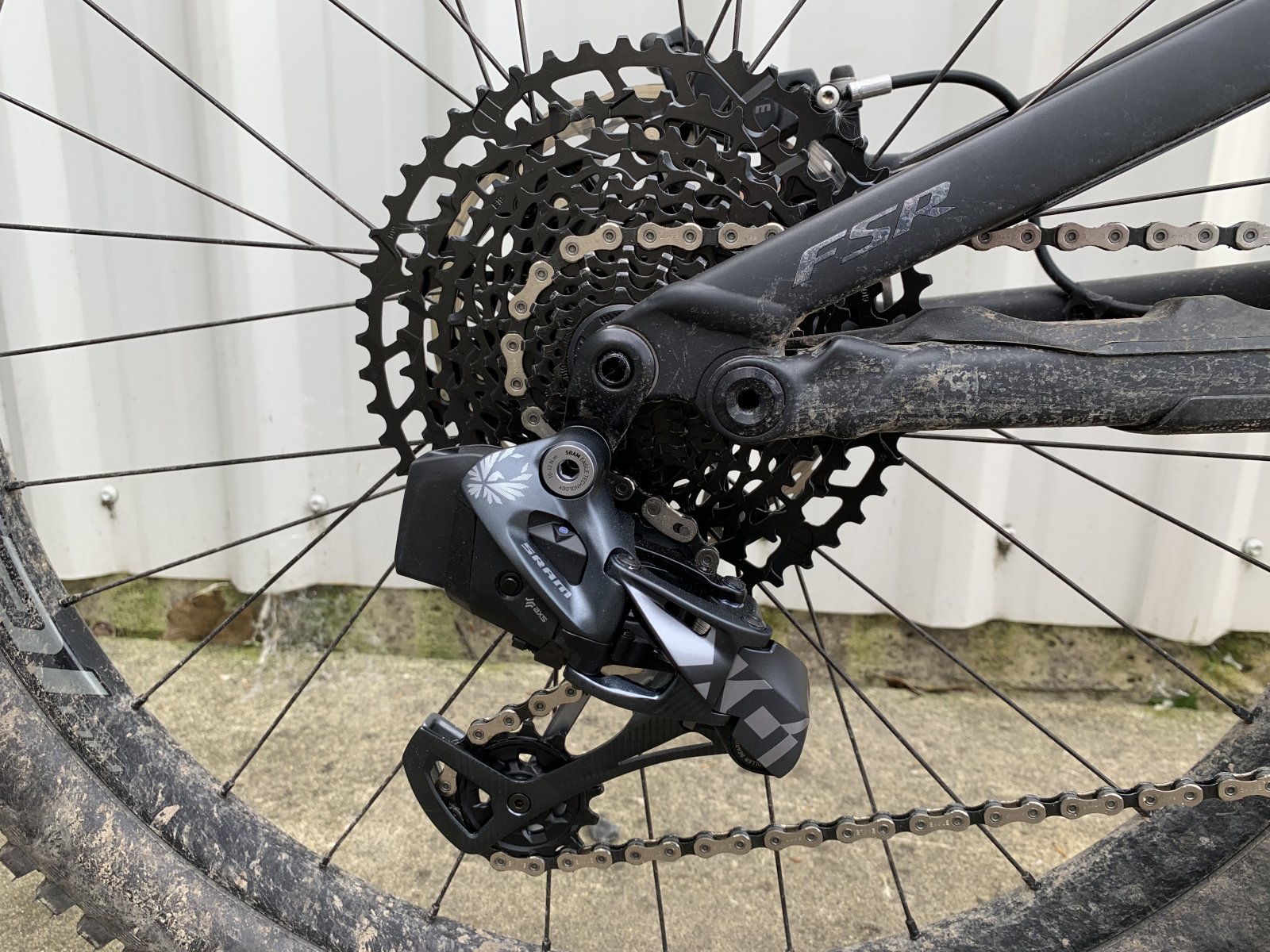

AXS has been flawless on my Levo so far. The shifting is precise and consistent. I try to always pre- shift before a hill so I don’t shift under load. You will really enjoy it. View attachment 30651

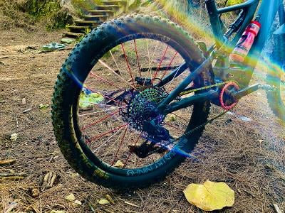

Agreed i just updated with a 36T with Eagle AXS, alot more range use of cassette now
