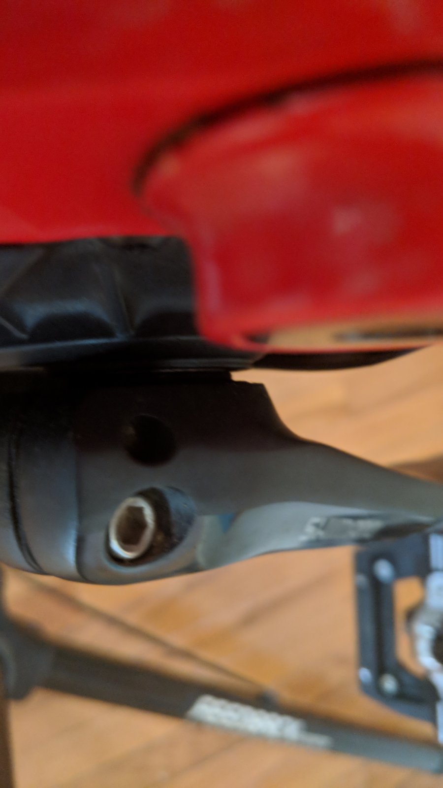

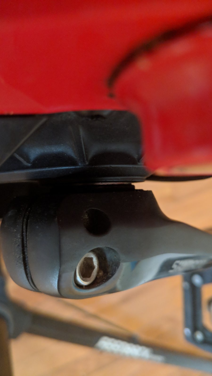

I checked my bike and I noticed some play in the "bottom bracket" bearing on the drive side. I contacted Commencal they said I am the first one with this problem and asked me to make a video and send it to them. The bike has 1420km and I find it early to have this problem but I saw a post on a German forum with the same issue after 1500km.
Anybody here had this problem?

is it definitely the bottom bracket and not the chainring lock ring or crank arms?
Unfortunately, it is 100% bottom bracket. Everything is torqued down properly and the play is in the bearing. I see it, feel it, hear it... Tomorrow I will make the video and I will link it here.

So here is the “progress report”.
Commencal customer service is very responsive and helpful. They contacted and sent my video to Shimano which responded saying this is a “functional play”. It is a complete BS but Commencal said don’t worry just ride the bike because we have the emails showing that I reported the issue in time and they will take care about it if it will be worse.

Unexpected update on my issue.
After the Shimano representative, Paul Lange Hungary's customer service person pretty much told me to "f*ck off" their QC manager sent me an email asking for details. I sent him the video and some pictures and we had a conversation to make sure it isn't a loose bolt or missing spacer. The guy was very helpful and now I received an email from him saying that he ordered a new motor and mine will be replaced when it arrives. Sounds good to me, see how it goes...
During our email conversation, I thanked him for his helpfulness and told him that I expected the same attitude at first but it's better late than never... :)
