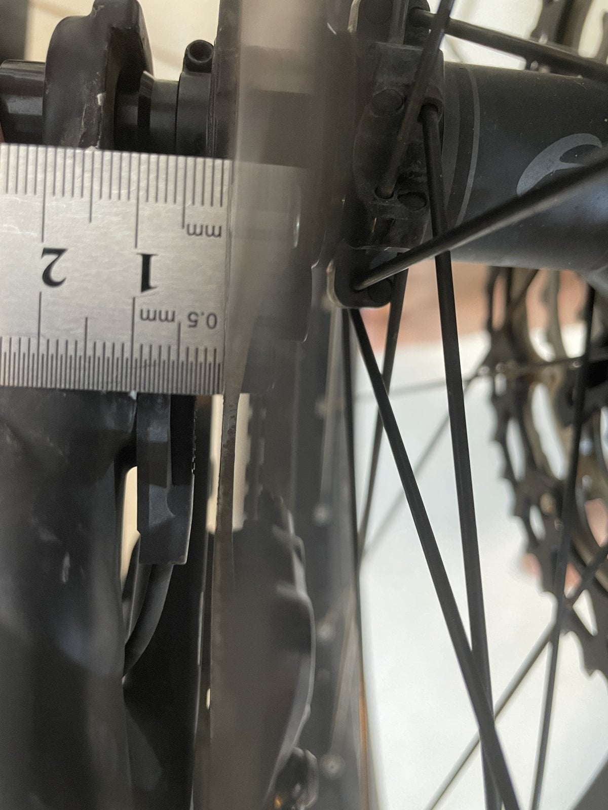

Same question:
What bike model did you fit the Comencal magnet on? What rotor do you use?
I ride a 2020 e160, and it looks like there are 2-3 mm of clearance between the Center Lock sensor and the rotor. I’m concerned the protruding magnet won’t have enough clearance.
Thanks

Same question:
Thanks

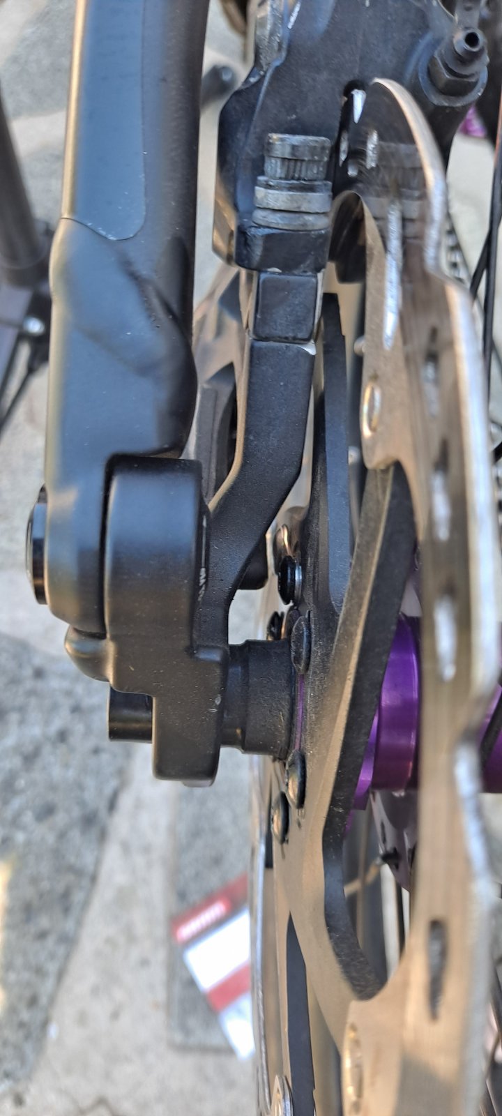

I've just recieved the Commencal one (bit of a postal mix up so it's taken an age to receive) so I was using a bosch one for last few weeks. Zero issues with that from a usage perspective, didn't think to look at clearance but no rubbing noises from anywhere. Shimano one I now have from Commencal does look a bit of a flatter profile though so will try that out. Bikes a 2021 e160 8000. I'll try to take a photo with the Shimano one fitted later.
D3xt3rMTB
Mar 16, 2021
146
102
Plenty of space with the shimano magnet fitted. Spec is 2021 e160 8000 with Hope Fortus 30 wheels and Shimano RT86 IceTech 6 bolt rotors.
