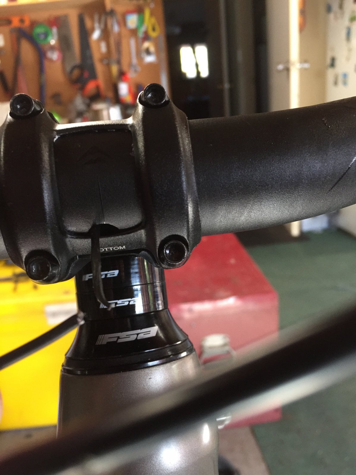

So my day started out great, sunny, no wind, and plenty of time to have a day riding? well so I thought. I did manage to have a little ride about 20km into the bush and then it happened just as I landed of the second jump. It was like as if someone reached down and turned off my bike. It had me a little puzzled at first trying to turn it back on with no success. And then I notice a Black wire dangling down from the centre of the handlebars and on further examination I’ve noticed that the handlebars had spun just enough for the clamp to cut the wire clean in half. It’s as if the hole in the centre of my handlebars has been put in the wrong place. Anyway my problem now is that I have soldered The two little wires back together and put on a peace of heat shrink, hopping that was all that would be required. But I cannot get it to turn back on ? No Power whatsoever to the little display screen on the handlebars but I can turn the battery on when it is taken out of the bike so I’m wondering is it the little display screen that is stuffed and do I need to take it to the bike shop to get it plugged in to the computer and update or re-calibrated if I get a new screen ?

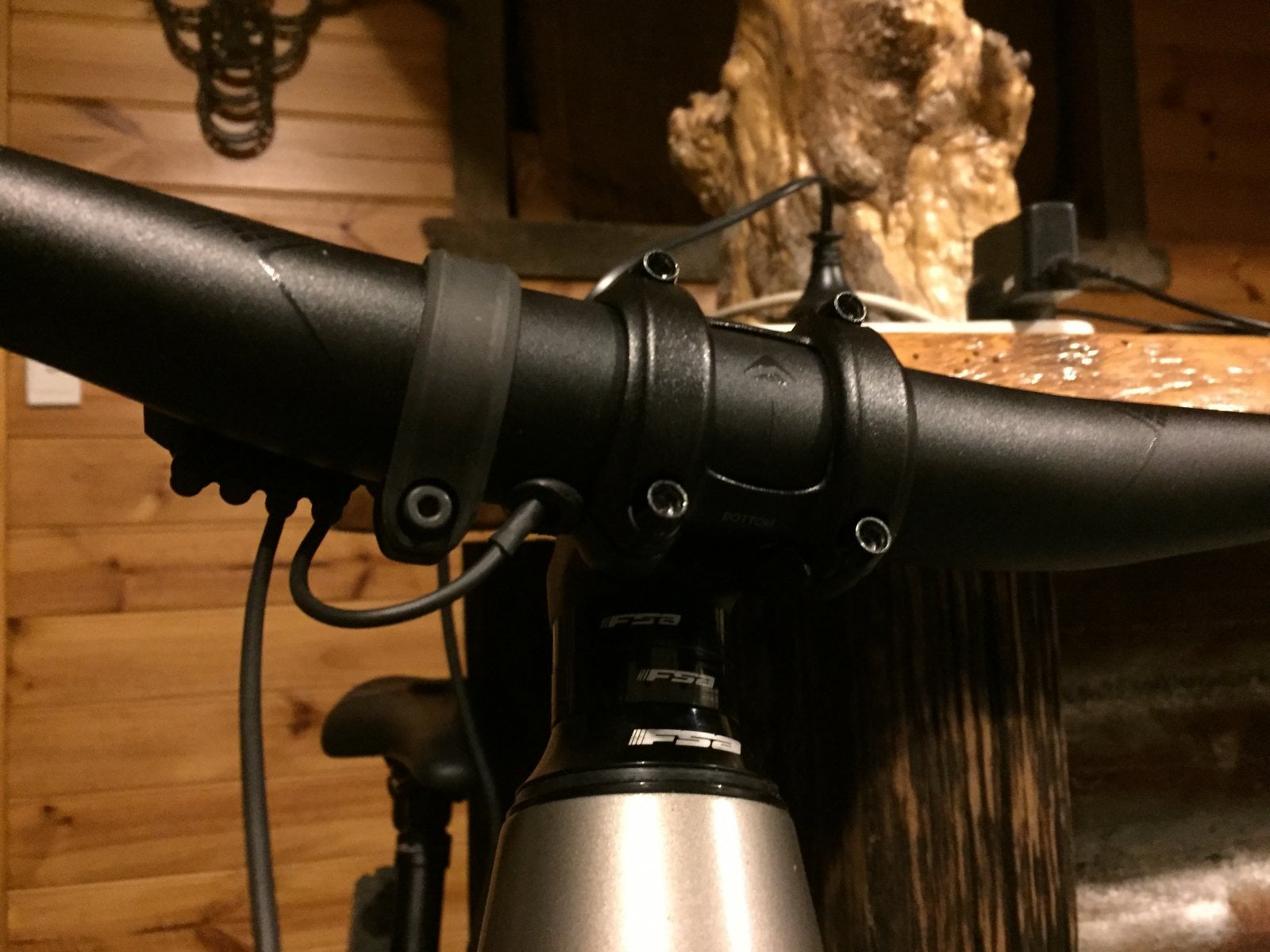

Mine was just like yours, the hole for the cables is poorly placed and if you rotate the bars to where they're comfortable then the hole is half cut off. I did one ride and then threw them in the bin and ran my cables externally with a set of Deity bars.

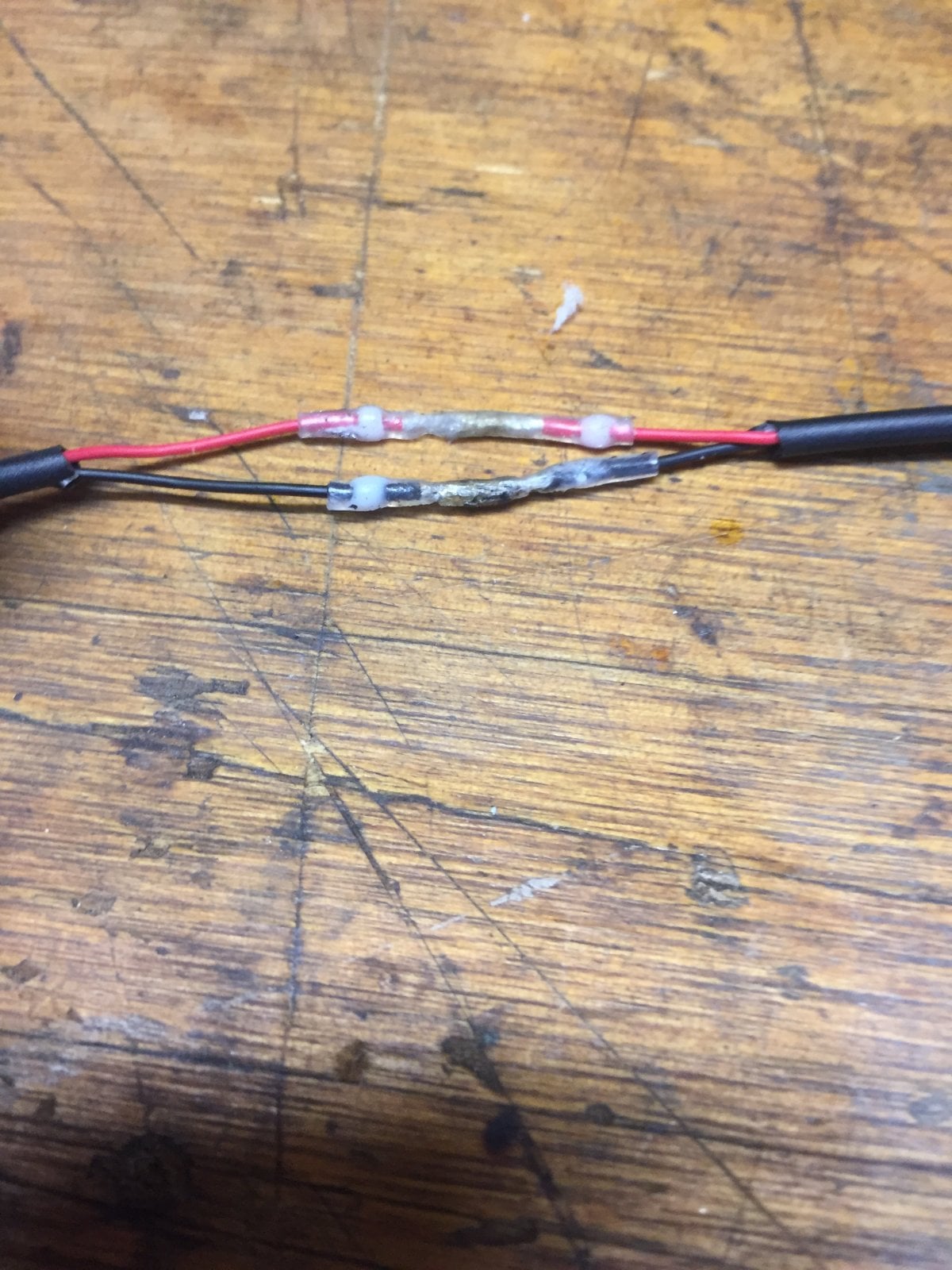

Had a bit of success with the cable today I managed to get a good join using these new little solder heat shirk joiners.. my new cable should be turning up Friday but at lest I have my baby going again until then ??
14,019
20,786
Good job, it is a freekin tiny cable to do any work on. You get the Surgery gold star of the week.
