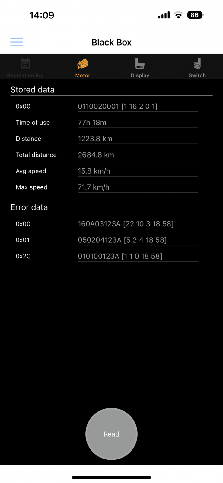

Hi I am new here - however, I decided to join " EMTBForums" to share my experiences....
My "little duck" refused to serve me after washing.
the screen was stuck on the message "shimano steps" and I could not do anything to start the bike system.
I cleaned and dried the contacts - no effect,
I connected the bike to the shimano system to view the stored errors.... all were E02000 "communication error between battery and drive unit"
I started looking for the cause of the error in the electrical harness....
current conduction was okay, while I detected anomalies on one of the communication cables in the form of increased resistance....
I pulled the cover off the electrical harness and found that the black cable had melted the cover slightly.... which affected the communication wire.... The lack of communication between the battery and the engine turned out to be true.
to check, I connected with the help of other cables the drive unit with the battery - system works....
I am currently waiting for a new electrical harness from YT :D
be vigilant and check the recorded errors of the system
