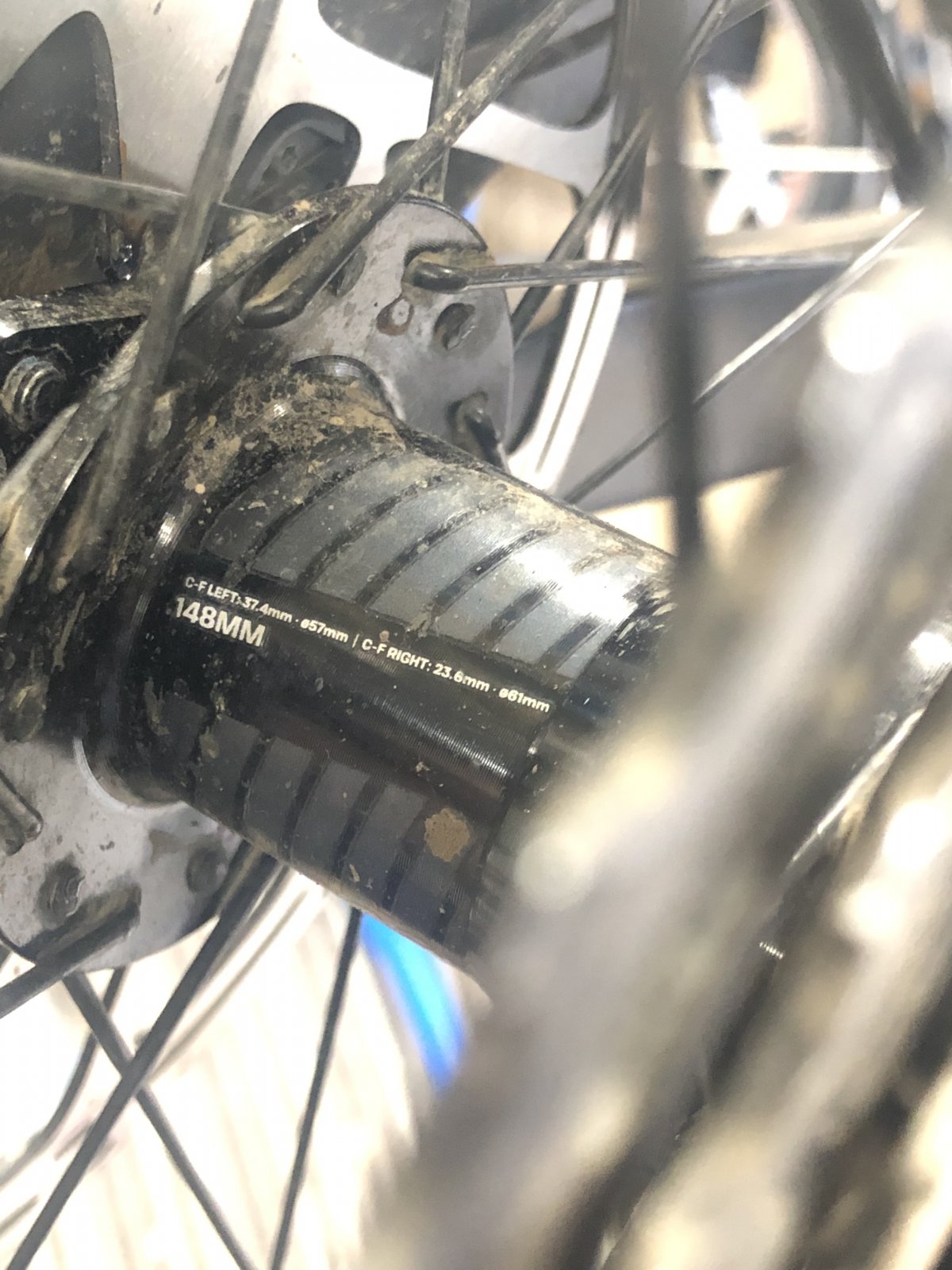

Rear bearings are worn and rumbling with a little play, so I will be swapping them out. But…..knocking them out isn’t straight forward! Anyone ever done it? What did you use to push the axle through? Which way did you go?
It’s the V40 as in the pics and fitted to a 2020 Pro Race. 26L denotes the week and year of manufacture. Not sure what FC means.
Bearings are 6804, I have all the gear for pushing bearings in and out. But the axle ‘sleeve’ looks like it needs a little know-how before it gets touched with some tools.

It usually becomes more obvious if you study the set up on both sides of the hub with the cassette/freehub removed and the whell out of the bike. Post some pics

yeah that’s what I was hoping for too! Both bearings are clearly visible as is the axle that runs between them. There’s nothing else to see, it’s all flush in there. A gentle tap on the shaft gave nothing away in either direction. It turns with the bearings and is only properly stuck to the brake/non-drive side inner bearing.
Hence a tiny bit of know-how can save me a world of trouble. They are all repacked with grease and grumbly with a little play, so it’s not an emergency.
I’ll post pics as soon as I set about it proper with the new bearings, just need that heads up of which way to go with removal.

Having a spacer between the bearings is pretty normal. All hubs have their own bearing press tools but since any bearing you remove is going to be scrap you need not be concerned with damaging it and the easiest way to remove them is to drift them out. Where there is a spacer between the bearings it needs to be pushed to one side a little to let a drift get access to the bearing race to tap it out ( same for example on the shimano HG freehub when you have to replace bearings on that). From what I can see the non drive side bearing can be tapped in and the drive side bearing pulled into place with the axle..................you have to improvise!! Some threaded bar and a selection of thick washers to act as drifts is a cheap solution in most circumstances.Using the inner race to drift out bearings is fine, obviously when pressing in new bearings you want to do so against the outer race.
