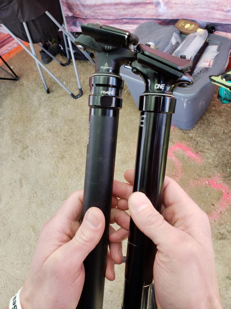

A 150mm OneUp dropper is probably worth a look, the saddle clamping system sits the saddle lower than on other droppers, so would probably deal with the 1cm. You can also customise the exact height of drop on a One, so could set it to 148cm for example.

Thanks for your suggestion. That looks like good solution. I'll probably get one if I can't find cheaper way to fix the problem.

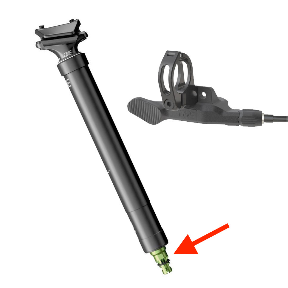

Yes the actuator is the green portion below the post
And yes outer cable = cable casing

9,190
This part, it sticks out a fair bit off the bottom of the post and isn't included in their dimensions - however in the second picture you can see how the stack height of the clamp is lower than most posts, and how the saddle clamp sits lower too.

The actuator base on the one up moves up and down, which means the outer cable also move a bit when you use it.
Ok, I think I understand now how it works. Cable end is fixed in seatpost and housing moves when you push the lever. This might be problem with E-Sommet as there's not much room for cable housing to move. Specially if it's ziptied to the frame.
9,190
It works fine in the E-Sommett - its just the insertion measurements One Up give dont take this into account

"the outer cable moves instead being fixed like every other actuator".
on pretty much every mechaincal cable actuated dropper post the outer cable sits in a cable stop and the inner cable pulls an actuation lever.
on the OneUp post the inner cable is fixed and the outer cable sits in a moving actuation "button" (sort of more like a mechanical piston design than a lever) that opens the mechanism. Becase of this the outer cable needs space to move freely.
Google it if you don't get what i'm explaining. There's bound to be a video/pic somewhere explaining it better.

Do what I did, you can buy the one up dropper post seat bracket which will lower your seat 15mm, it fits no problem on the Brand X .
